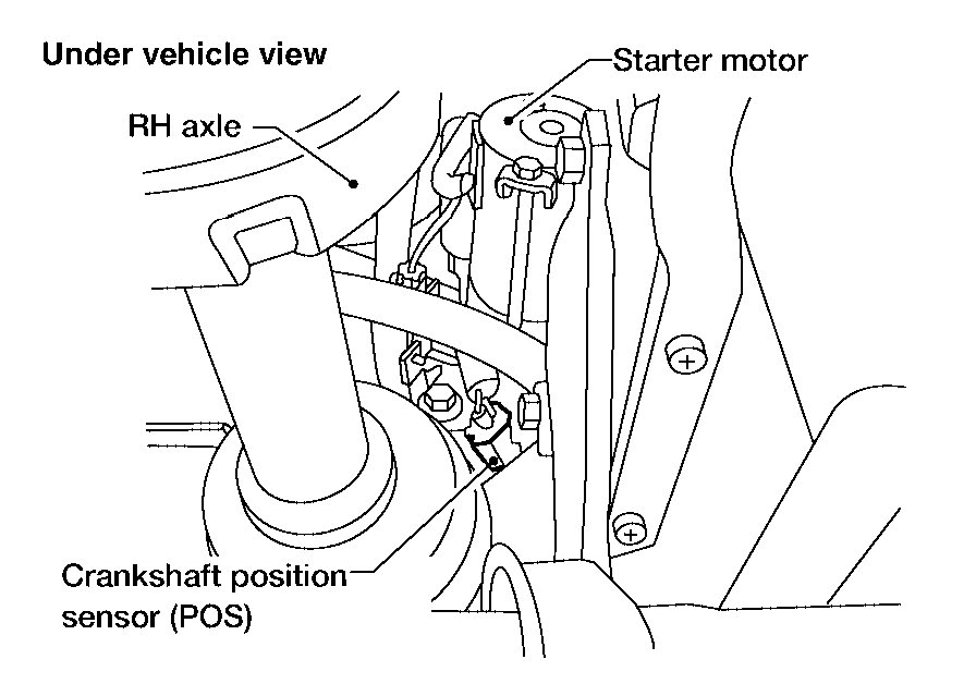

I attached a picture below that shows where the crankshaft position sensor is on this vehicle if you want to inspect it.
