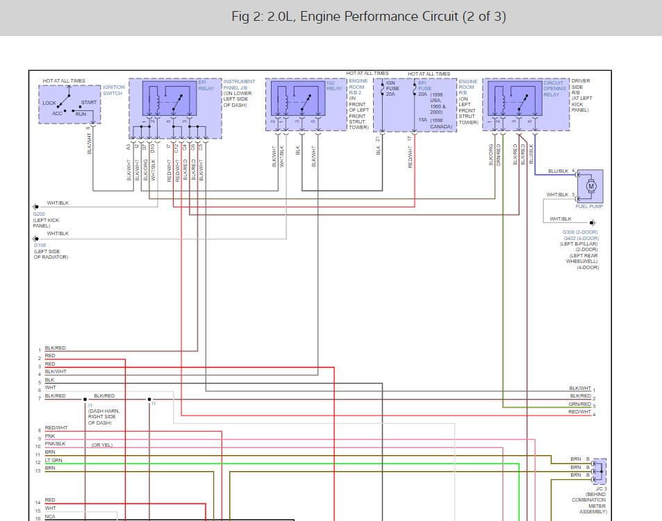

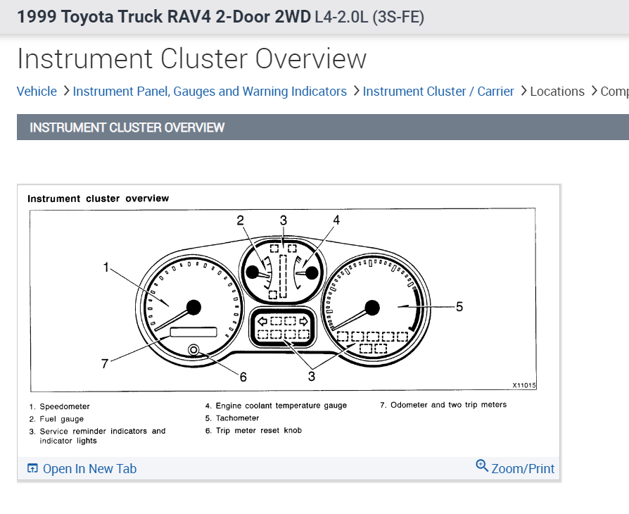

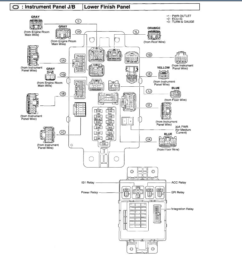

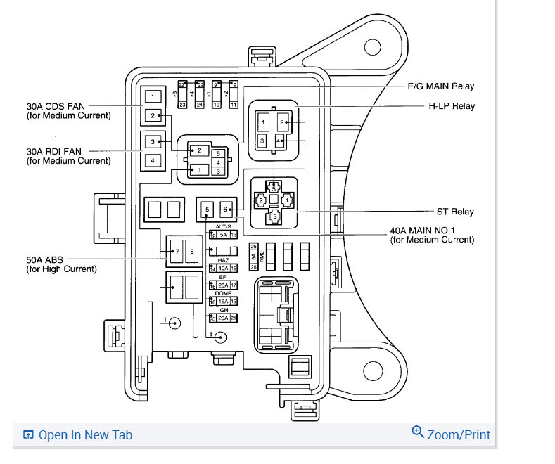

Normally when the key is turned the Check Engine light comes on and when the car starts, the Check Engine light turns off. But a week ago I couldn't get the car to start and noticed the Check Engine light wasn't coming on beforehand either. I've tested the fuses, and all are good. (Relays seem fine too)
Heavy rusting above the windscreen allowed rainwater in and it soaked the fuses and relays. (Cluster below steering wheel) I dried it all, but the issue remains. might not have anything to do with that cluster getting wet but the problem began around the same time though. So, I'm stuck!!!
I would greatly appreciate any suggestions and assistance.
