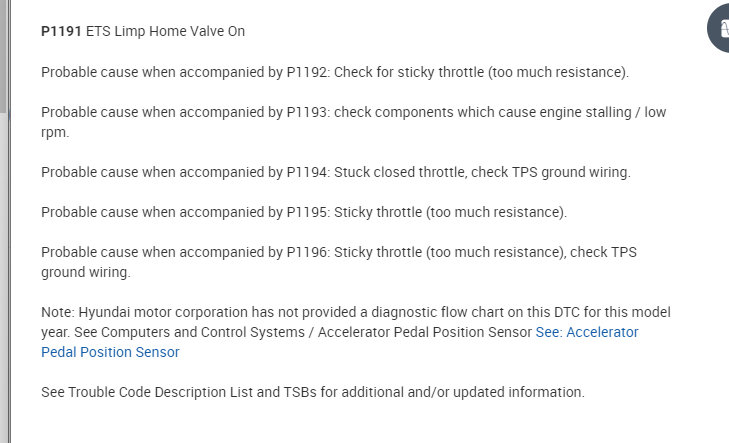

1. Codes
P0320 - Ignition/distributor engine speed circuit fault.
P1191 - Limp home valve system fault.
P1193 - Limp home valve on low rpm.
However, I had these codes for almost a year now and the car ran without any problem. So, I am not sure if these have got to do with the current issue.
