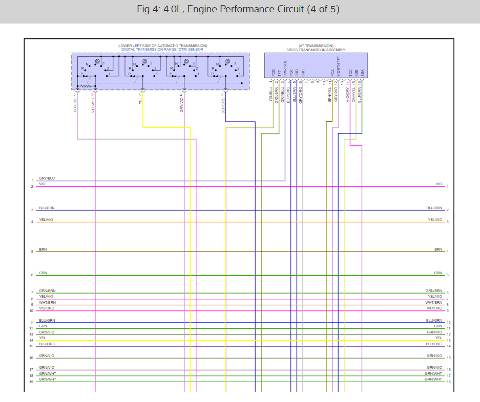

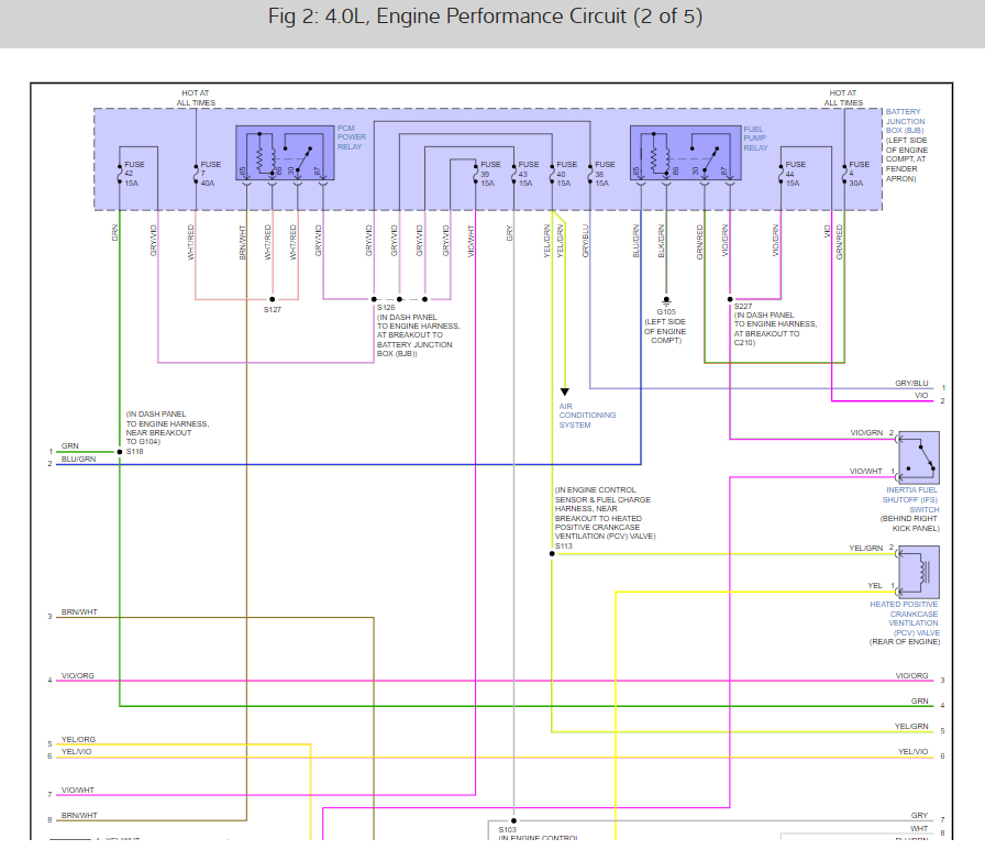

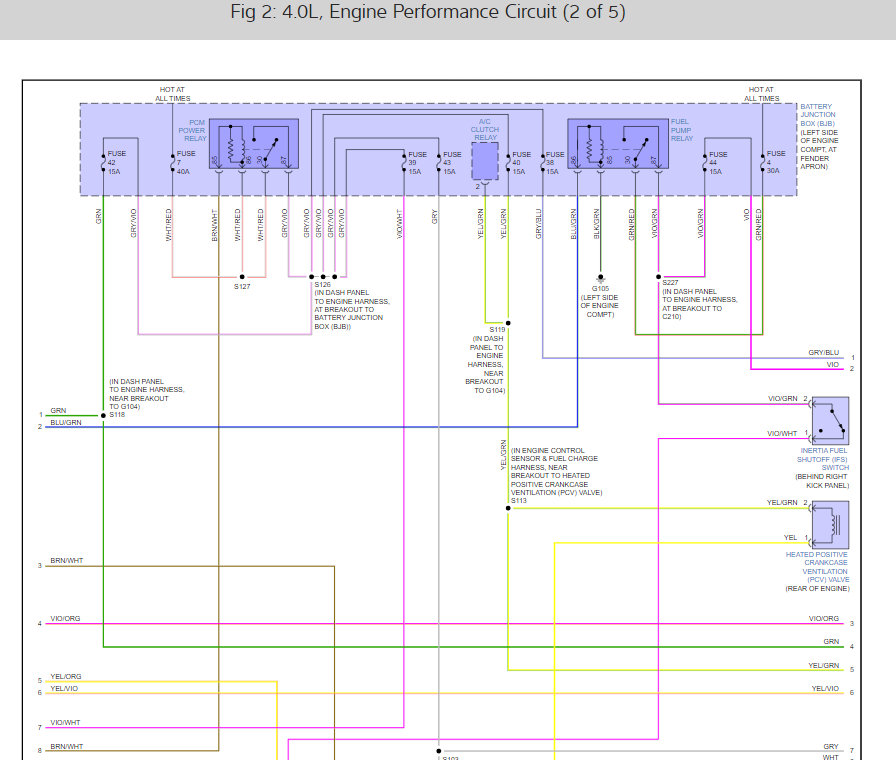

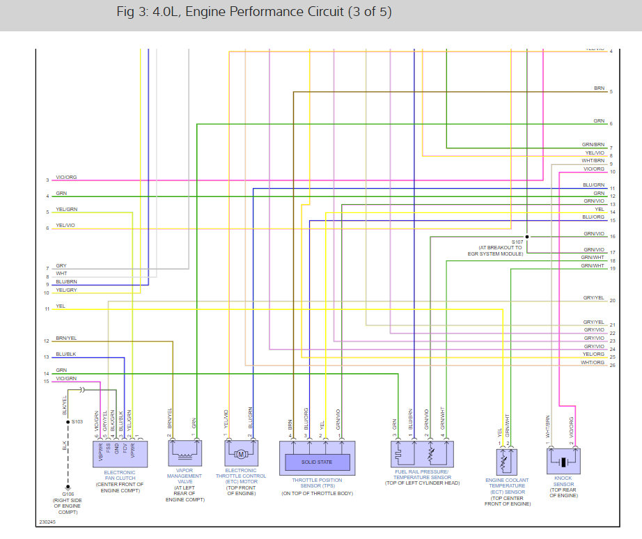

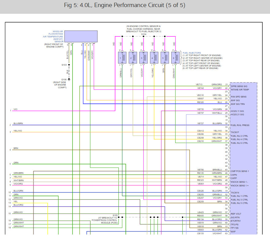

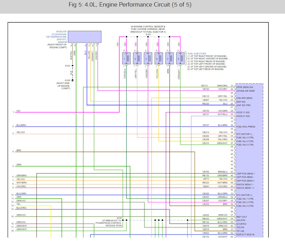

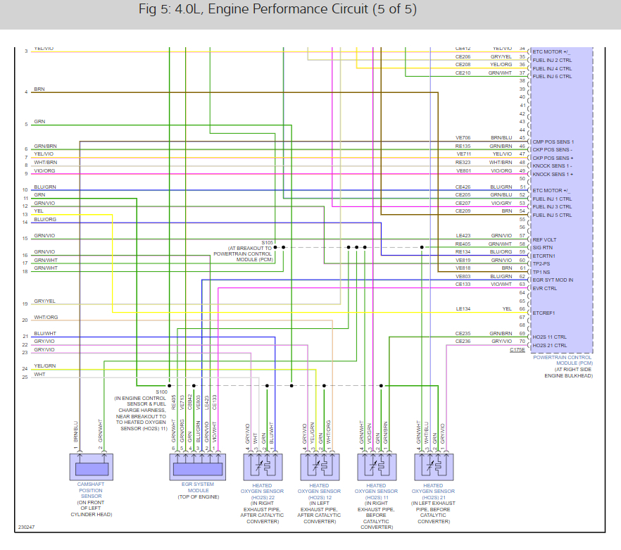

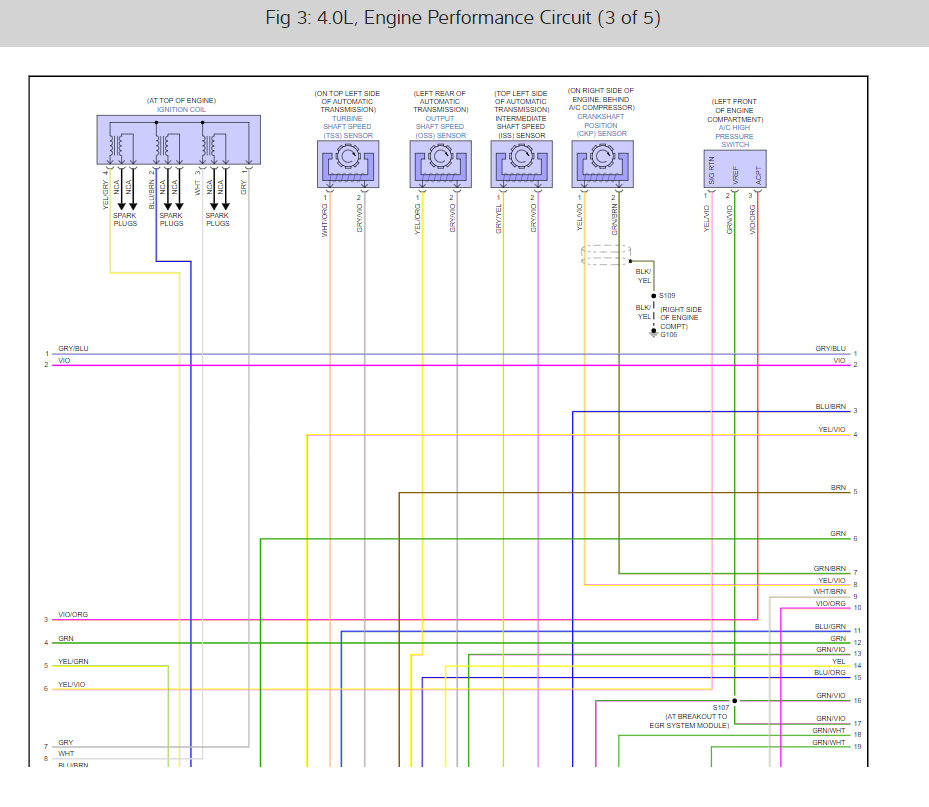

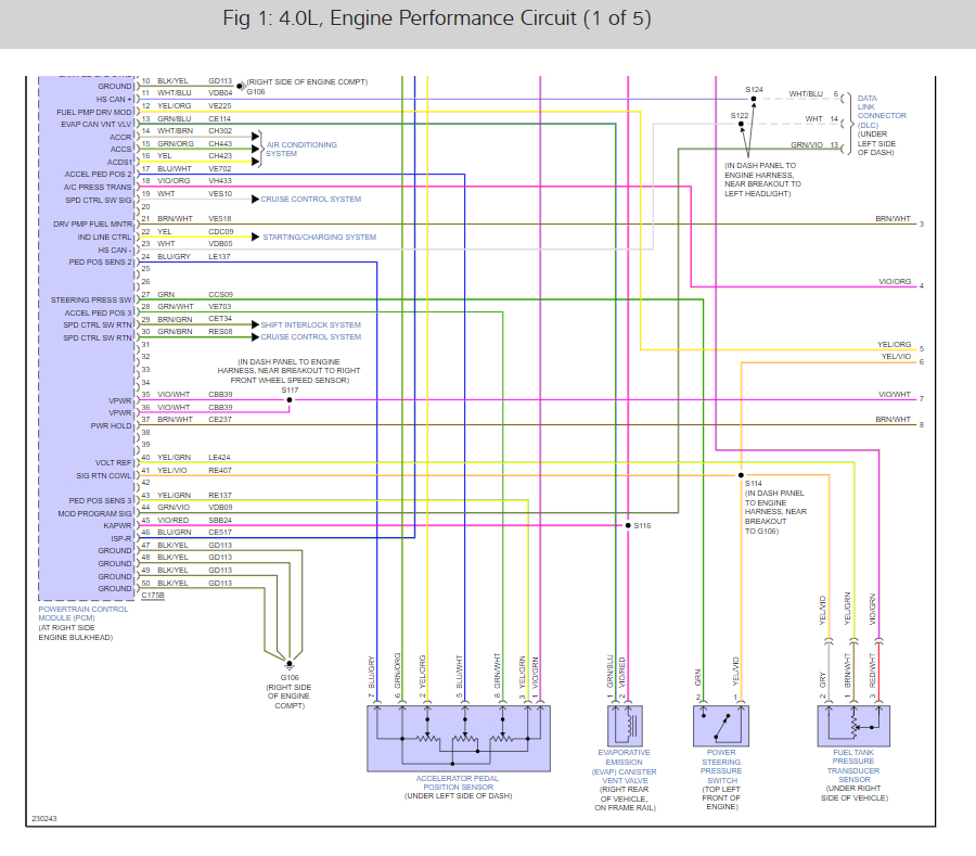

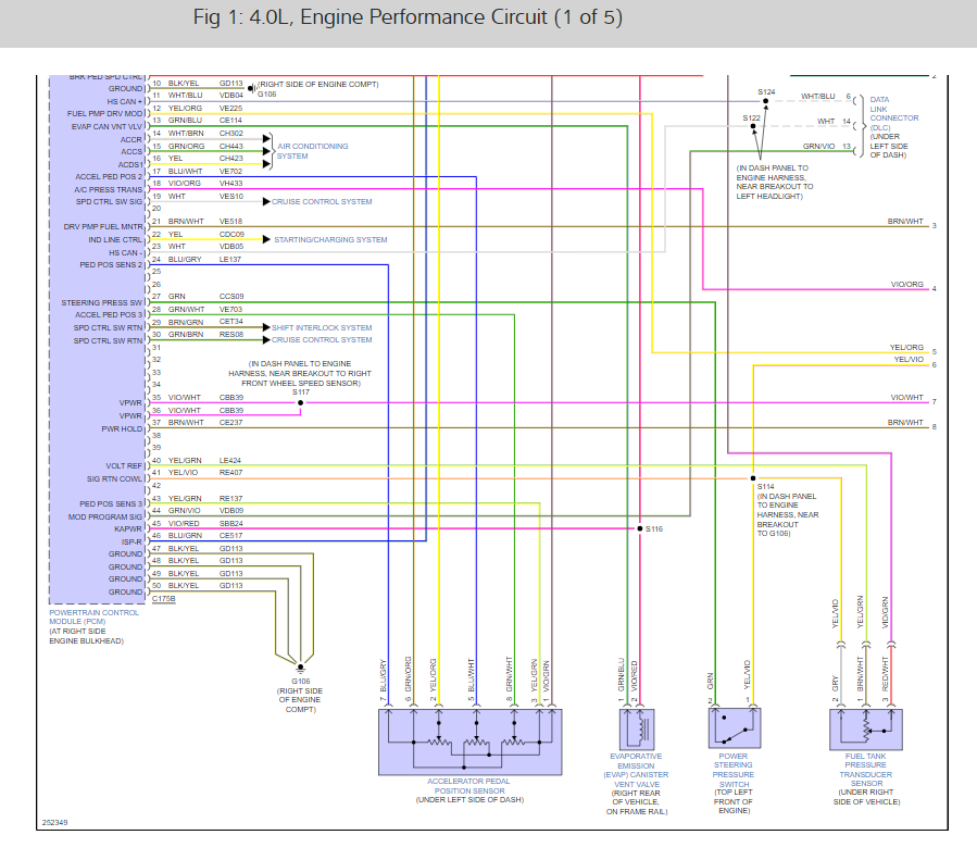

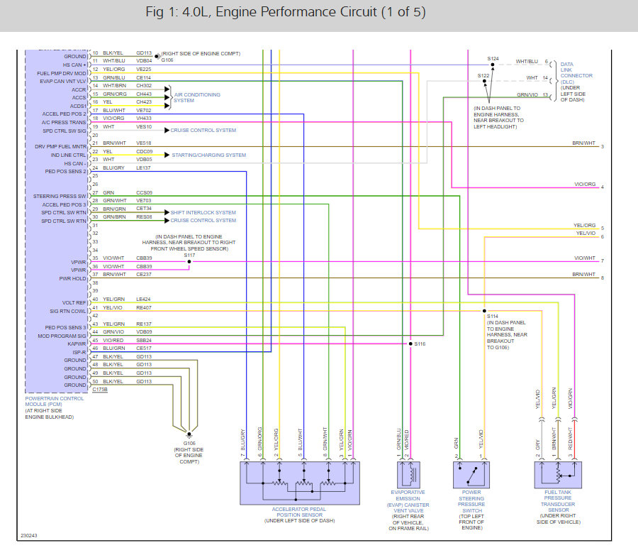

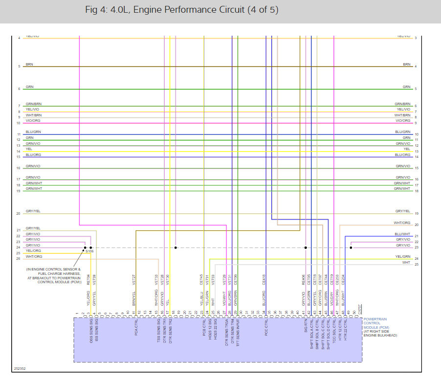

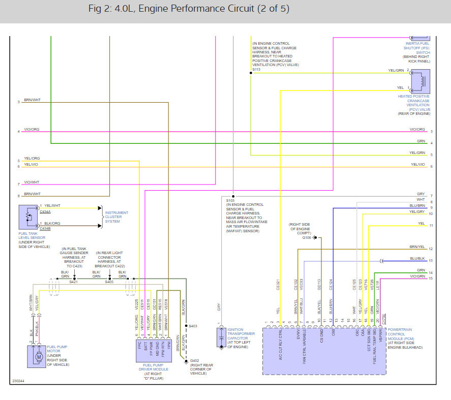

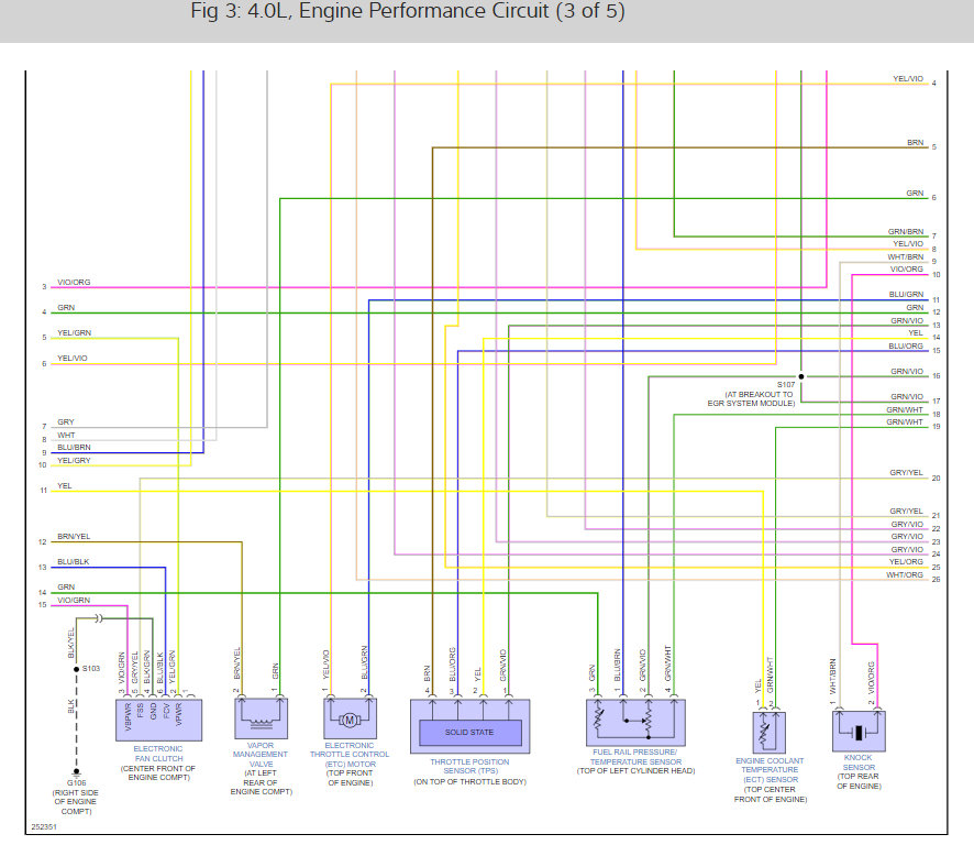

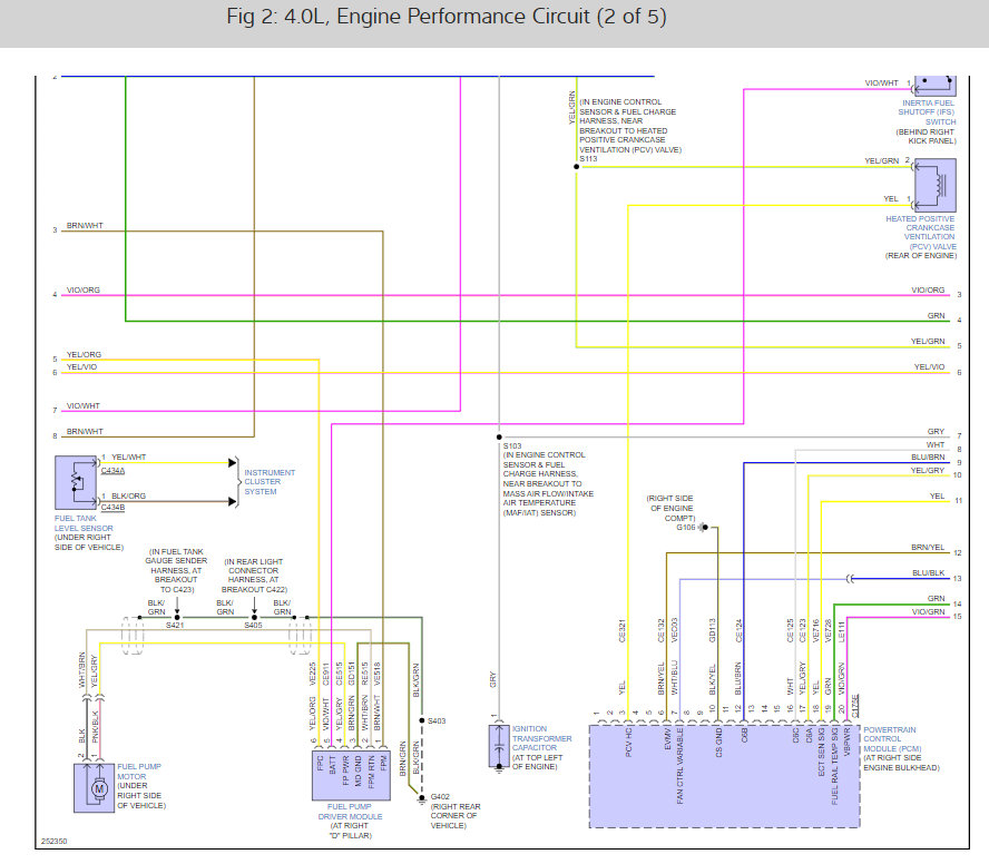

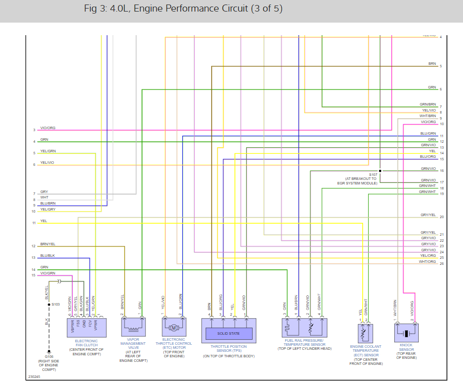

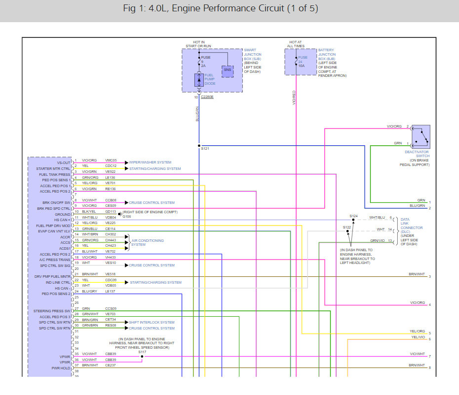

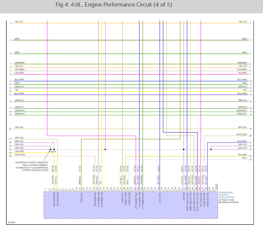

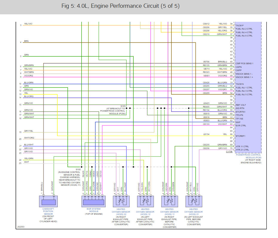

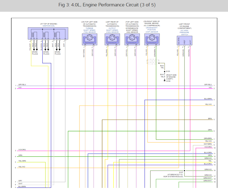

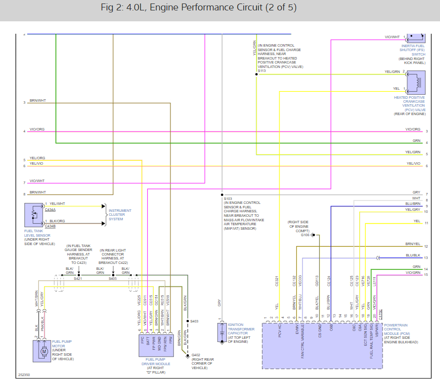

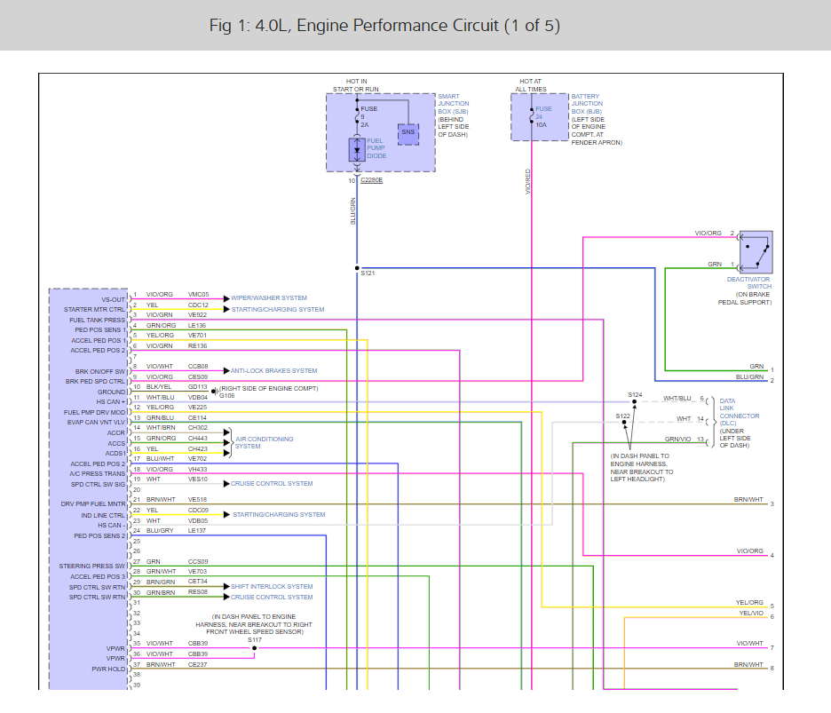

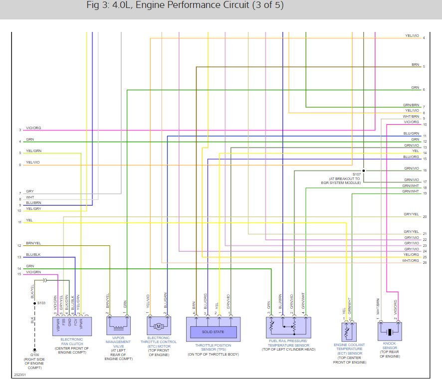

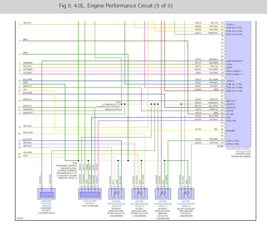

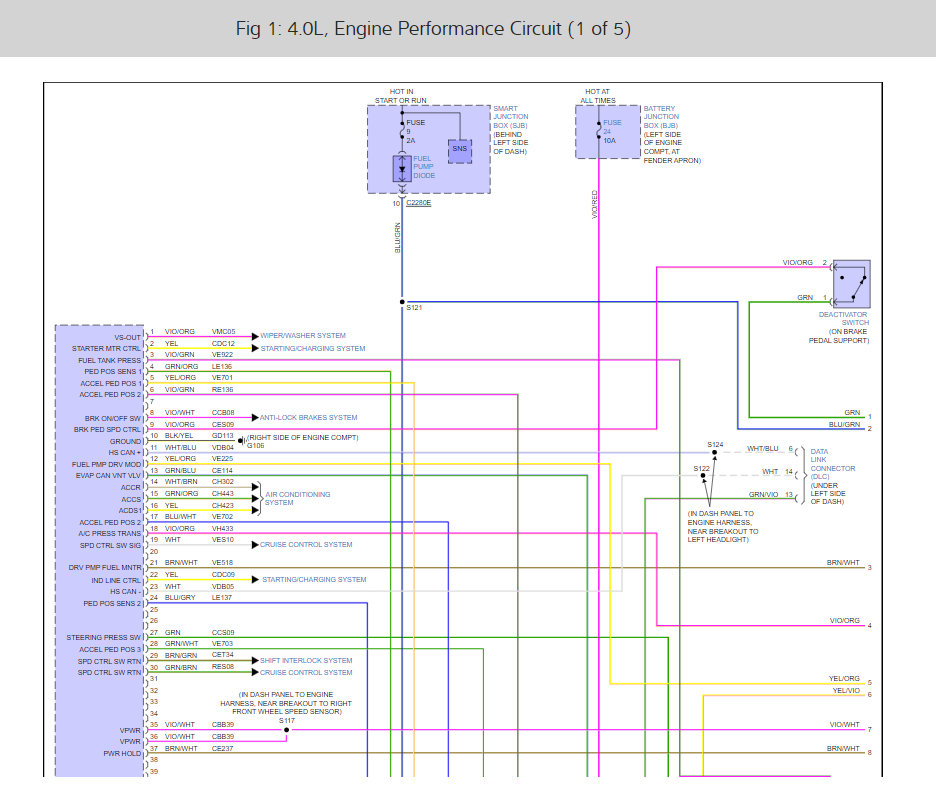

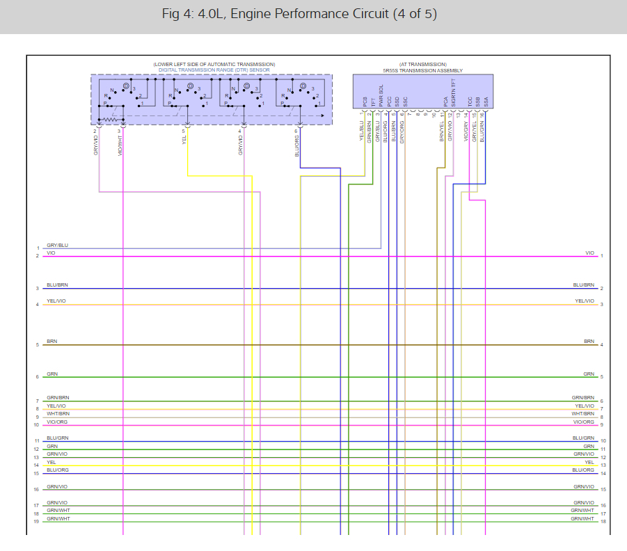

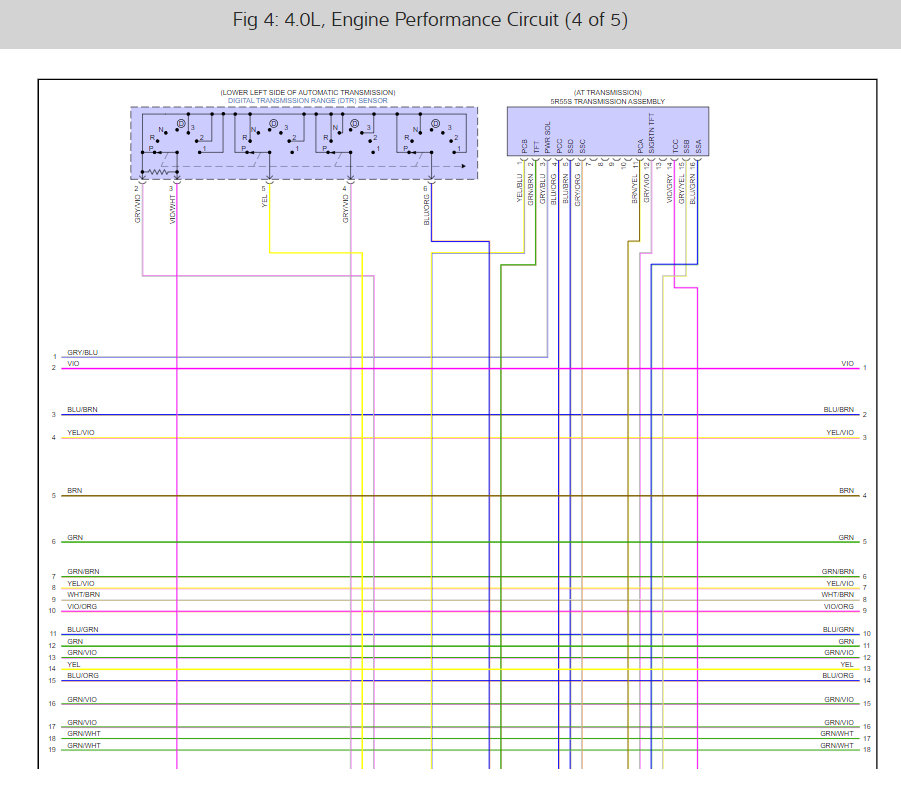

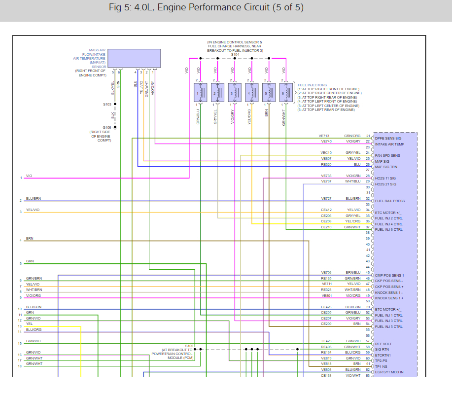

Yep, here are both the 2006 and 2007 engine and PCM wiring diagrams with a guide to help you see how to check the connections.
Check out the images (below). Please let us know what happens. The first set of engine wiring diagrams are for the 2006.
