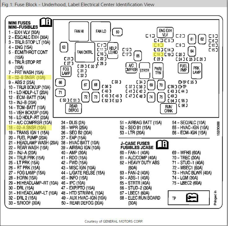

Okay, So the P0030, P0053, P0134, P0135 & P0422 all have to do with the O2 sensors mainly sensor 1 bank 1. They are heated sensors and have fuses, I would look for the fuse block under hood and find the related fuse for sensor 1 check to see if it is blown.

Here is the fuse block diagram.
