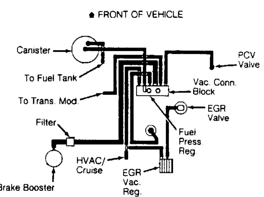

just cross A and B on aldl with a paper clip where you plug in scanner and turn key on then get back to us with the codes. it is OBD1 and telling you they cannot scan it is a lie. they just do not know how. it can be any sensor in engine messing things up causing it. check for vacuum lines off/broken/rotted etc. the aldl is at bottom left of steering column.

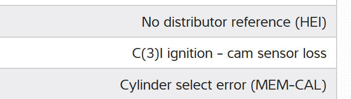

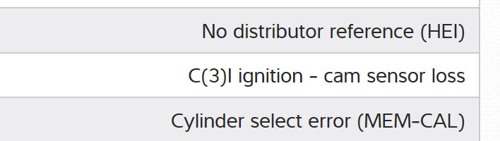

I did find a repair shop that seems competent. They told me the code is 41.
What does that tell you? I hope it is not an expensive repair as my mom is 94 and has finally agreed to sell the car. I truly appreciate your help.

all of these codes means the dist or ecm isn't sending a signal so it will run. see pic. it depends on which ignition system you have as there are two different ones. the one that says mem-cal may be a computer issue which would require another computer see pic
