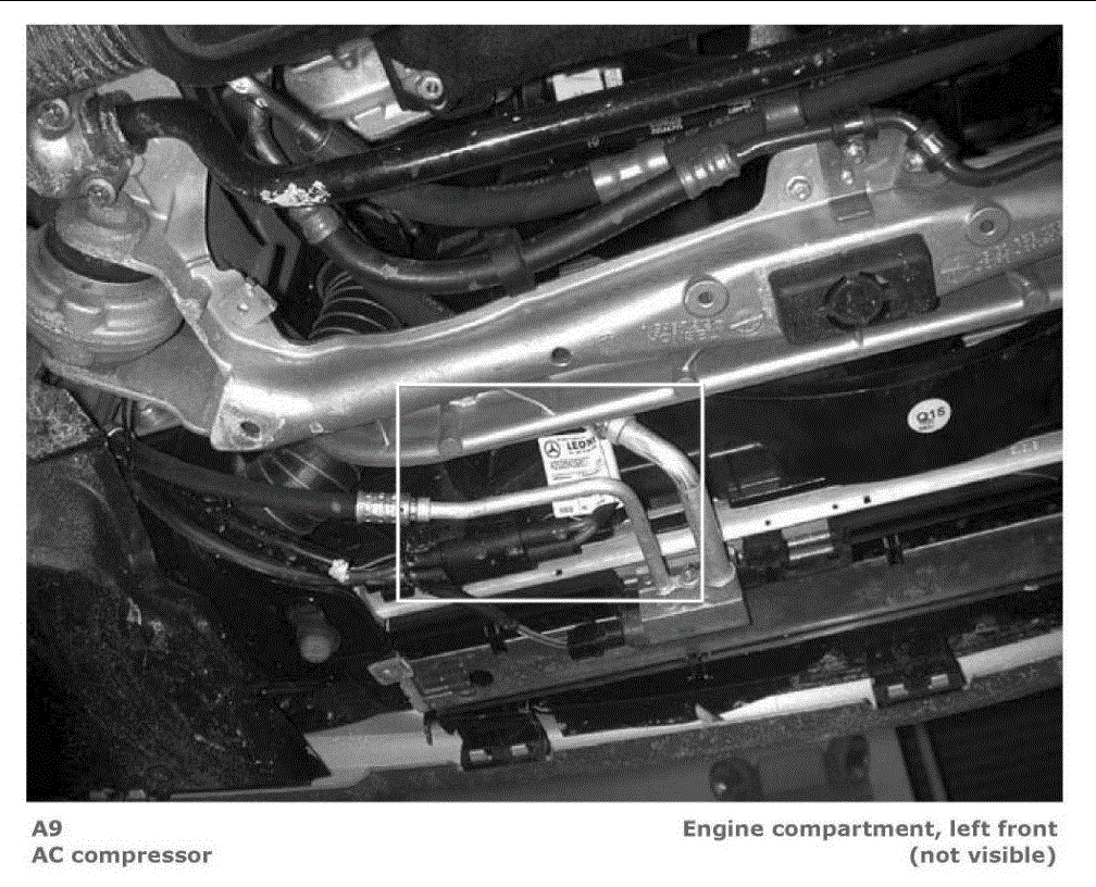

Based on the location of the compressor, I suspect there has been damage to wiring or something disconnected.
To access the compressor, you need to remove the splash panel under the vehicle's engine compartment. Before doing that, check wiring around the alternator drive belt and in the engine compartment. If you find no issues, then you should remove the slash panel under the vehicle so you can inspect that area.
I attached a pic below showing the location of the compressor. Also, here is a link that you may find helpful when checking wiring.
See pic below.
