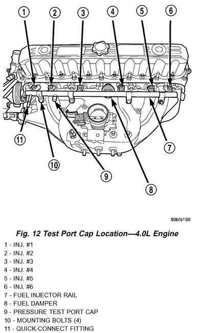

Fig. 12 Test Port Cap Location - 4.0L Engine
pic 1

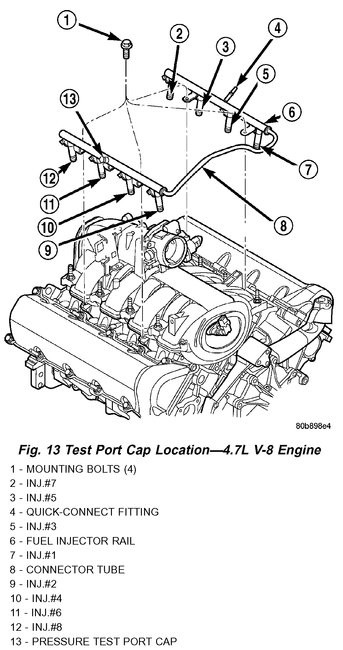

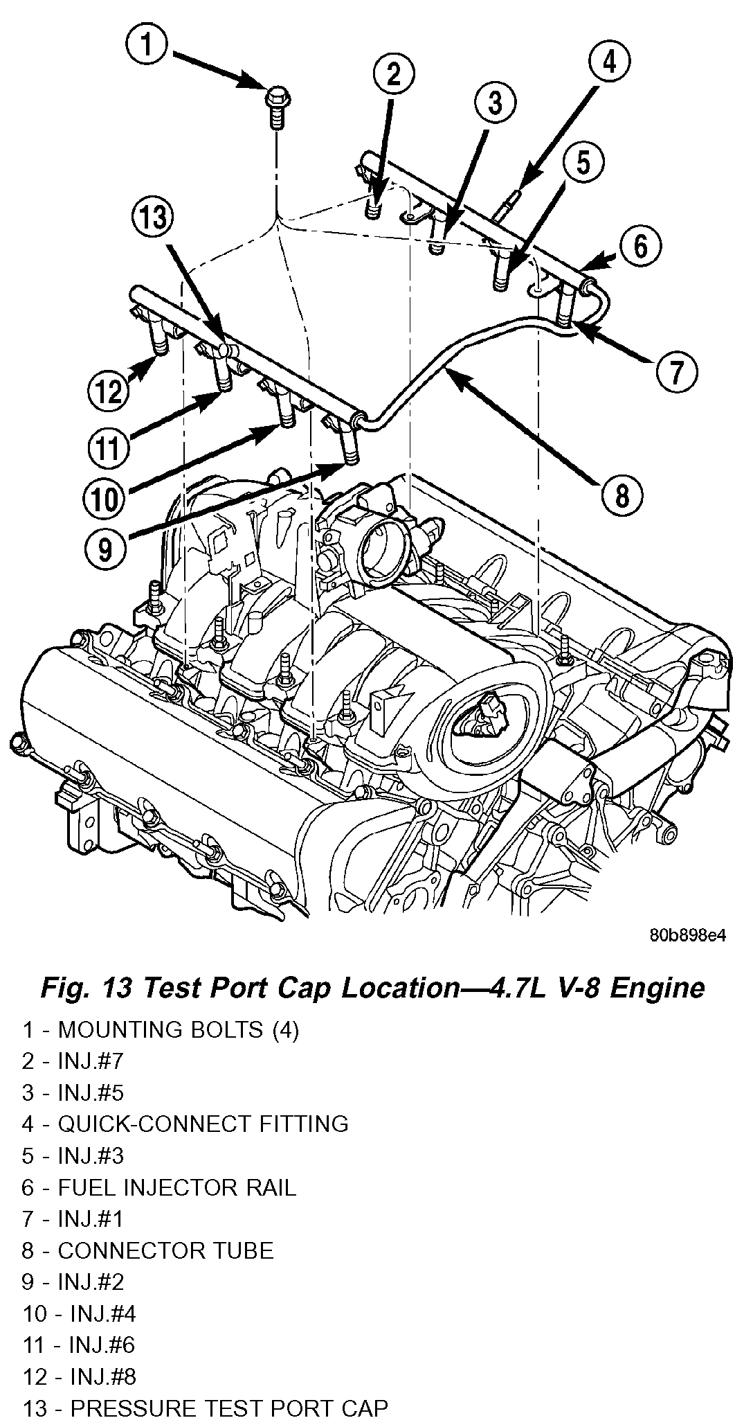

Fig. 13 Test Port Cap Location - 4.7L V-8 Engine
pic 2

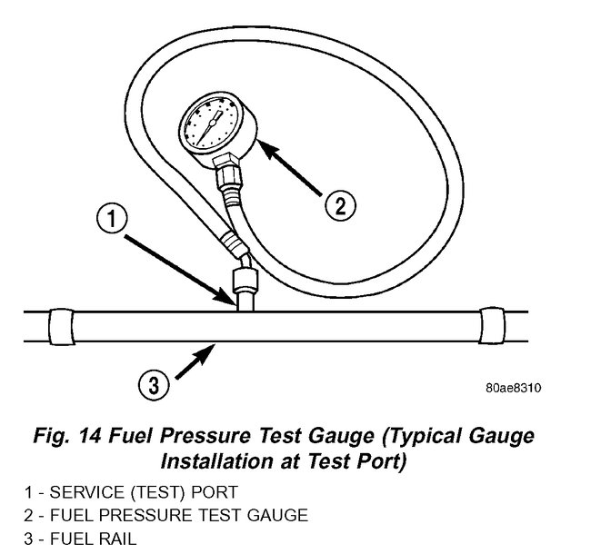

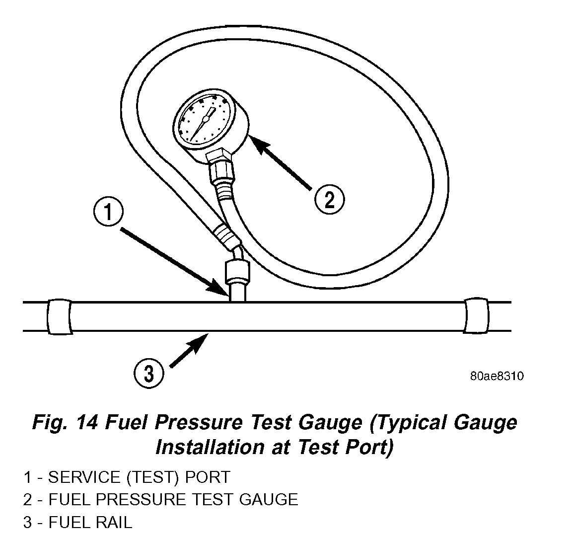

Fig. 14 Fuel Pressure Test Gauge (Typical Gauge Installation At Test Port)
pic 3
1. Remove pressure test port cap at fuel rail test port (Fig. 12) or (Fig. 13). Connect 0 - 414 kPa (0 - 60 psi) fuel pressure gauge (from gauge set 5069) to test port pressure fitting on fuel rail (Fig. 14). The DRB III Scan Tool along with the PEP module, the 500 psi pressure transducer, and the transducer-to-test port adapter may also be used in place of the fuel pressure gauge.
2. Start and warm engine and note pressure gauge reading. The DRB scan tool may also be used to power fuel pump. Fuel pressure should be 339 kPa ± 34 kPa (49.2 psi ± 5 psi) at idle.

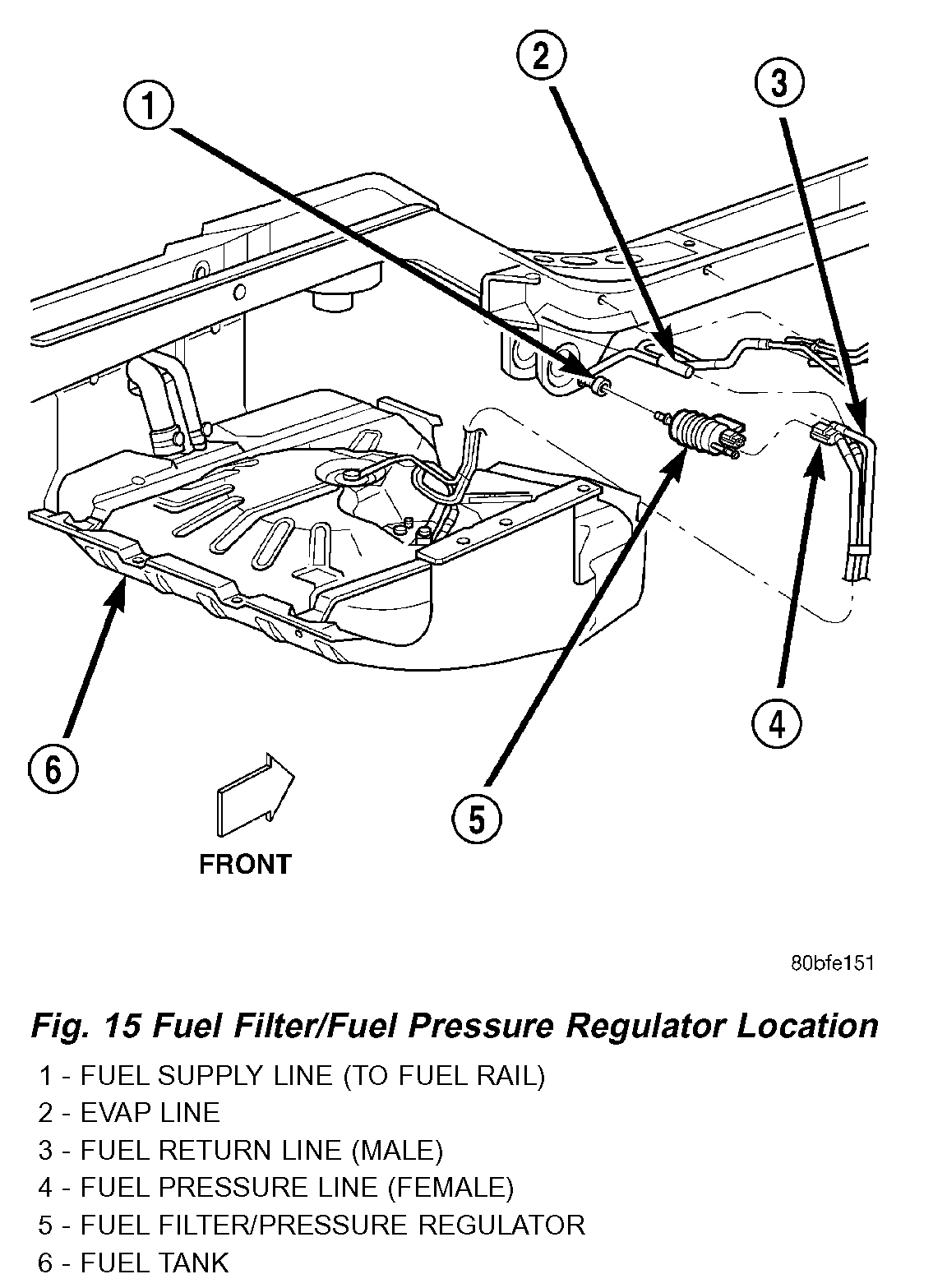

Fig. 15 Fuel Filter/Fuel Pressure Regulator Location
pic 4
b. If line is not kinked and pressure is low, raise vehicle and disconnect fuel pressure line at fuel filter/fuel pressure regulator (Fig. 15) . Three fuel lines are attached to filter/regulator. The fuel pressure line is attached to the right side of filter/regulator. It is also the most rearward of the two (Fig. 15)
c. Install Special 5/16" Fuel Line Adapter Tool # 6539 between disconnected fuel line and filter/regulator fitting
d. Attach 0 - 60 psi fuel pressure test gauge to "T" fitting on tool 6539.
e. Use DRB scan tool to power fuel pump. If pressure is now within specifications, replace fuel filter/fuel pressure regulator.
f. If pressure is still low, replace fuel pump module.
4. If operating pressure is above 54.2 psi, electric fuel pump is OK, but fuel pressure regulator is defective Replace fuel filter/fuel pressure regulator.

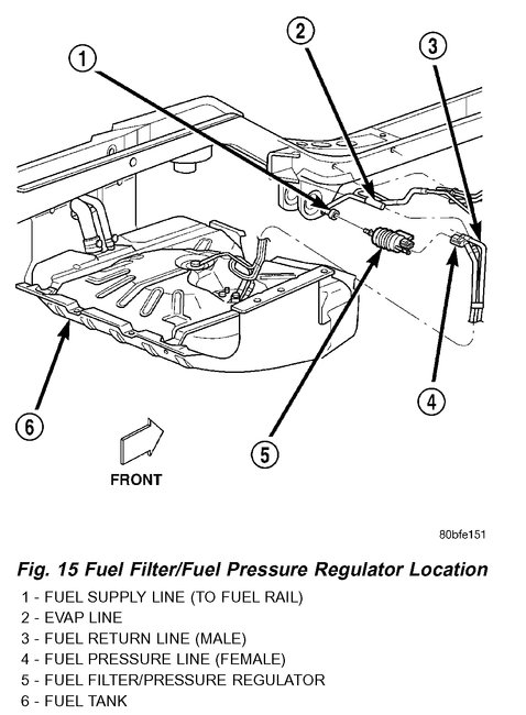

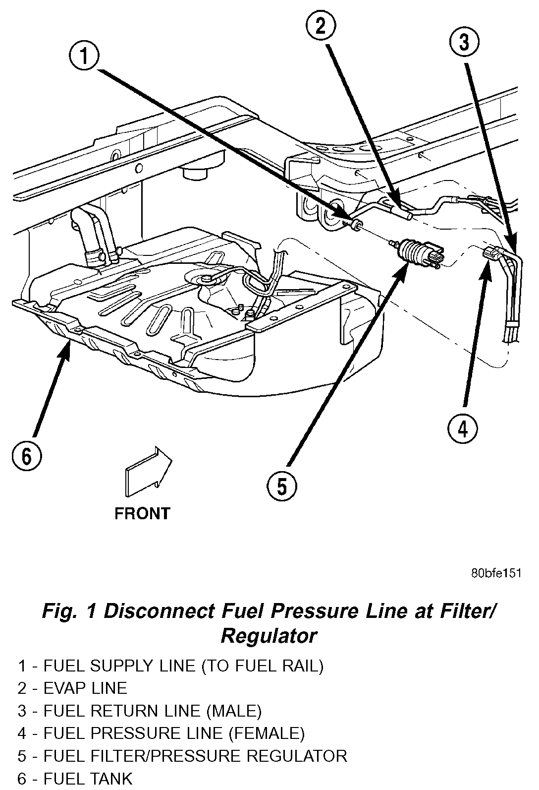

Fig. 1 Disconnect Fuel Pressure Line At Filter/Regulator
pic 5
Fuel Line Identification: The fuel filter/pressure regulator is located in front of the fuel tank and above the rear axle. It is transversely mounted to a chassis crossmember (left-to-right). The filter/regulator is equipped with 3 fuel line fittings (2 at one end and 1 at the other end). The single fitting facing the left side of the vehicle is the supply line to the fuel rail (Fig. 1) . The 2 fittings facing the right side of the vehicle are connected to the fuel tank. Of these 2 fittings, the fitting towards the front is used for fuel return to the fuel tank. The fitting towards the rear is a pressure line. This rear fitting must be disconnected for the following step.
3. See previous step. Disconnect fuel pressure line at rear of filter/regulator. This is a 5/16" quick-connect fitting (Fig. 1). Refer to Quick-Connect Fittings for procedures.
4. Obtain correct Fuel Line Pressure Test Adapter Hose Tool # 6539 for 5/16" fuel lines. Connect one end of this Special Tool into the disconnected fuel pressure line. Connect the other end of the Tool into fitting on filter/regulator.

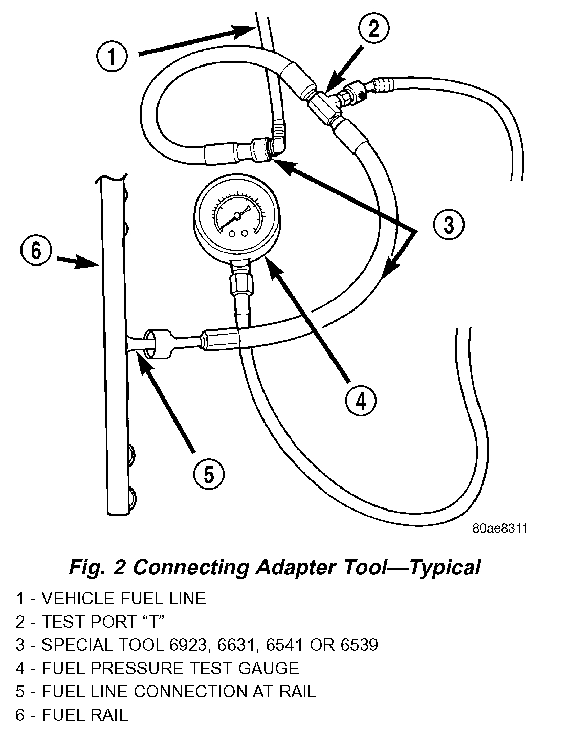

Fig. 2 Connecting Adapter Tool - Typical
7. Obtain a second Fuel Line Pressure Test Adapter Hose Tool # 6539 for 5/16" fuel lines. Connect this tool between disconnected fuel line and fuel rail (Fig. 2)
8. Connect the 0 - 414 kPa (0 - 60 psi) fuel pressure test gauge (from Gauge Set 5069) to the test port on the appropriate Adaptor Tool. NOTE: The DRB III Scan Tool along with the PEP module, the 500 psi pressure transducer, and the transducer-to-test port adapter may also be used in place of the fuel pressure gauge.
CAUTION: The fittings on both tools must be in good condition and free from any small leaks before performing the proceeding test.
