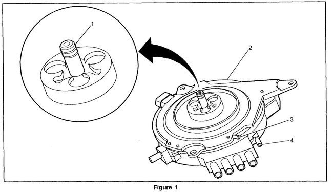

pic 1
1. Opti-Spark Distributor II (Pin Drive - WITH positive vent system) can be identified by the intake manifold vacuum hose connection (3), air intake duct hose connection (4), or non-splined pin drive (1). Refer to Figure 1.

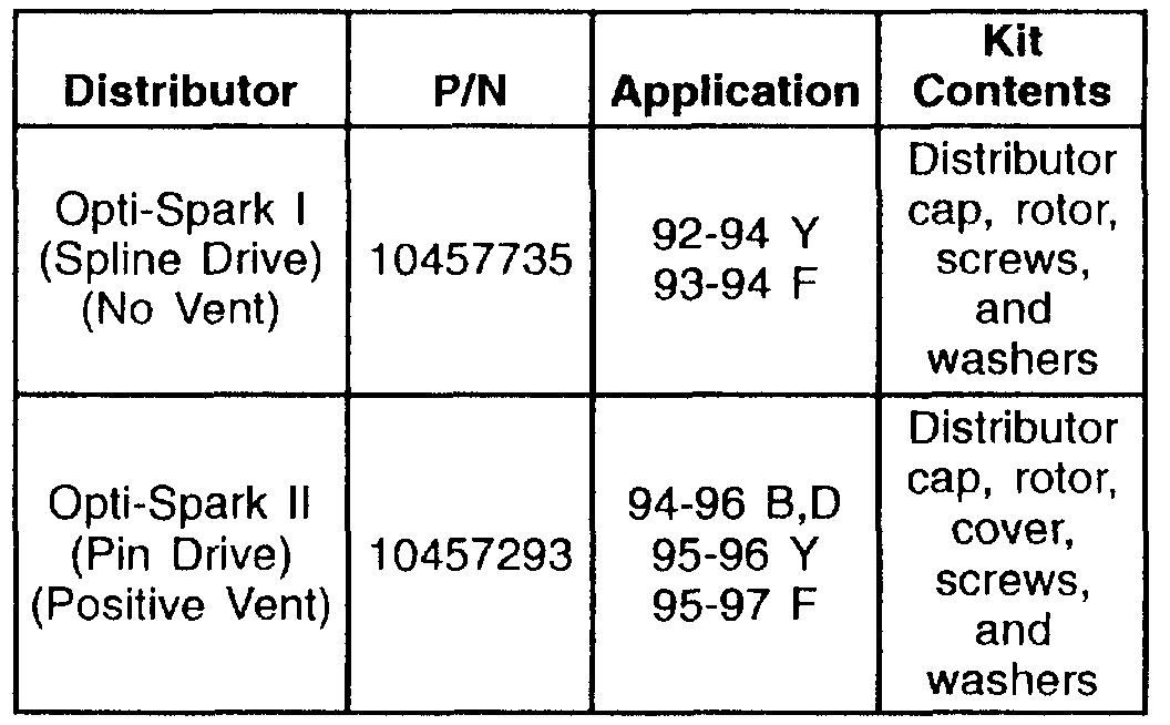

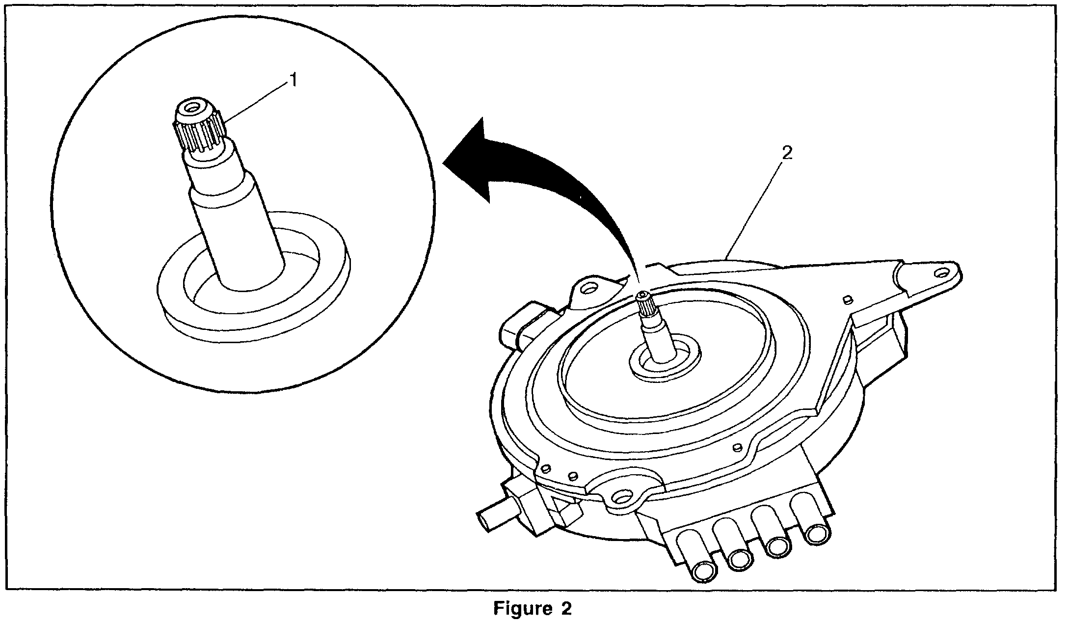

pic 2
2. Opti-Spark Distributor I (Splined Drive - Without positive vent system) can be identified by the splined pin drive (1), or the lack of intake manifold vacuum hose connection and air intake duct hose connection. Refer to Figure 2.
