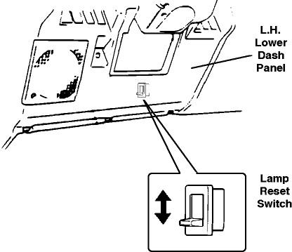

Only switch I know of is the service due switch that was to reset the service timer. That was behind the lower left dash trim if I recall. Been a long time.

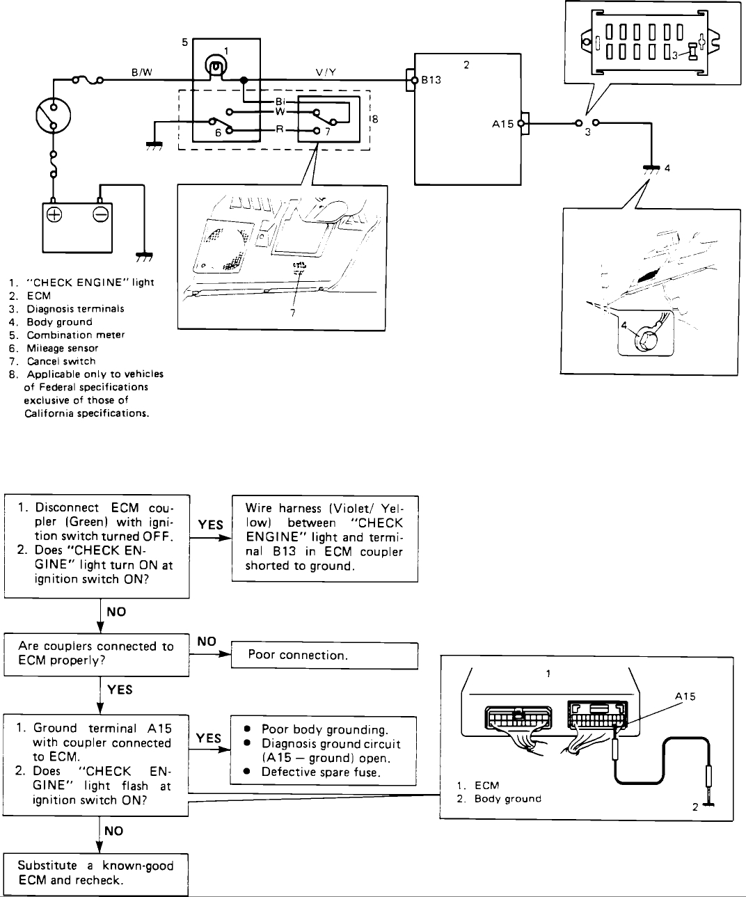

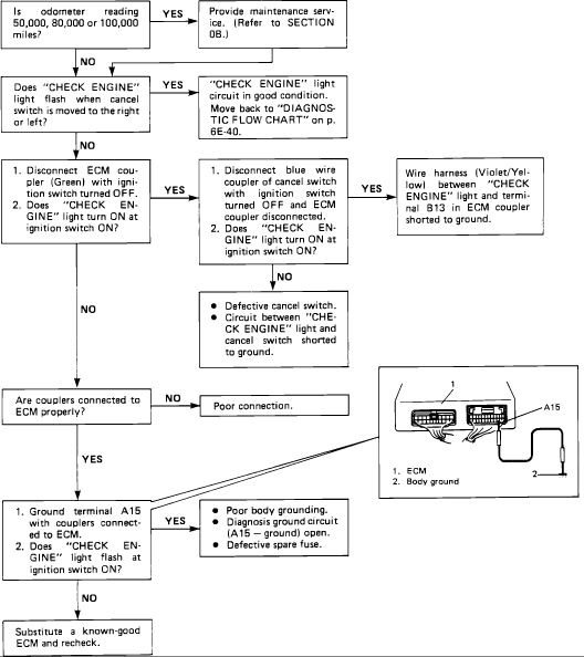

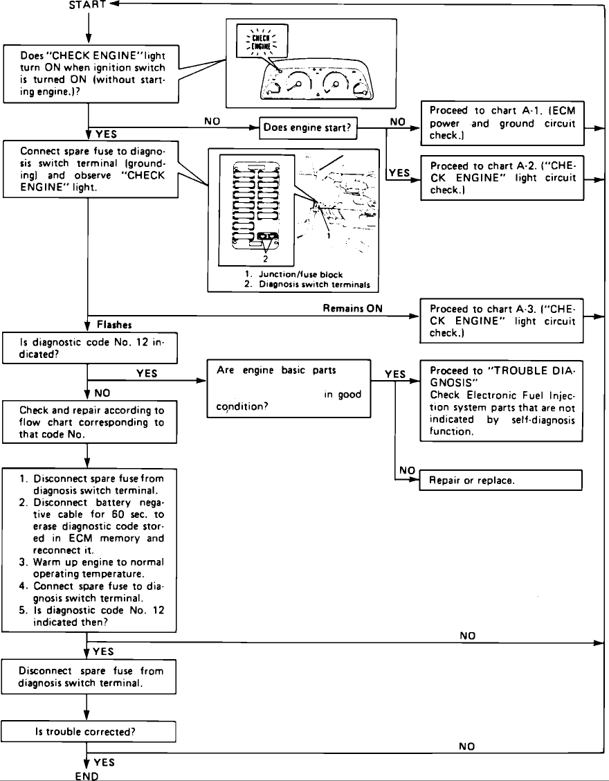

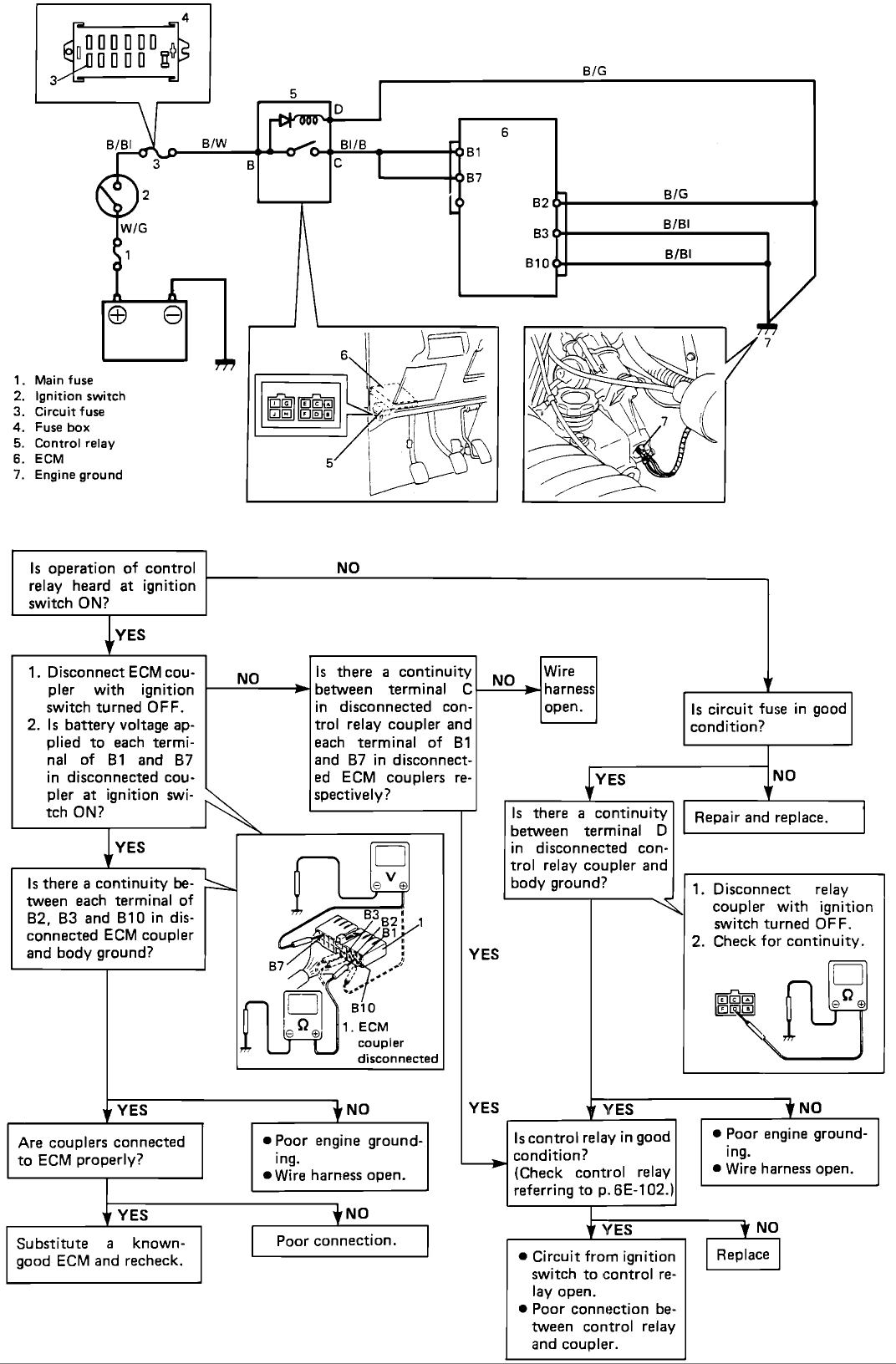

Here are some test charts to work on the issue:
Sep 28, 2017 at 1:13 PM
PSCHOON
  • 6 POSTS
Oh, wow! I was able to find the reset switch from your last image. reset the light, and it stays off! Also, was finally able to run the ODB1 code, came up 12: Normal! thanks so much!
