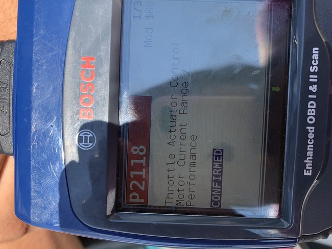

Hey, I finally have the code.
Jun 19, 2020 at 2:00 PM
Okay, can you post the code on this post so I can look it up for you?
Jun 19, 2020 at 2:04 PM
JASMINE ELISE
  • 6 POSTS
This is it.
Jun 19, 2020 at 2:08 PM

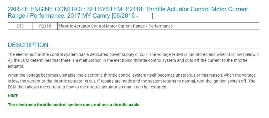

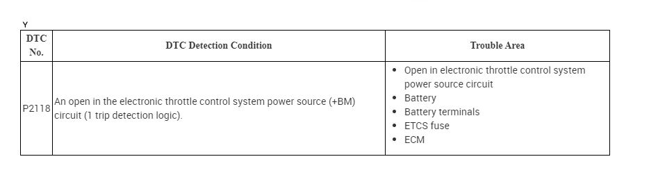

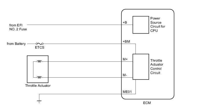

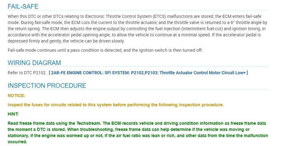

Okay, this code could be either the throttle body or a bad battery supplying low voltage.
Make sure the battery has 12.6 volts and the charging system is good.
Beyond that, you will need to check the items in the flow chart.
