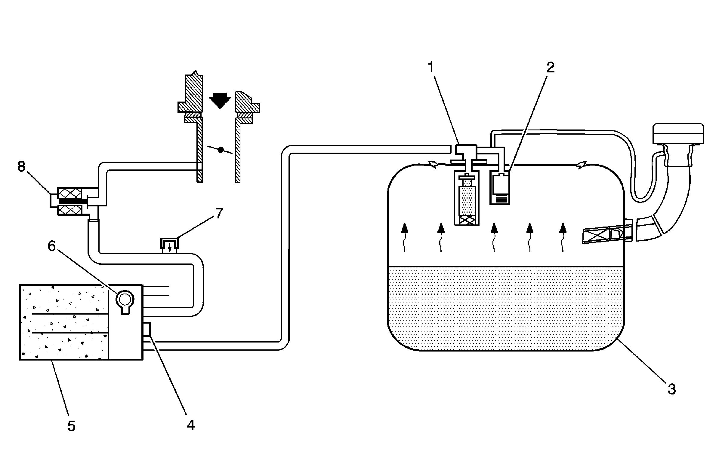

What I need you to do is check the EVAP systems hoses and charcoal canister. I attached two pictures below. The first shows the EVAP hose routing diagram. The second is a legend which identifies the parts in picture 1.
Check those things. Also, if you have replaced the fuel cap already and the code is still present, confirm the filler tube between where you add gas and the fuel tank isn't damaged, rusted, or have any holes.

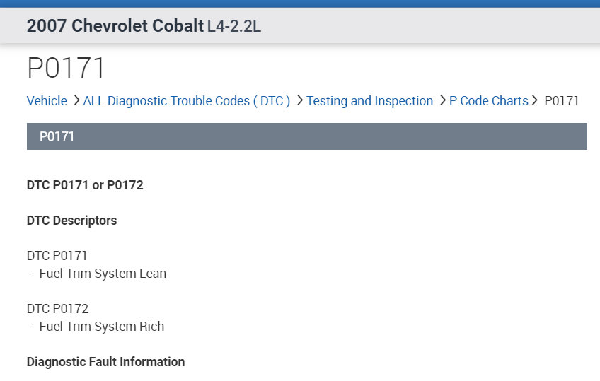

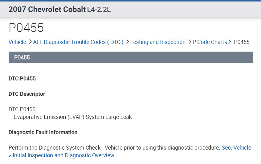

These Direct Trouble Codes (DTC)(s) are codes for engine running lean and a large EVAP leak. I have included information in the diagrams down below for you. I will add more info in a couple of minutes.
