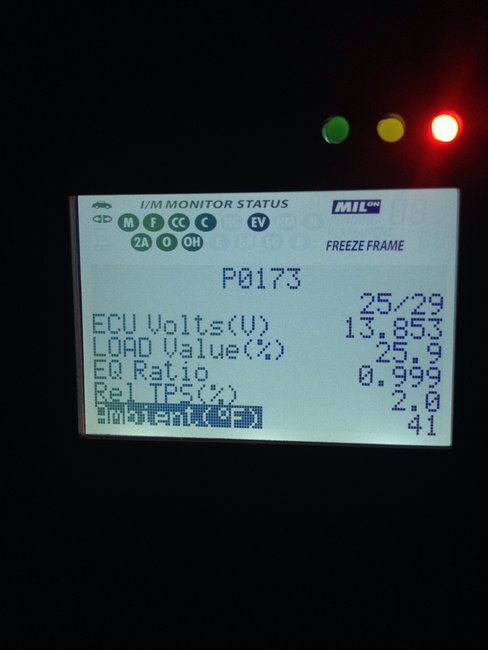

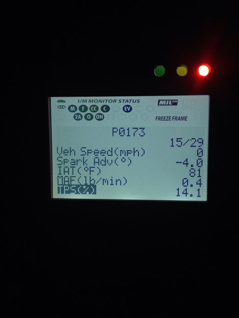

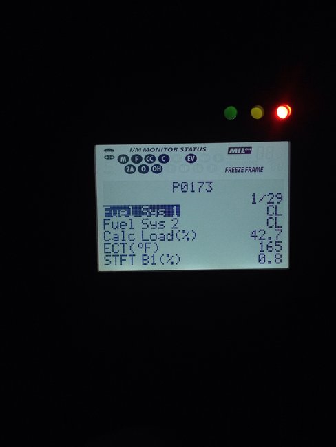

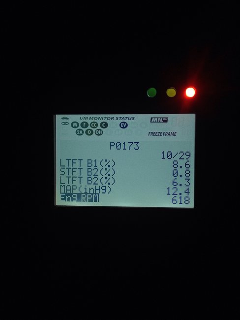

Thank You for answer! Experts say different things o2 sensor, fuel pump, fuel filter, Maf,inject, other say nothing do not worry it is dirty fuel problem, just add 100 ml 96% medical alcohol. who to believe? I want to know what the exact problem. I do not trust anyone. now put my pictures, I do not know what they mean, I captured when the car is off, something they say.
