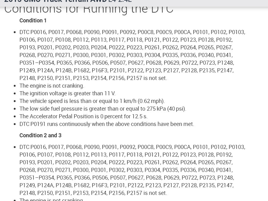

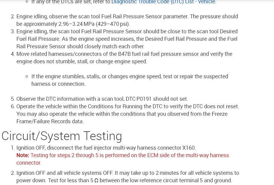

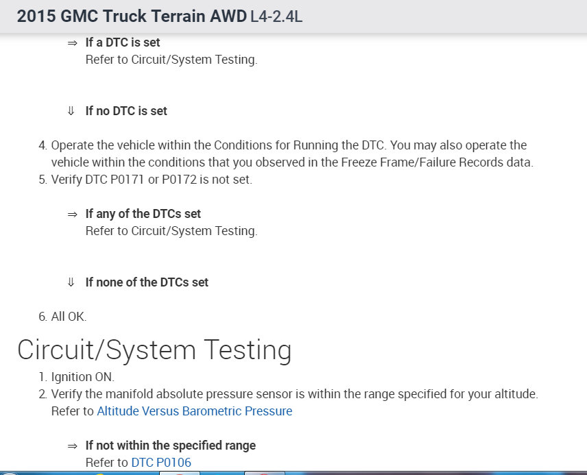

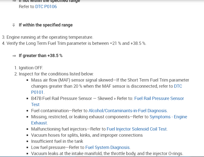

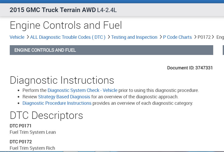

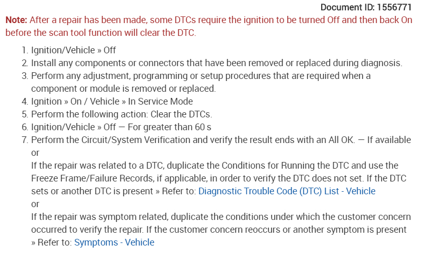

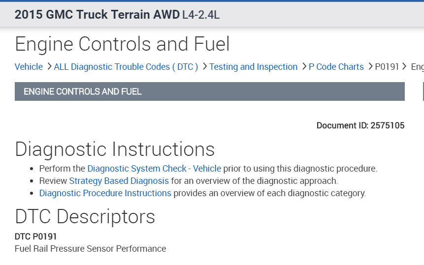

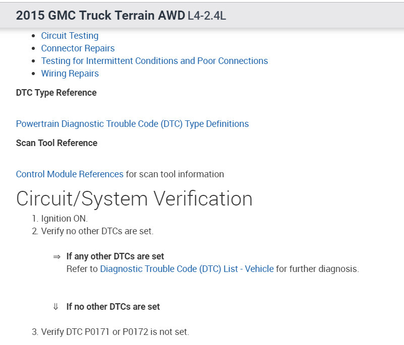

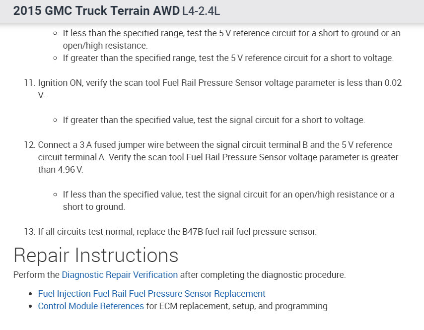

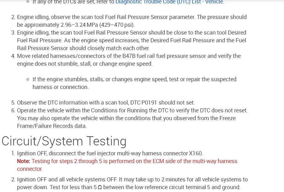

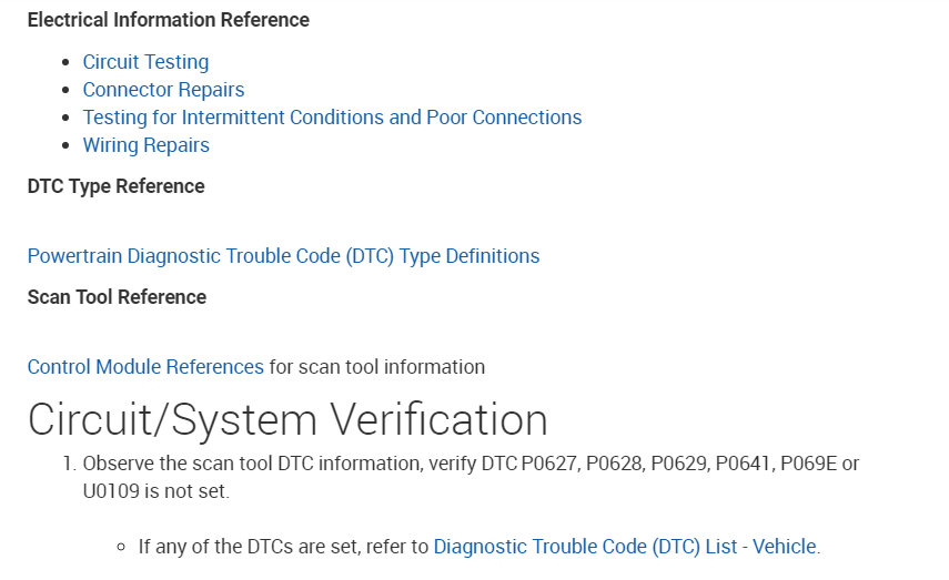

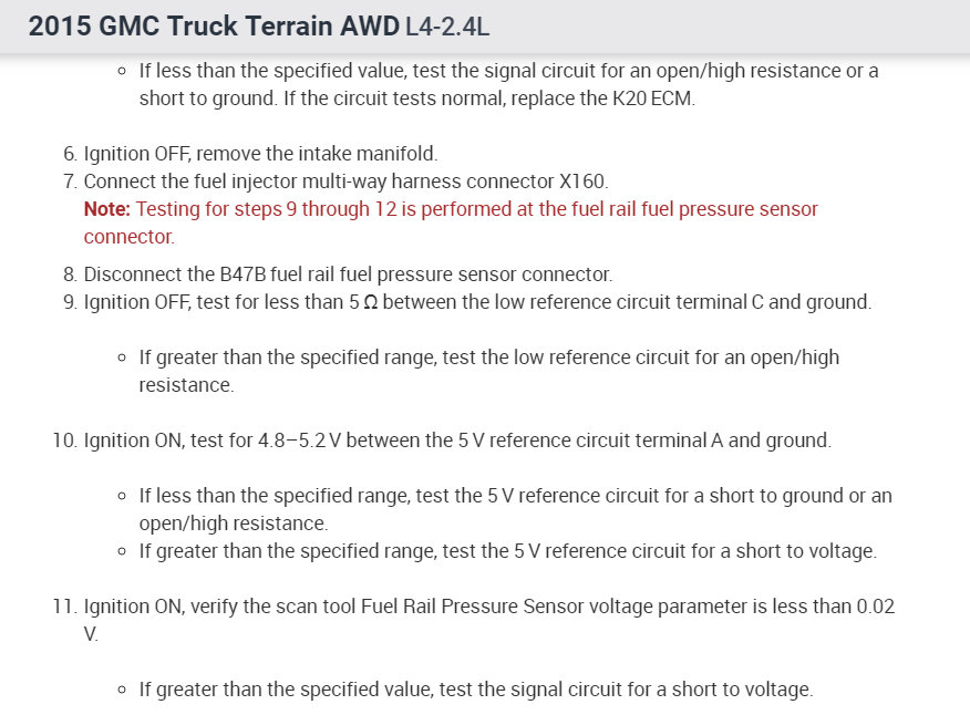

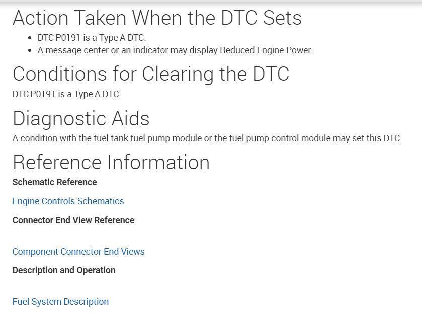

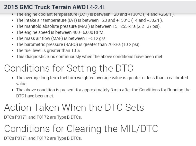

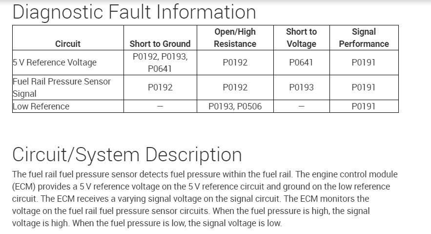

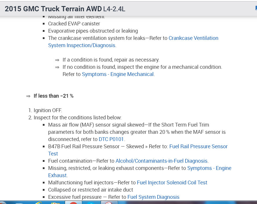

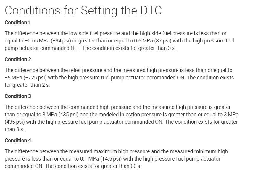

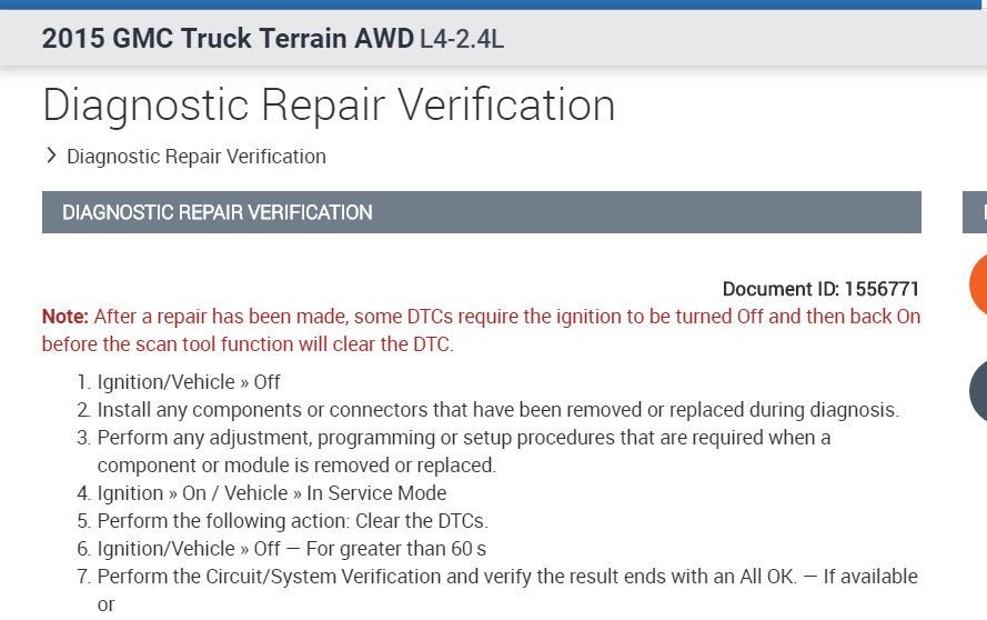

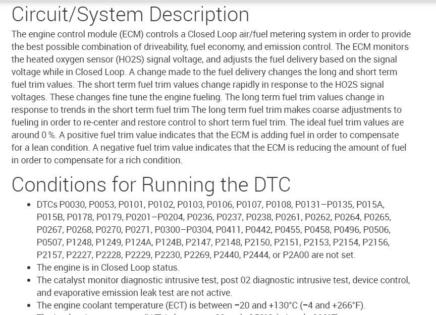

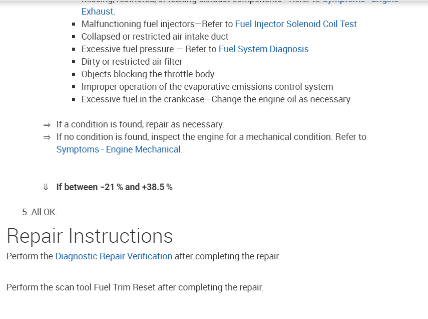

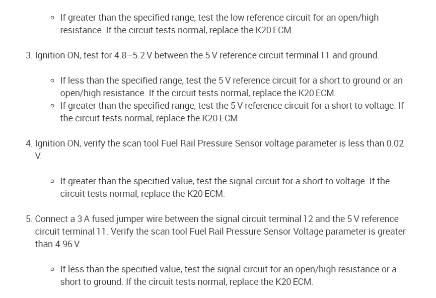

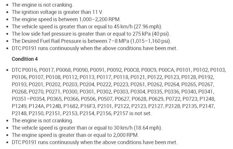

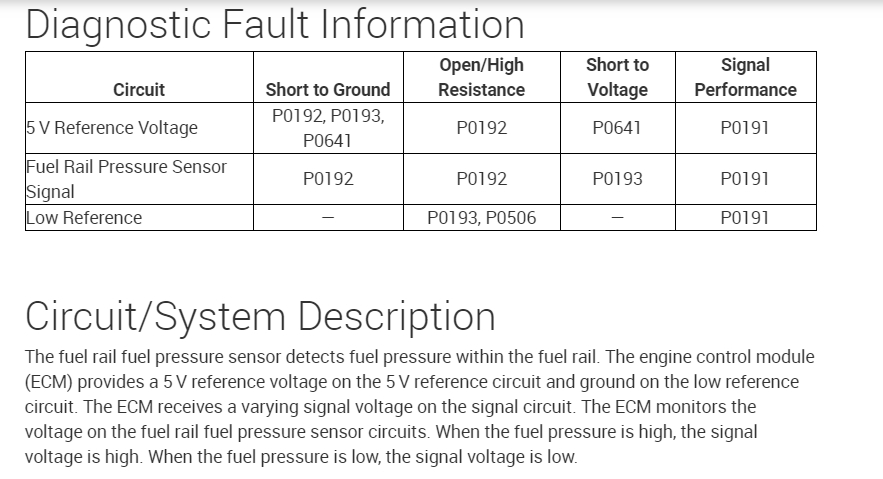

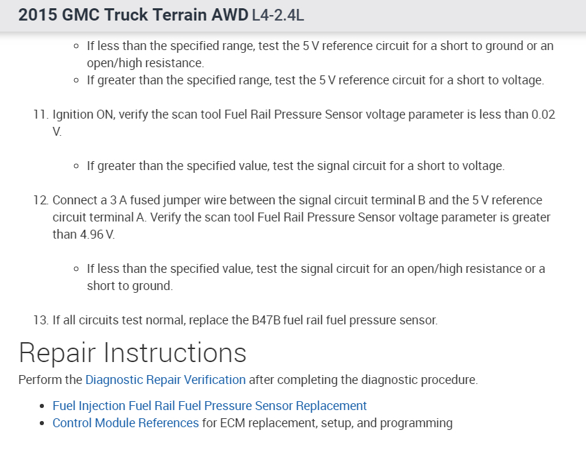

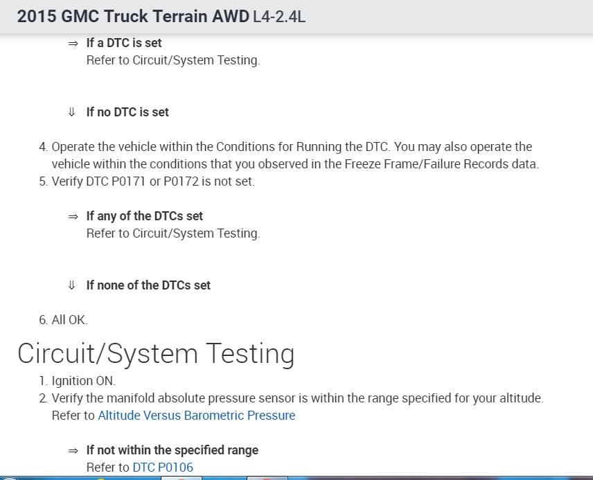

This sounds like your vehicle is in "limp mode". It goes into limp mode when there is a problem that could do serious damage to your vehicle, and allows you just to drive it to a repair shop and nothing else. Unfortunately I have no information in either of my reference material archives on how to reset your vehicle from limp mode. I have included in the diagrams below the factory troubleshooting instructions for both Direct Trouble Codes (DTC)(s) P0172 and P0191. You might try the instructions at the end of P0172 for resetting out of "limp mode". Please get back to us with what you are able to find out.
Thanks,
Alex
