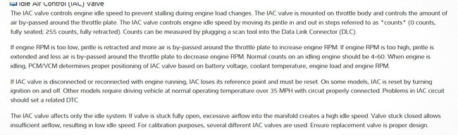

Your IAC (idle air control) may be on the "downhill".
