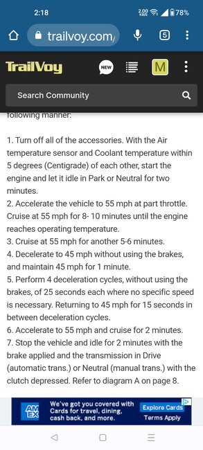

I have 'driving' relearn instructions, but can't attempt until Reduced Power is addressed. Will update. I'll copy instructions on relearn for your evaluation.
This has been very helpful, thanks.
Aug 22, 2023 at 1:44 PM
MJ_ORIGINAL
  • 8 POSTS
'driving' relearn instructions.
Aug 22, 2023 at 1:52 PM
Yep, these look correct. Let me know what happens.

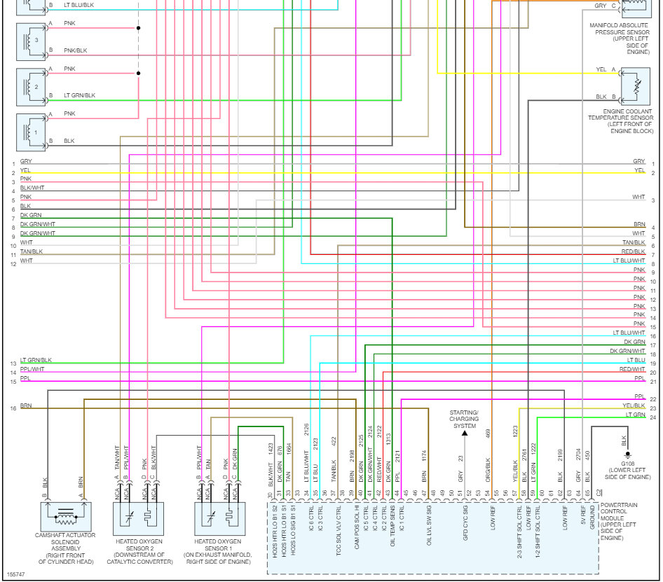

P1514 - Throttle Actuator Control Module Throttle Actuator Position Performance:
P1345 - Crankshaft Position-Camshaft Position Correlation (Bank 1 Sensor A):

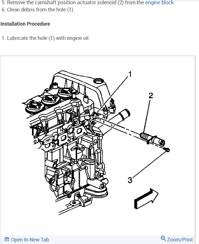

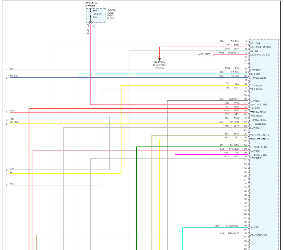

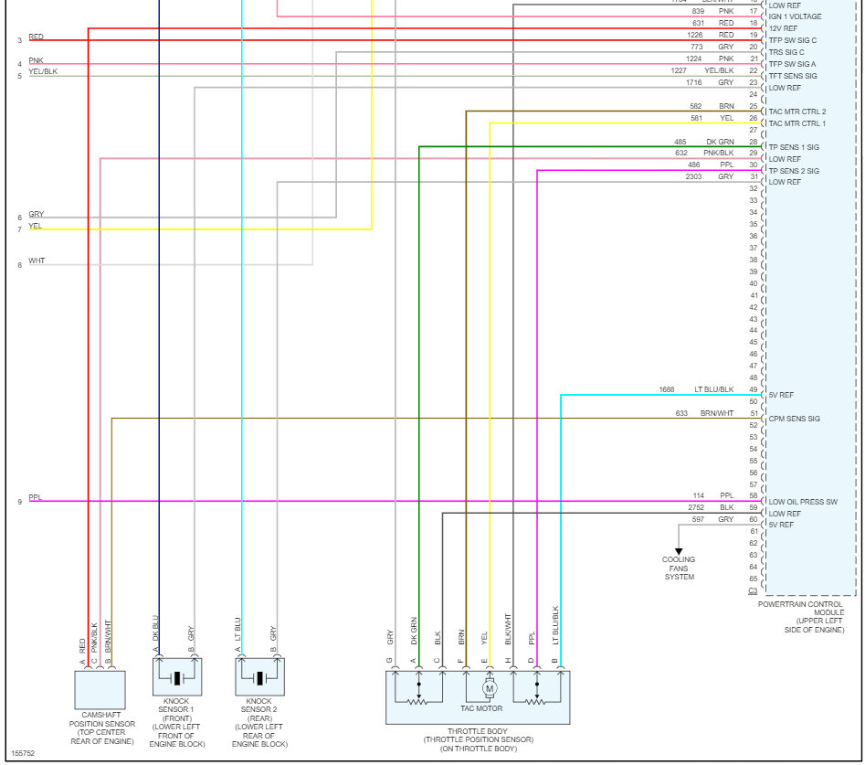

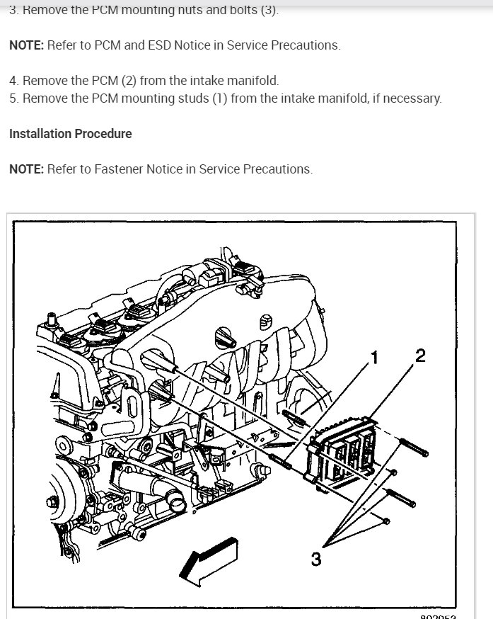

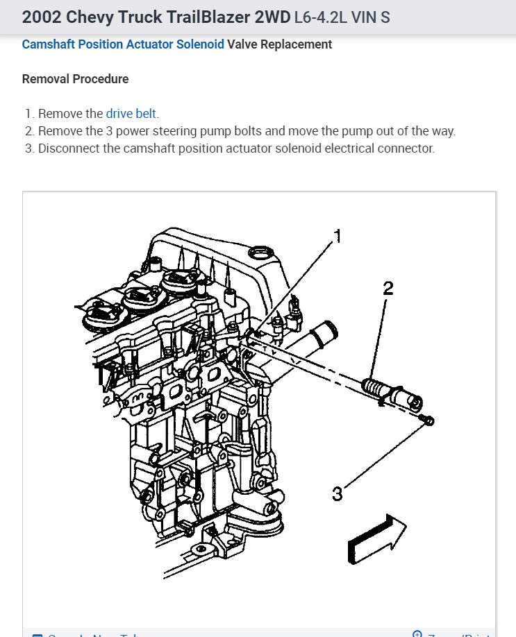

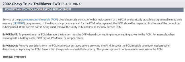

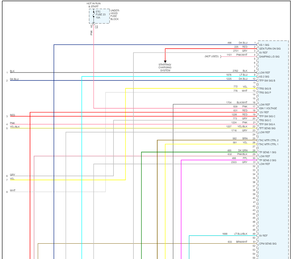

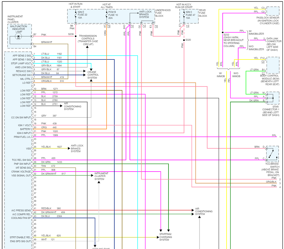

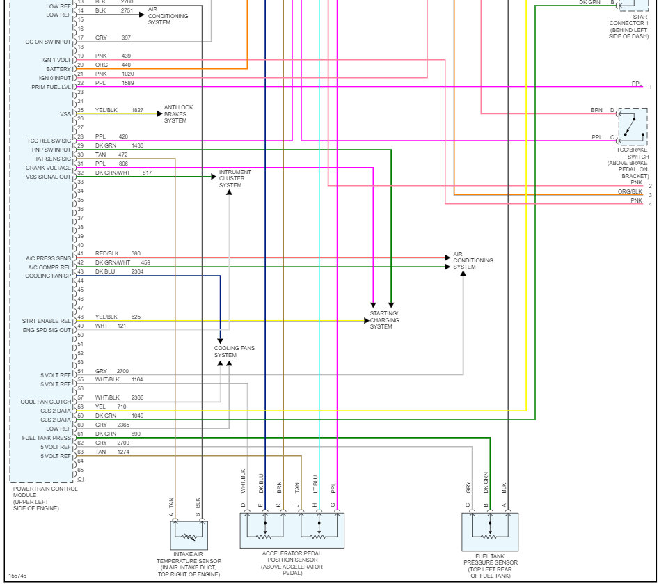

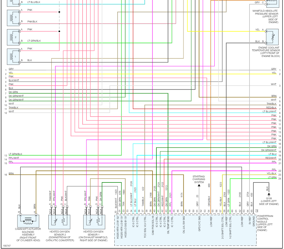

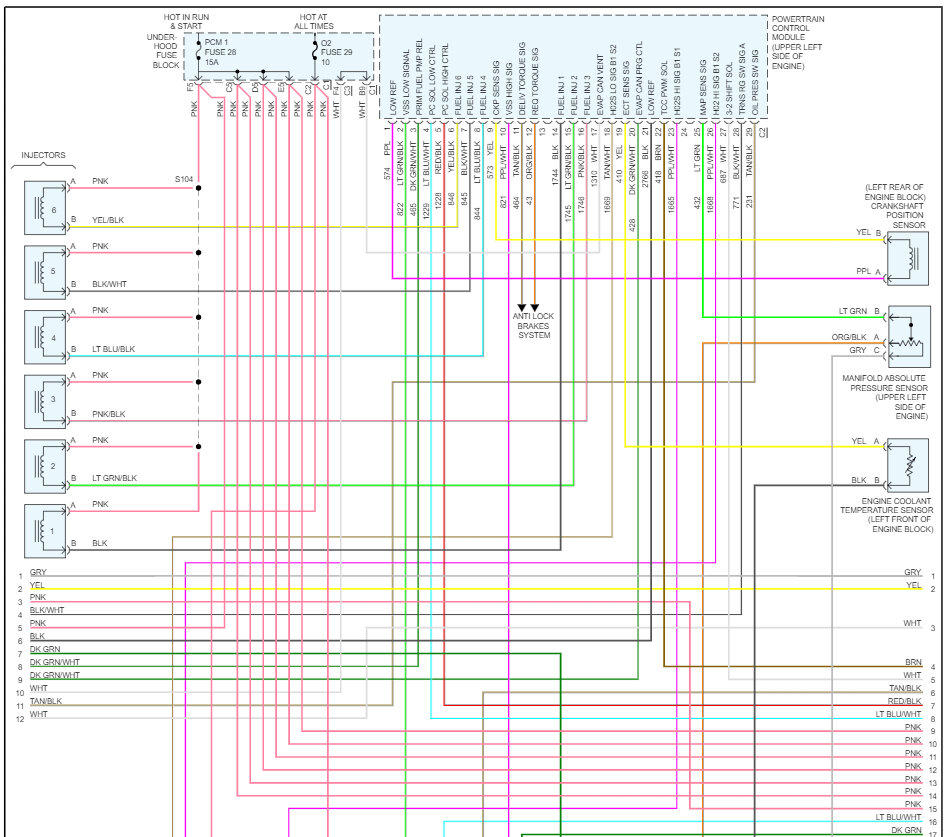

How does the engine seem to run? I would remove the camshaft actuator oil control valve to see if there are metal shavings clogging up the passage screen. Here is the location, also we need to check the wiring connections to the throttle actuator, here is a guide and the engine wiring diagrams so you can see which wires to test.
If the valve and wiring are okay, you may have a bad PCM Check out the images (below). Please let us know how it goes.

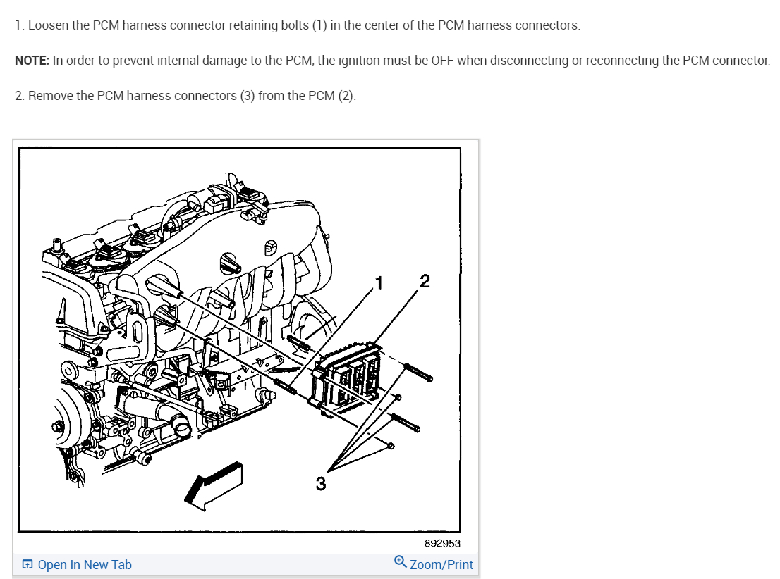

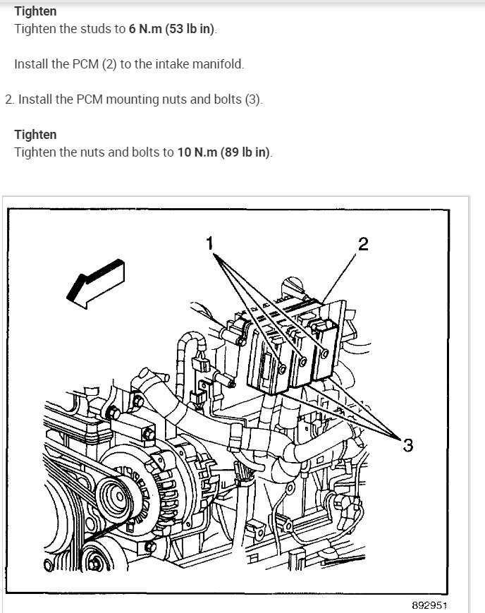

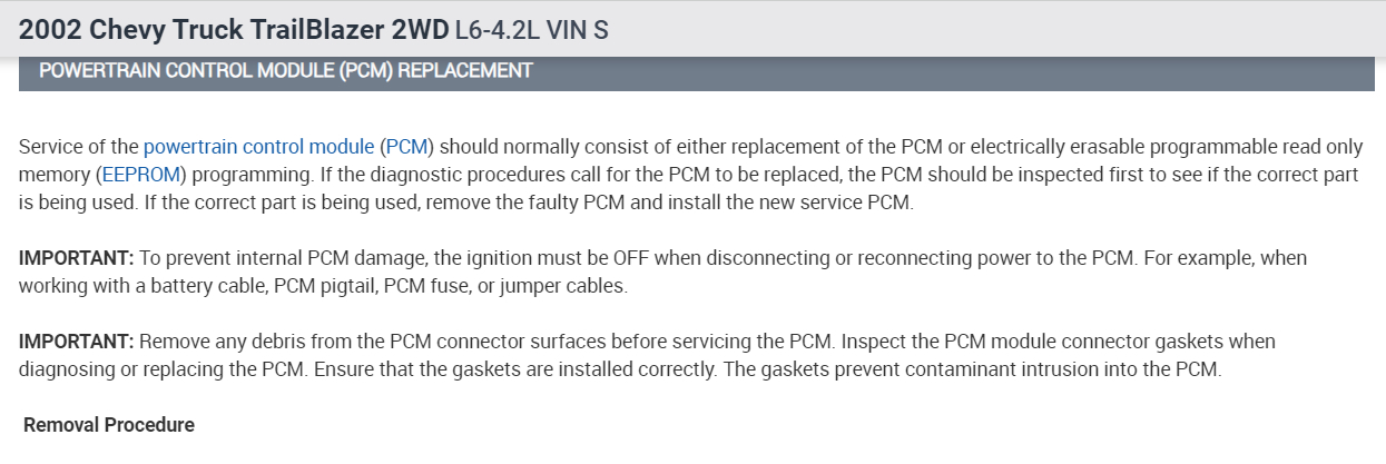

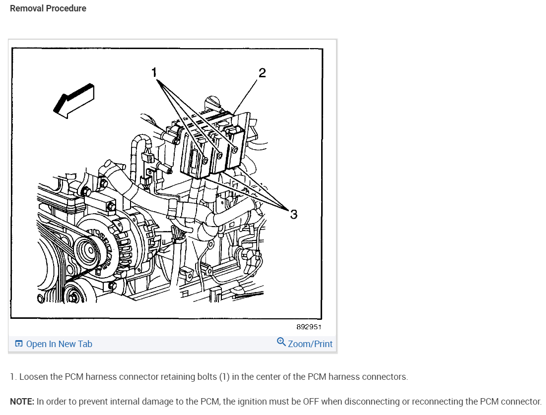

It sounds like the PCM is bad to me. Can you upload a short video of the engine noise? Here is how to change the PCM out and a guide as well, you can get a preprogrammed unit by searching Google or Ebay.

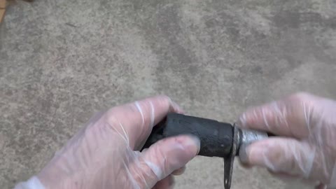

That's weird.
Before ordering a PMC, I wanted to finish with replacing the VVT solenoid since MAP, throttle body, cam and crankshaft sensors had all been replaced w/309K miles served.
Attached is a video of the VVT's condition.
Idles and starts smoother every time I drive it. I can hardly tell that the engine is running. Reduced Power and Engine lights are continuously off except on startup.
Thank God, and fingers crossed, it's not a timing chain/phaser assembly replacement.

Sounds good, the valve in your hand is bad, you should not be able to move the solenoid part like that. I would replace the VVT valve with a new or used unit.
