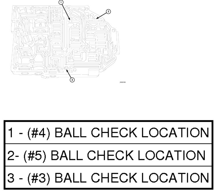

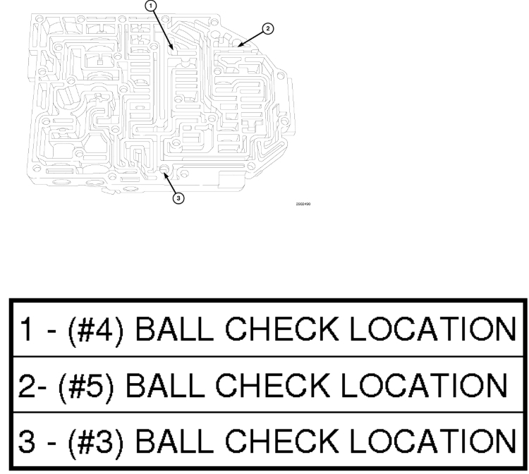

Need to figure out proper check ball position. There are three check balls, but four possible placements.
Jul 3, 2025 at 3:39 PM
CERTIFIED EXPERT
53,854 POSTS
Balls, balls three check balls, lol, here they are. Check out the images (below). Let us know if you need anything else.
