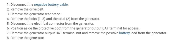

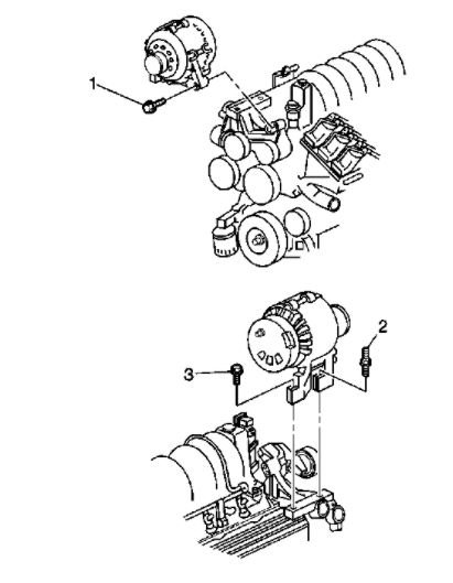

Good afternoon,
The gauge is not accurate at all. You need a voltmeter at the battery to confirm the voltage.
Never, ever take off a battery cable while the engine is running. If the alternator was a suspect, it is now bad. Then the engine will run until the voltage drops down as you need battery voltage for the alternator to work.
https://www.2carpros.com/articles/how-to-replace-an-alternator
Replace the alternator.
