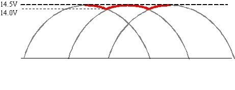

The alternator develops three-phase output, and once rectified, the pulses of output voltage are pretty smooth, but it's the battery that really smooths out that "ripple" voltage. In my sad drawing, the ripple voltage is 0.5 volt, the difference between the 14.0 and 14.5 volts. As the battery ages, the lead flakes off the plates, and the ability to smooth that ripple voltage goes away, even though that battery can still crank the engine just fine. Now the question is what voltage is the regulator going to see and respond to? Suppose the target charging voltage is 14.4 volts. If the regulator sees the 14.0 volts on its sensing wire, it's going to try to bump up alternator output to get to 14.4 volts, but in so doing, at times the 14.5 volts might go a little higher before the regulator detects that and corrects for it. You'll see that as the head light brightness flickering. The same thing happens when people disconnect a battery cable thinking that's a way to tell if the alternator is working! (Don't ever do that).
