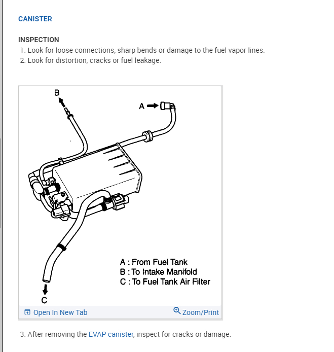

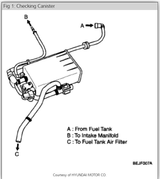

I attached the info from the manual that will show the routing of the lines.

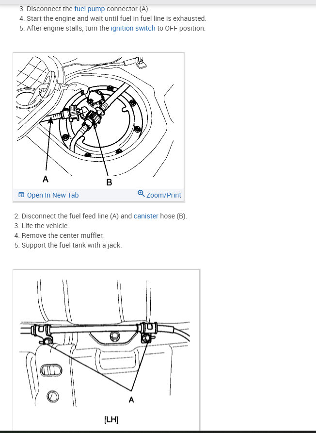

Thanks for the video but it's the wrong location for the canister. Mine is on top of the gas tank.
Nov 29, 2021 at 4:37 PM

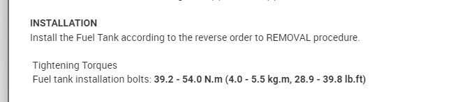

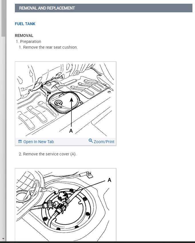

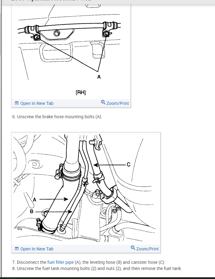

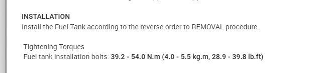

Okay. Then I attached the process to remove the fuel tank. If you cannot access it without removing the tank, then that will have to come out or at least drop it down to access it.
