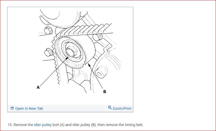

Hi Virginia,
I assume you are referring to the idler pulley due to having to take the timing belt off? If so, you may have to heat the bolt in order to get it to expand and this will break loose some of the rust that is most likely holding it in place. If soaking it did not work then heat will most likely be the best way.
