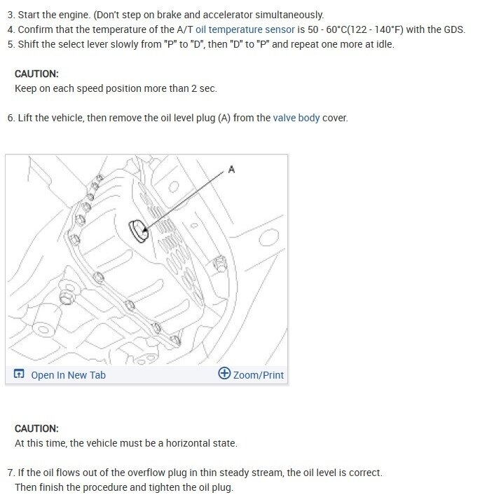

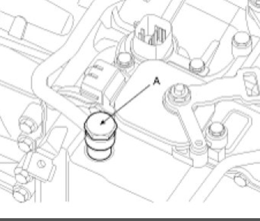

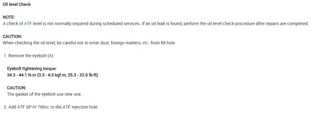

I have seen several videos some check the level with engine running others with it off, the check level plug is on side of the transmission pan. I would think car should be running but can you please check and let me know, please.
