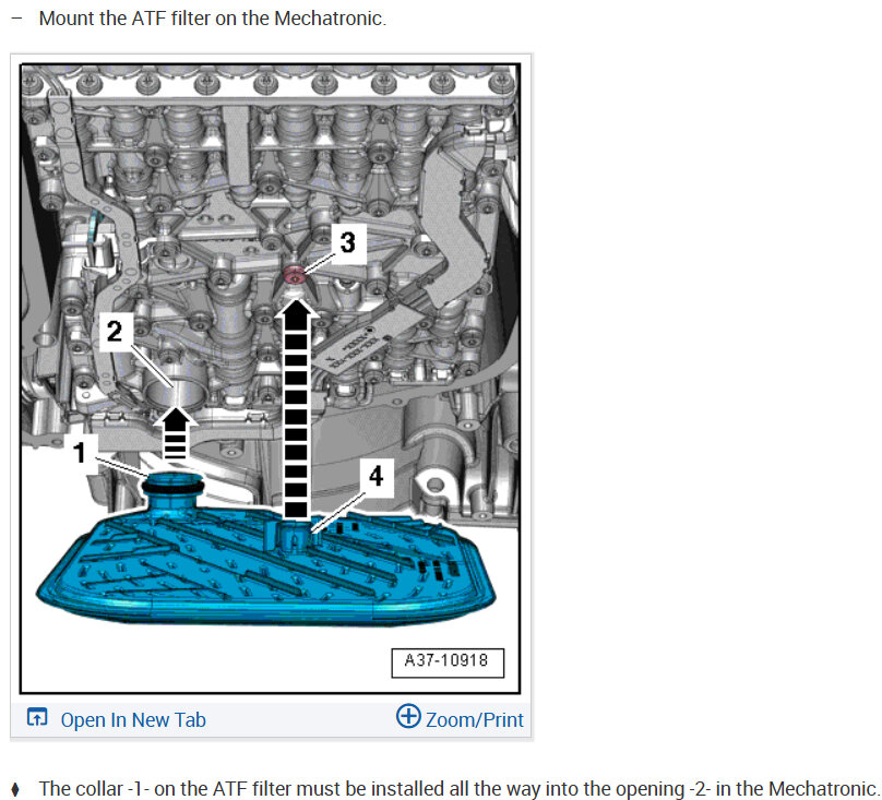

How to drain and fill transmission fluid, change filter and gasket if any on this vehicle. please.
Mar 25, 2025 at 12:14 PM
Yep, there is a filter, but you will need to remove the fluid pan. It looks pretty straight forward.
Here is a guide to help us:
https://www.2carpros.com/articles/how-to-check-and-add-transmission-fluid
ZF Lifeguard Fluid 8

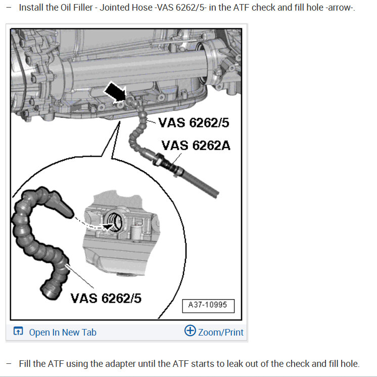

Please check the information int he images below.

cool, so just drain and fill till it comes out without needing to get it to specific temperature then check again?
Mar 27, 2025 at 11:27 AM
You need to warm the engine up until the cooling fans come on, then the temperature is correct. Fill until the fluid comes out and install the plug.

With engine off.
Mar 28, 2025 at 10:11 AM
?? the engine must be running.
Mar 28, 2025 at 10:14 AM
BHAMDOC1973
  • 2,008 POSTS
I am asking if engine should be off or running after it gets to temperature and then fill.
Mar 28, 2025 at 10:26 AM
Running.
