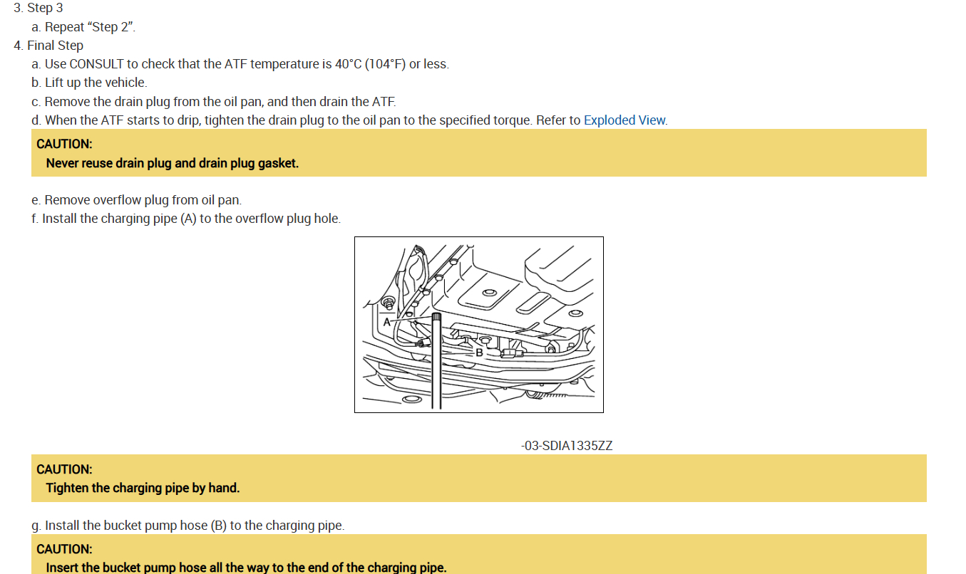

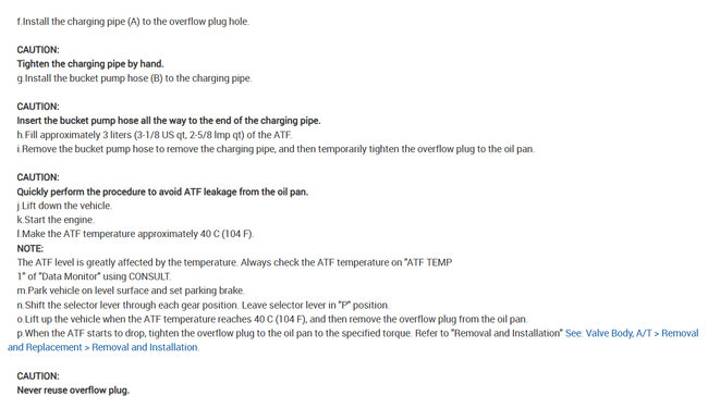

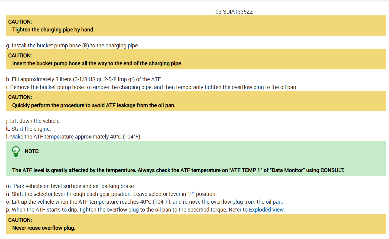

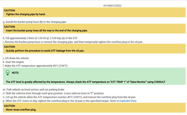

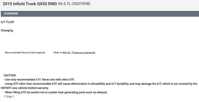

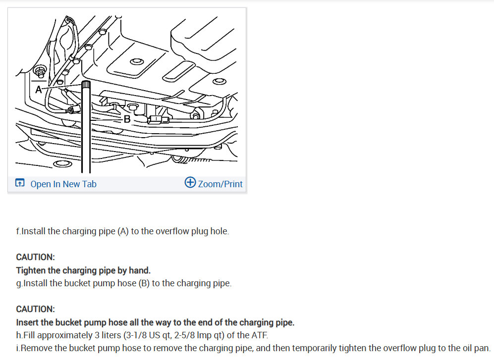

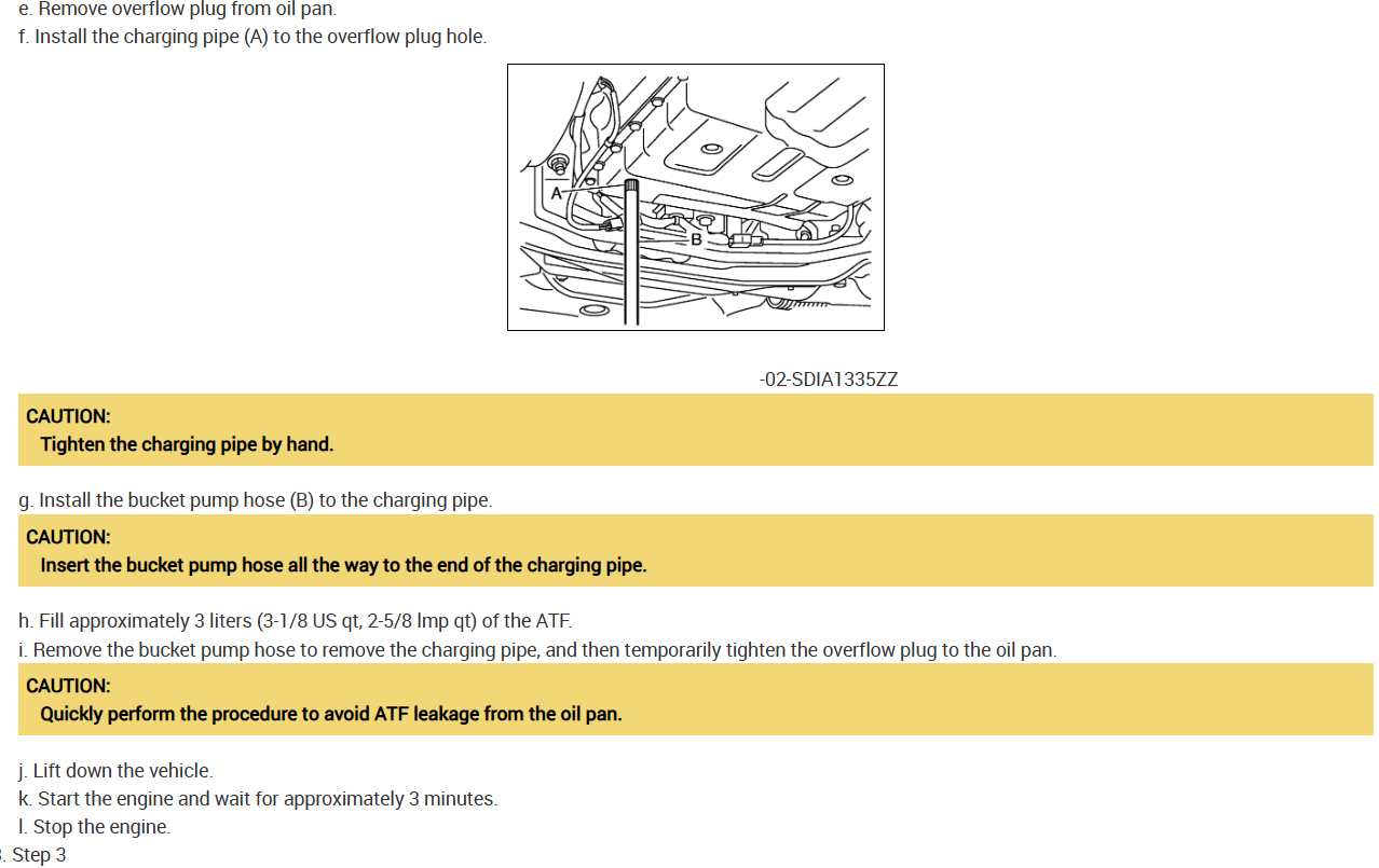

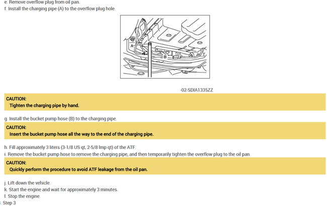

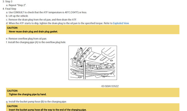

Sure, here are the instructions on how to change out the transmission fluid, it looks like you will need:
Type .................... Genuine NISSAN Matic S ATF
I would not use anything else but tis fluid.
Capacity* .................... 9-3/4 qt (9.2L)
You will need to have a scanner to check the fluid temperature to make sure it is warm enough to obtain the correct fluid level. Check out the images (below). Let us know how it goes.

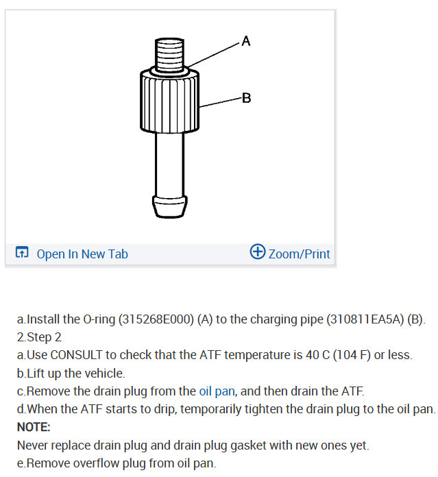

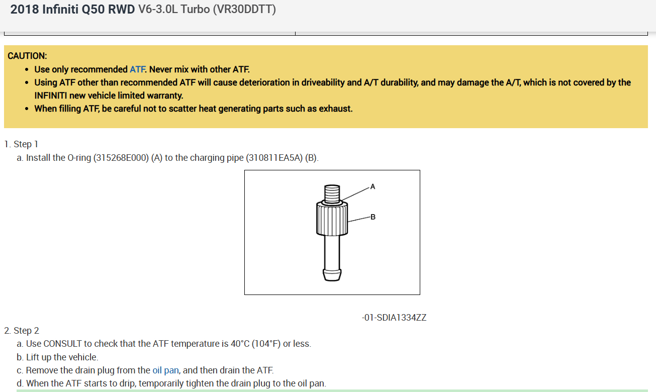

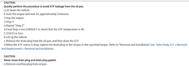

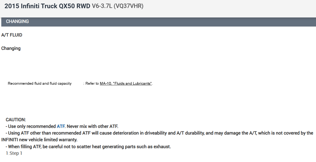

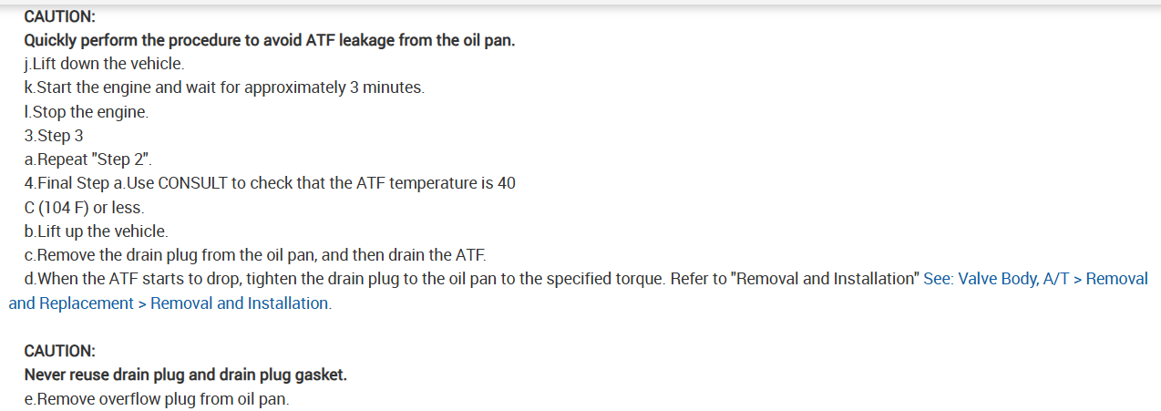

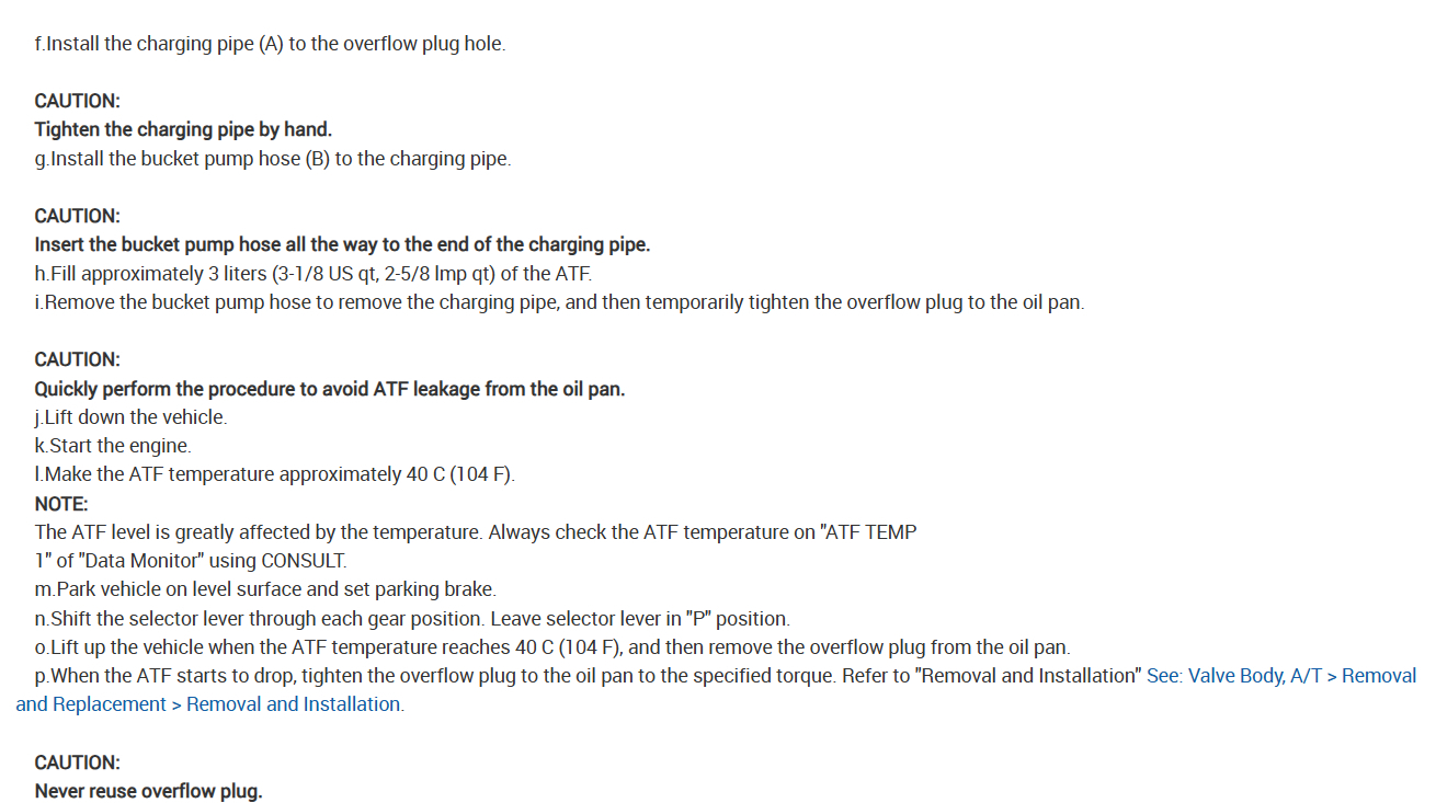

Is it the same for the 2018, cause the instructions are for the 15 model with 3.7, what I have is an 18 with3.0T
Apr 29, 2025 at 12:15 PM
Hmm, sorry about that. It does look the same so I think you are safe, here are the instructions for the 2018 model. Check out the images (below).
