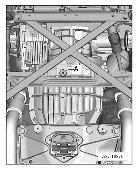

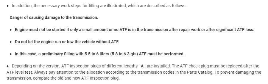

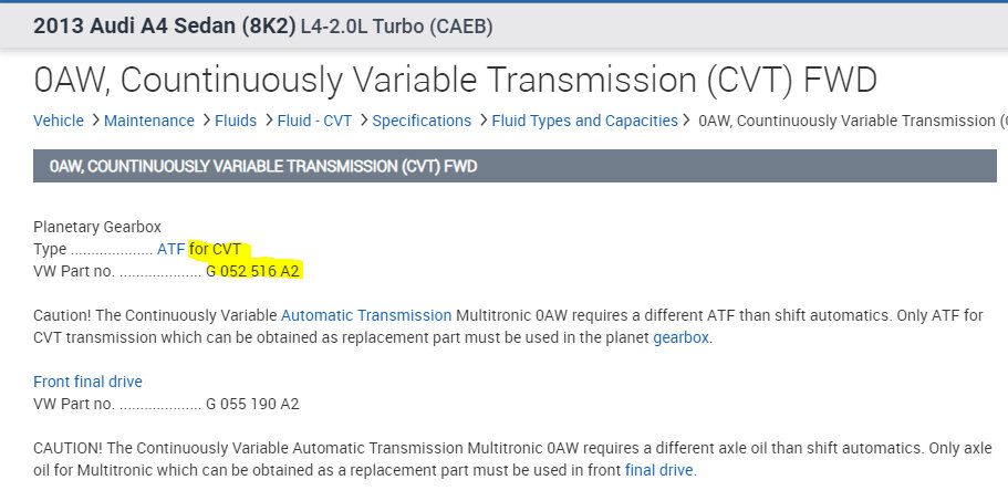

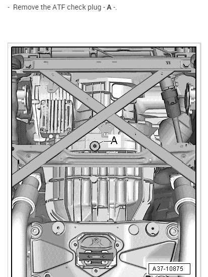

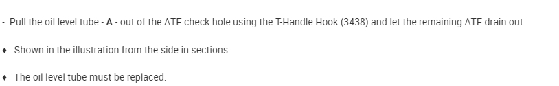

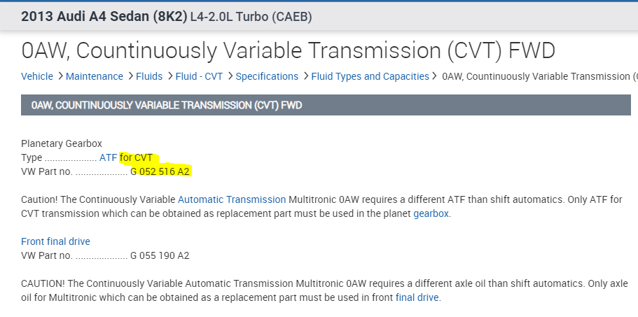

The vehicle listed above is a front wheel drive, 2wd, I need to know the procedure for replacing the CVT fluid and the type and capacity of fluid for a drain/fill. Please
Aug 3, 2023 at 1:31 PM

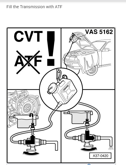

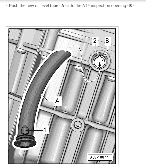

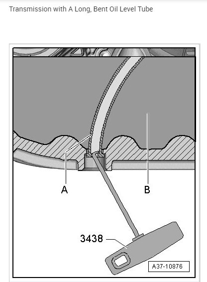

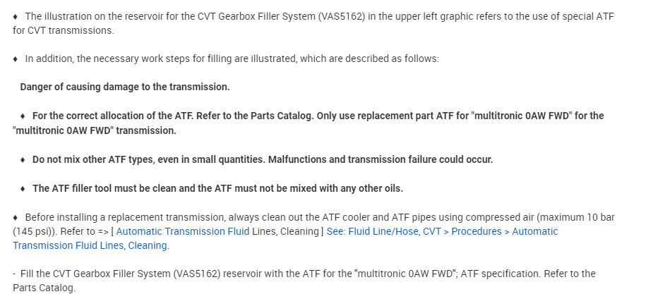

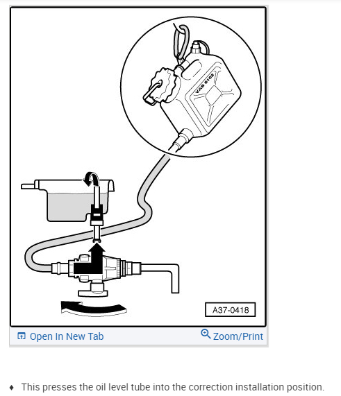

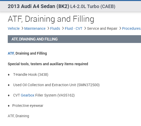

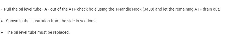

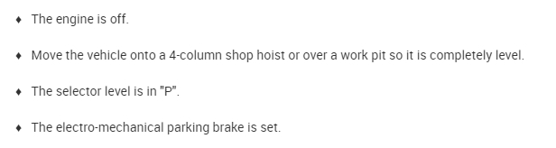

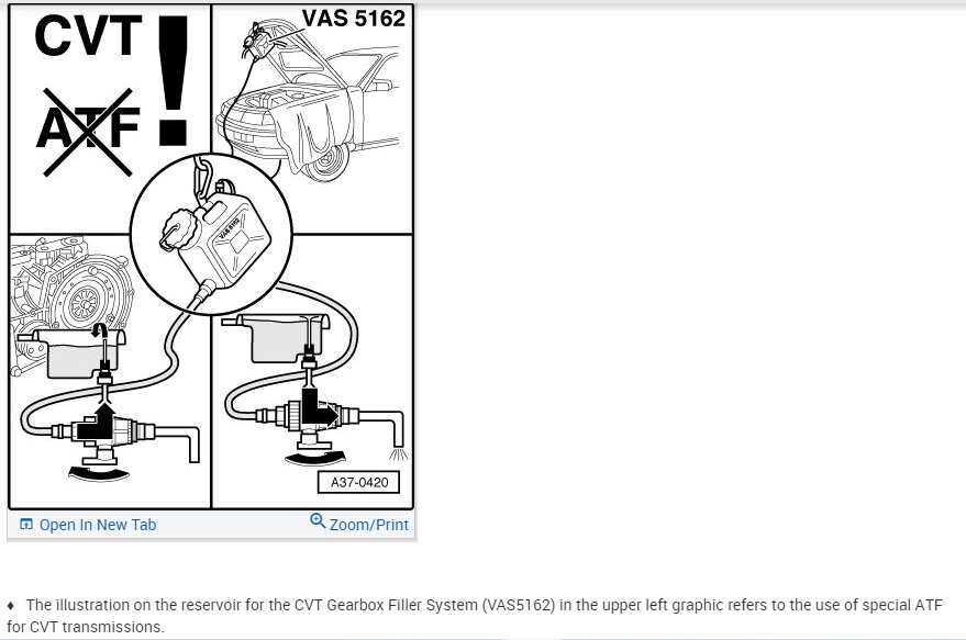

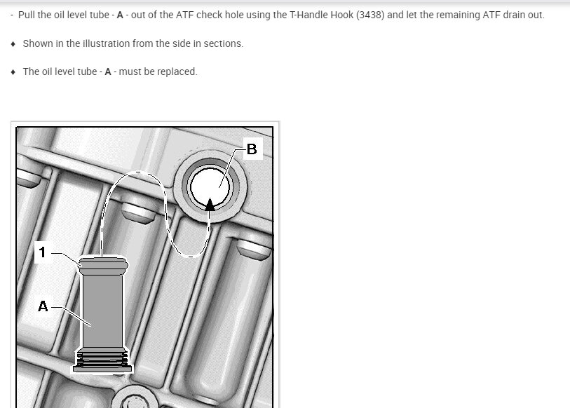

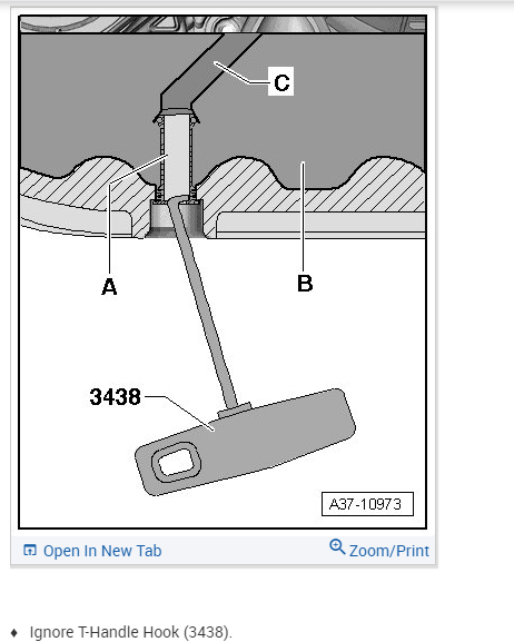

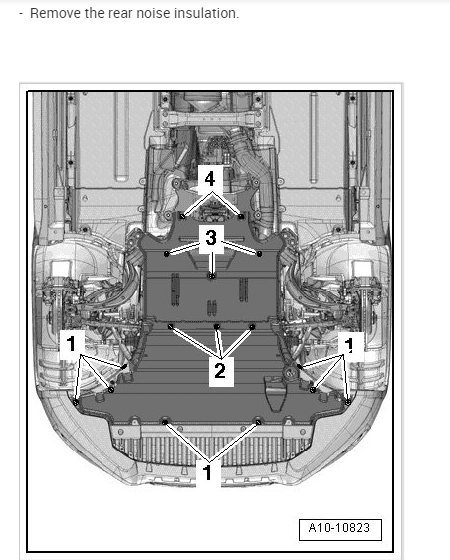

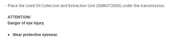

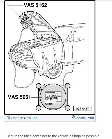

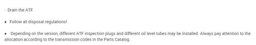

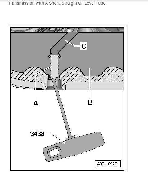

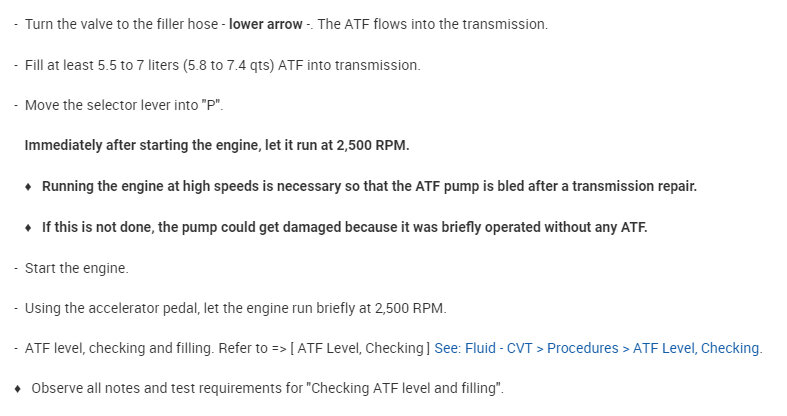

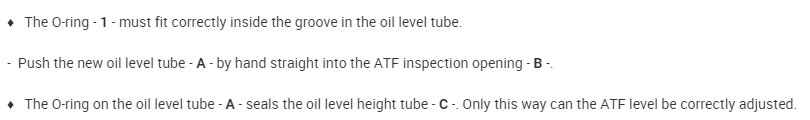

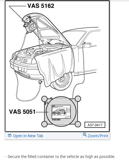

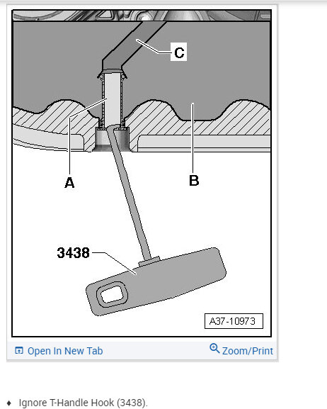

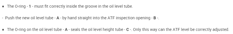

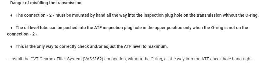

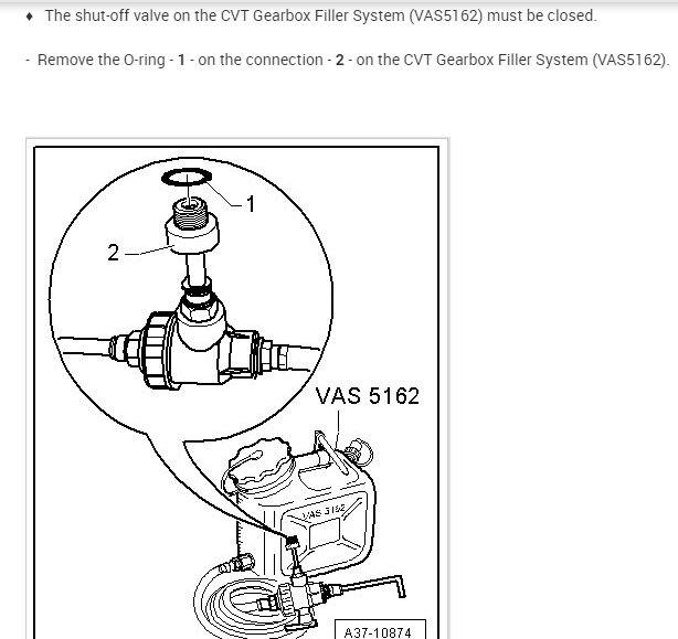

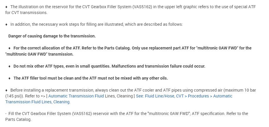

I attached the directions below for draining and refilling the FWD, CVT transmission. Take a look through them and let me know if you have questions.

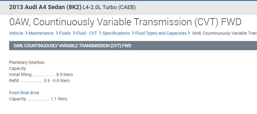

Also, the last two pics are the fluid specifications and quantities.
Let me know if this helps.
See pics below.
