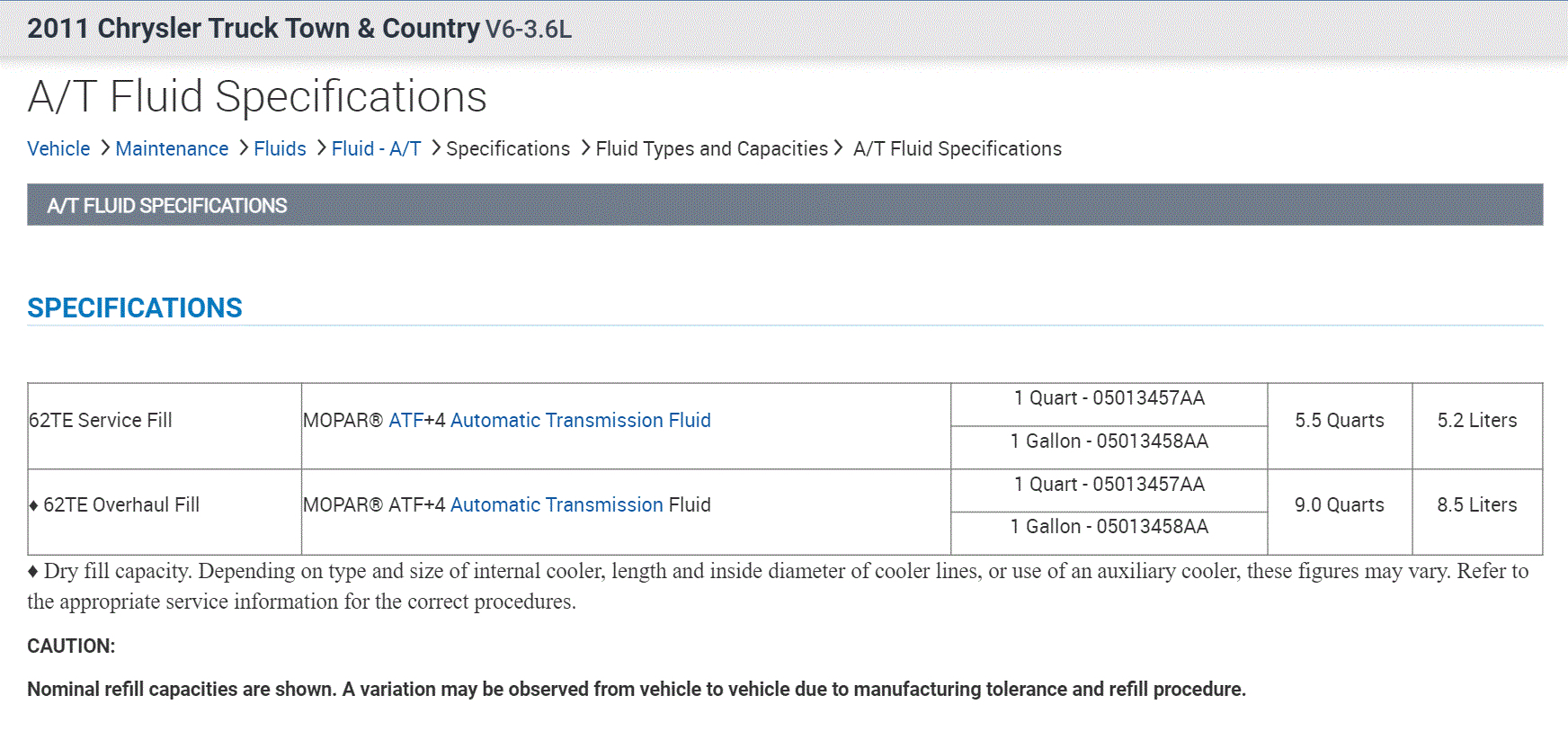

I have attached the specifications below. Note the service fill is with a new transmission filter installed. What I recommend is to add approximately four quarts, start the engine, shift through the gears, allow the engine to reach operating temperature, and then check the level and fill as needed.
See pic below.

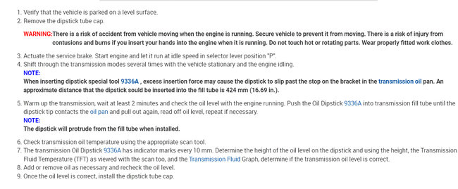

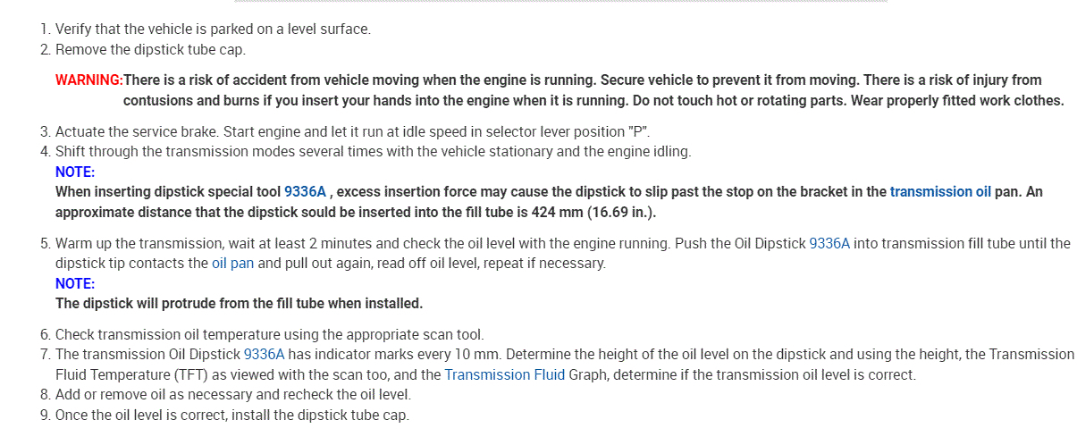

I attached the directions for testing right from the manual. Take a look through them and let me know if you have questions or if it helps.
See pic.
