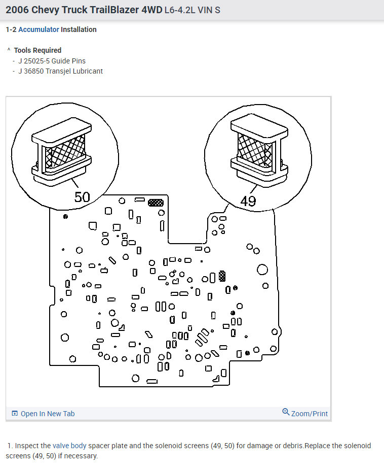

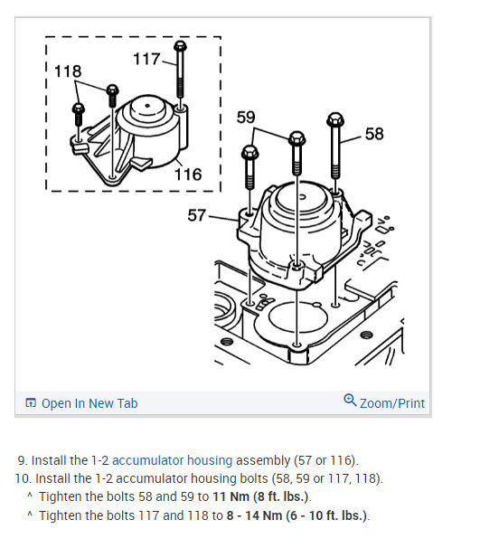

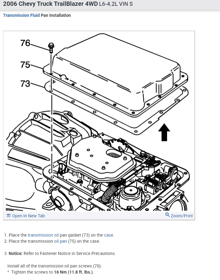

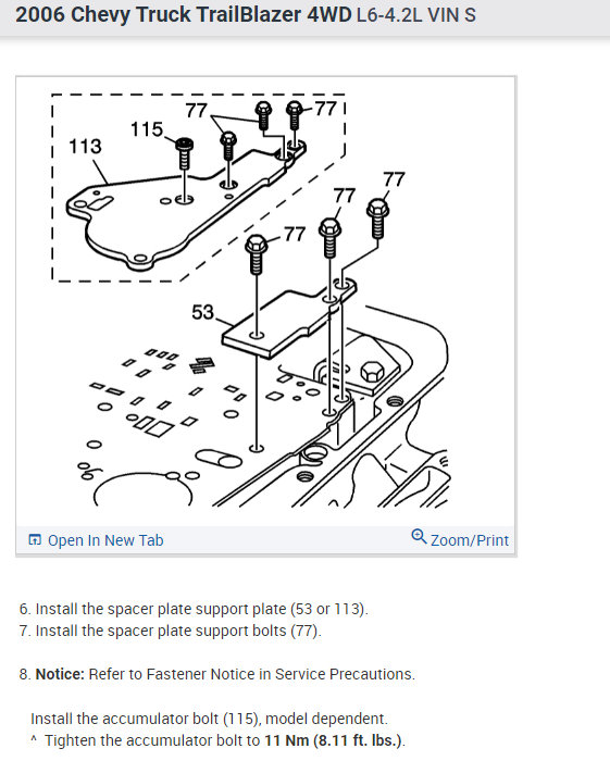

Question 2. I need ("the exact torque") for the 3 accumulator bolts and all of the oil pan bolts (in ft pounds please) my wrench starts at 10 lbs standard...
Question 3. The pan and all the mating surfaces are nearly pristine, and the pan and gasket came right off with almost zero scraping. I'm generally opposed to using sealant glues if it's not absolutely necessary. I wonder if I should use some or not.
