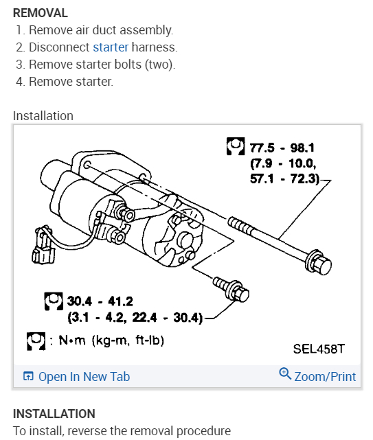

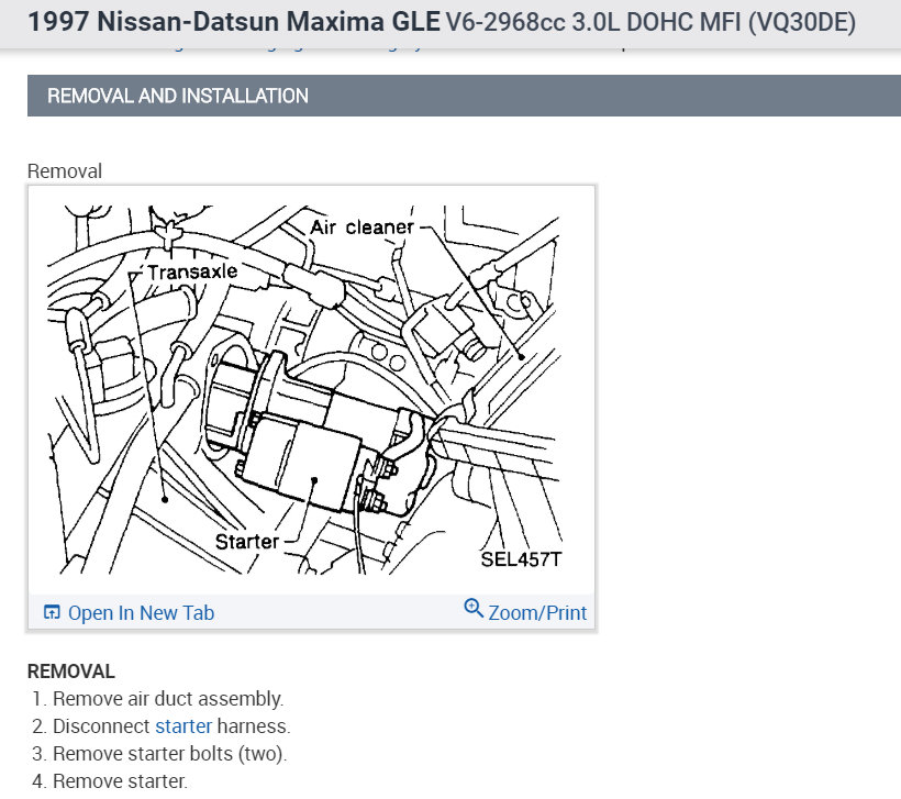

What size wrench takes the starter out?
Oct 2, 2018 at 1:23 PM
The sizes are 14mm for the main bolts, but you must disconnect the battery first. Here is a guide that will work you through the repair and diagrams below to show you how it will be for your car:
Check out the diagrams (below). Please let us know if you need anything else to get the problem fixed.
