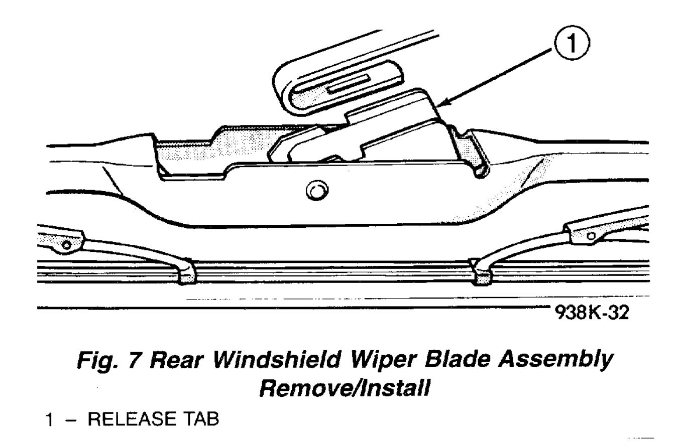

Do you have a video showing how to change the rear window wiper blade on a PT Cruiser?

We dont have a specific video for each vehicle to show you how to change them.It should just be a little clip you push in then slide it out of the loop in the arm. They dont all lift up like the fronts.
Theres a picture attached below that shows how to get the blade off the arm
