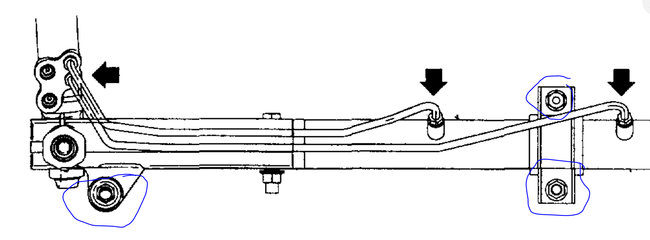

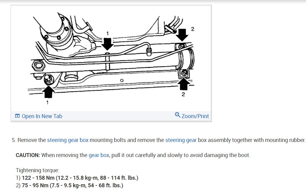

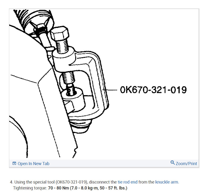

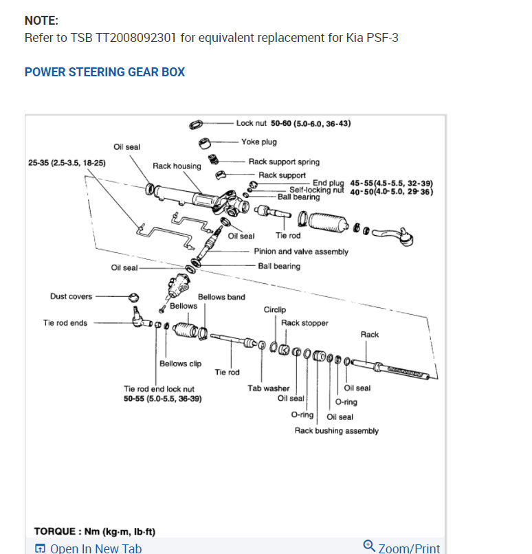

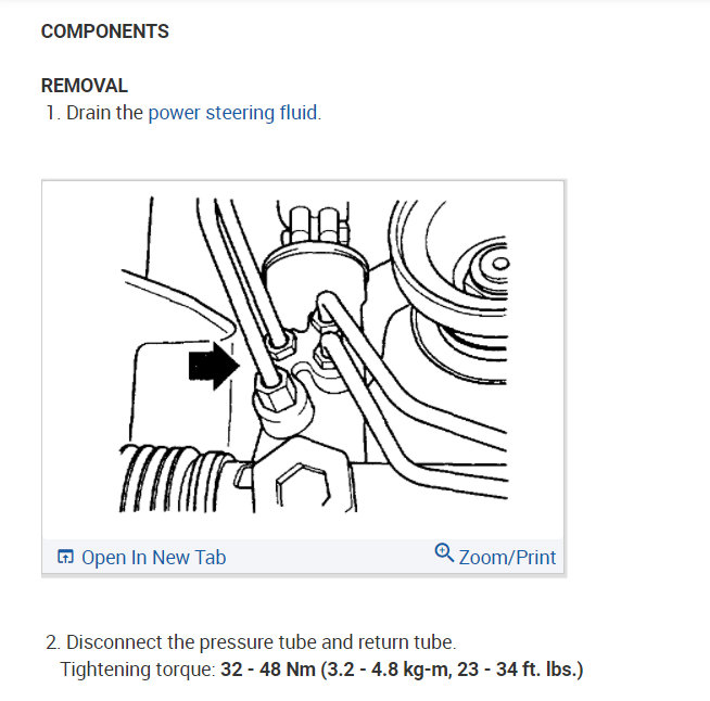

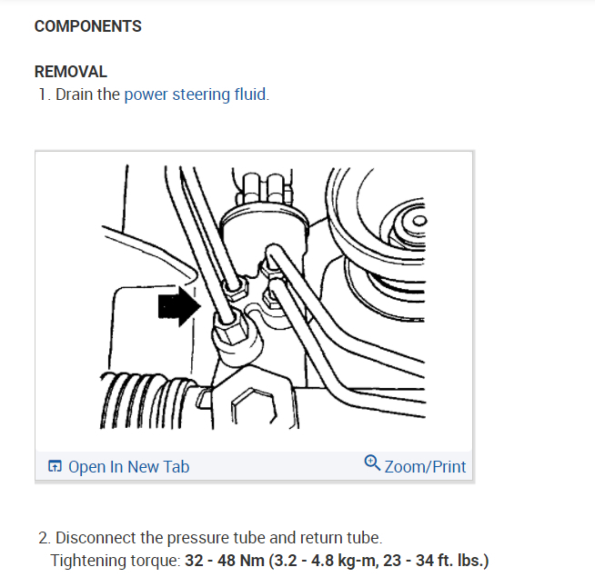

We took our vehicle to the shop and they told us the rack and pinion needed to be changed. My husband is attempting to do that but having challenges. Do you have instruction/diagrams on the process?
