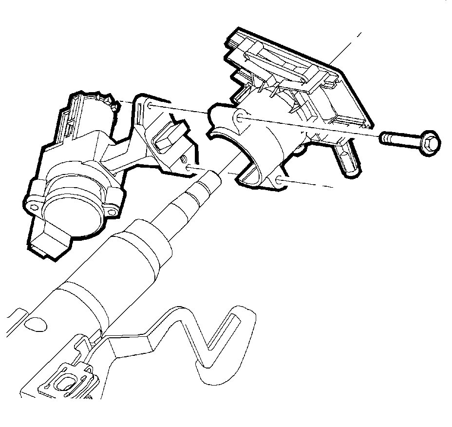

4. Remove the multifunction levers.
pic 1

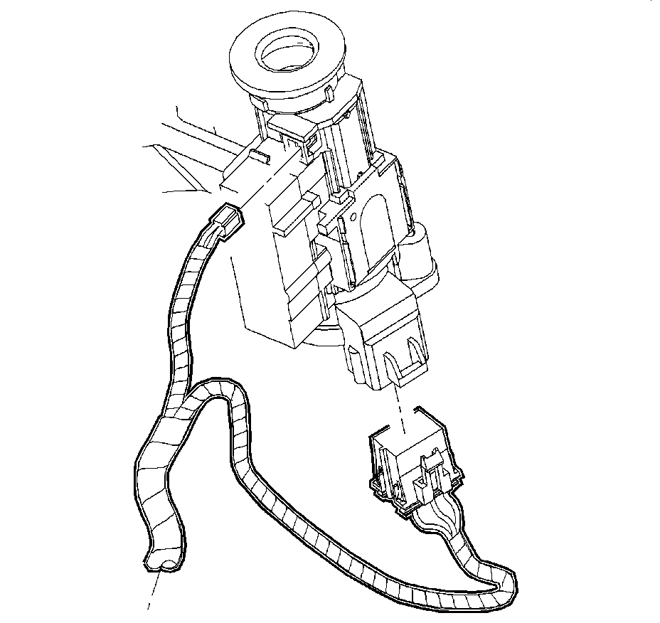

5. Disconnect the housing electrical connectors.
pic 2

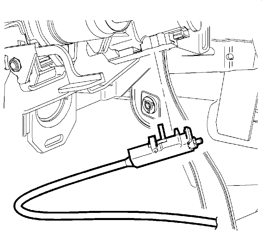

6. Disengage the retaining tabs and remove the park lock cable assembly from the housing.

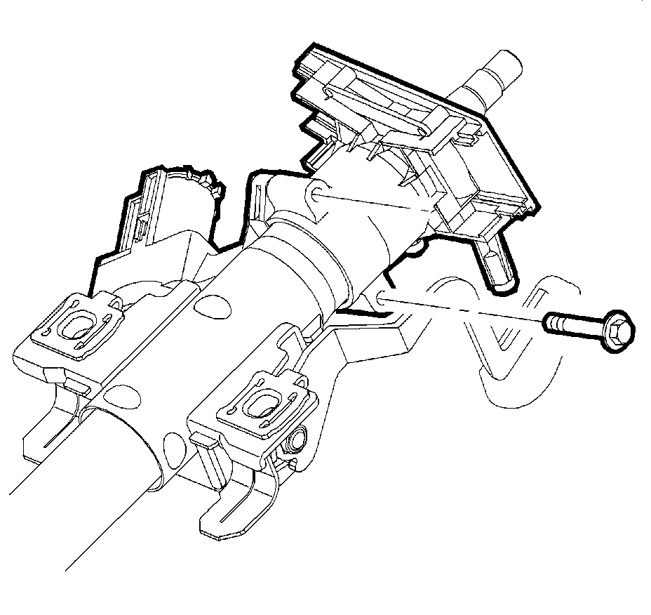

7. Remove the lock housing bolts.
8. Turn the ignition key to the ACC position.
pic 3
9. Separate the lock housing (lock cylinder case) from the multifunction lever bracket. Slide the bracket from the column.

8. Snap the ignition lock cable onto the ignition module.
pic 6

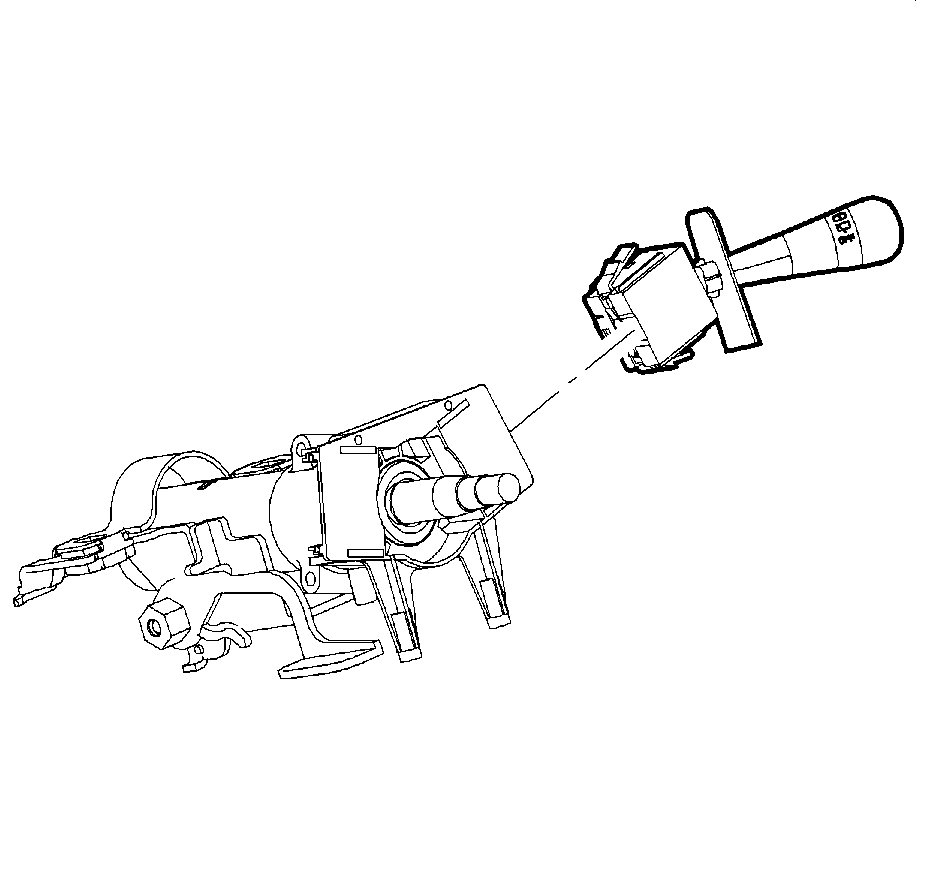

Install the multifunction levers.
