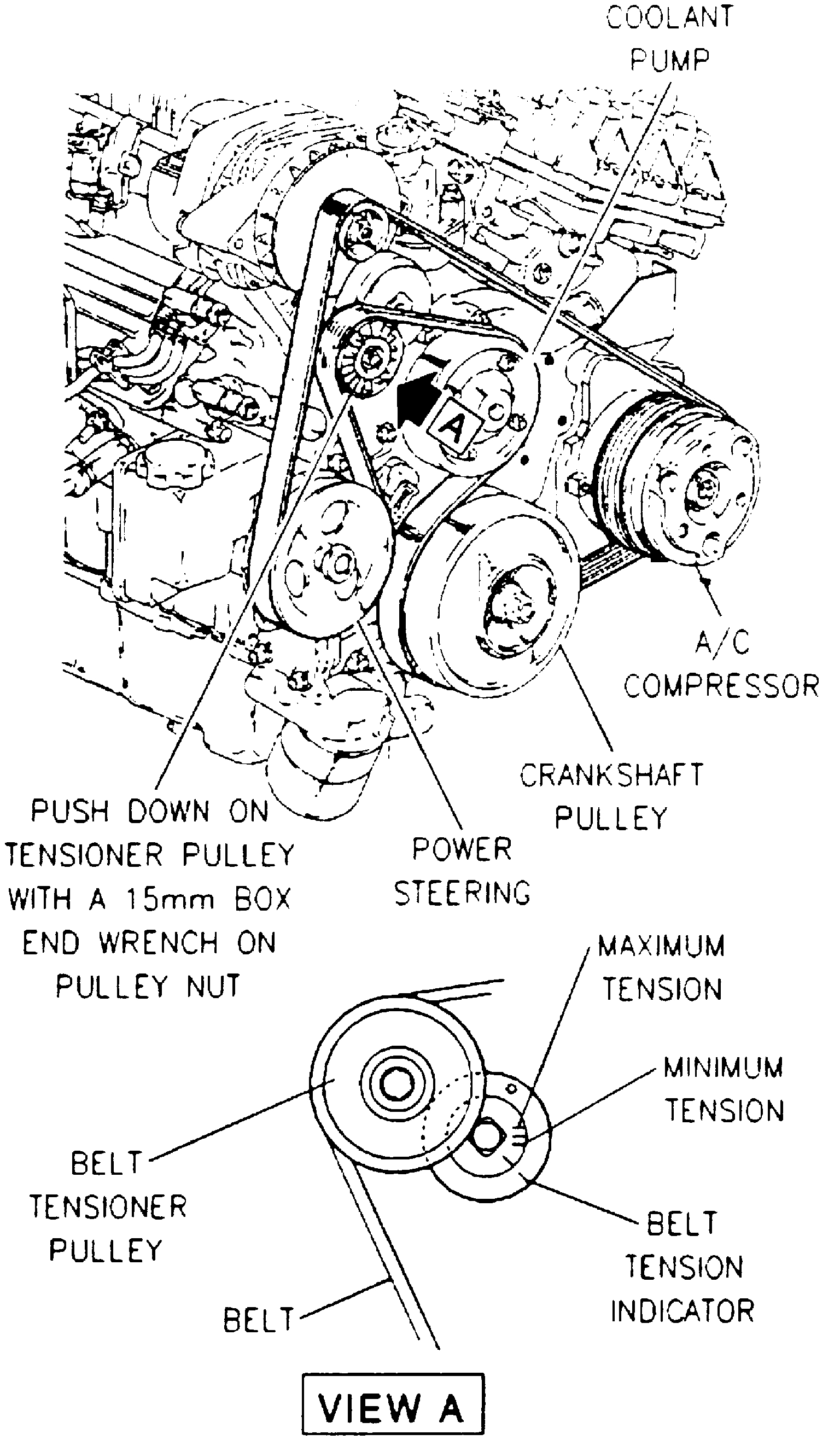

I'm not sure what spacer you are referring to. However, I don't believe a motor mount needs to be removed, so you shouldn't have to support the engine.
If you look at the attached pic, move the tensioner in the directions indicated to release pressure from the belt. Then you can remove it.
