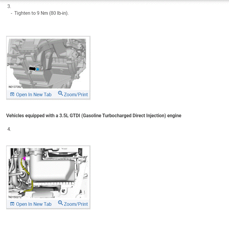

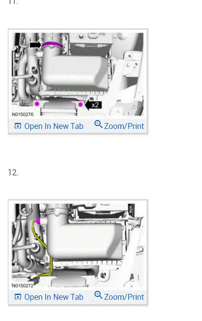

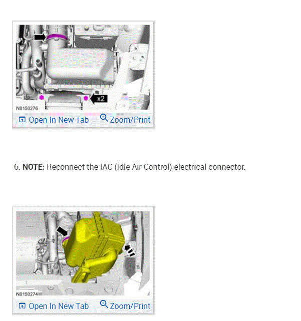

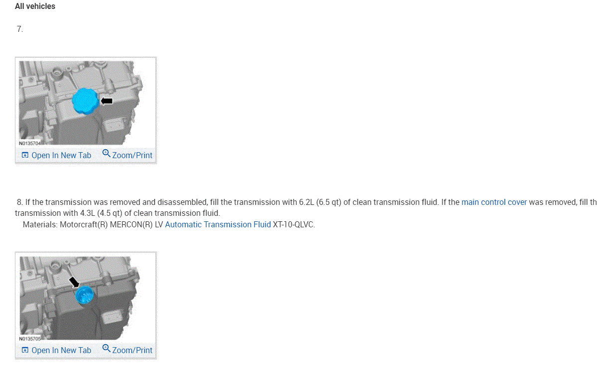

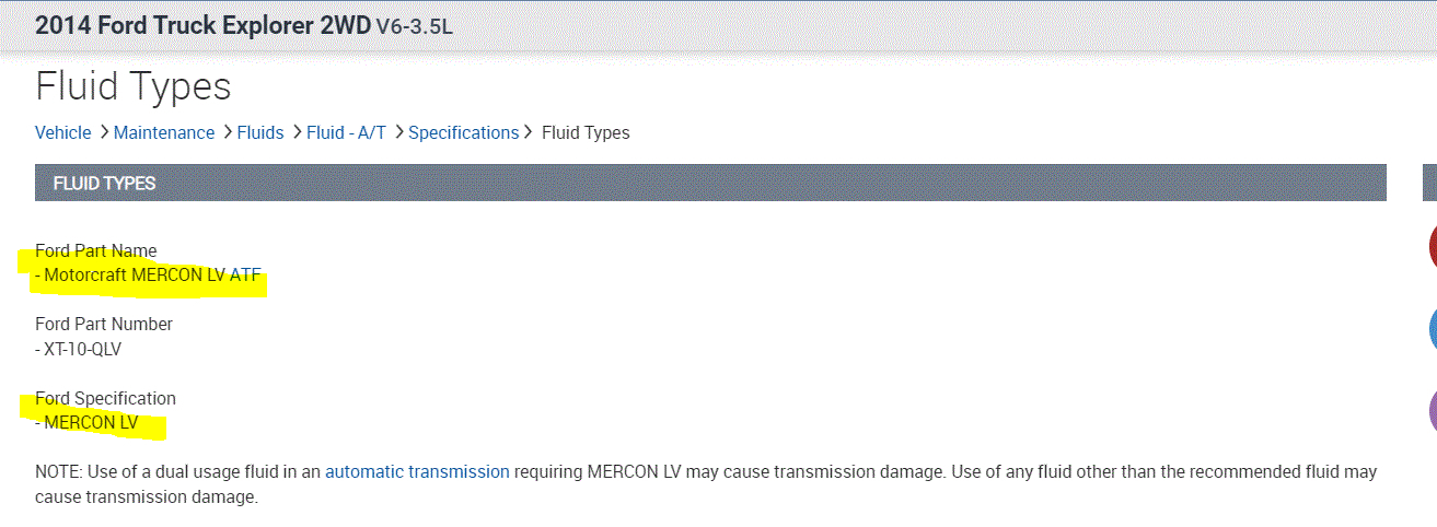

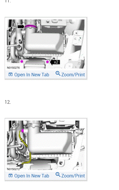

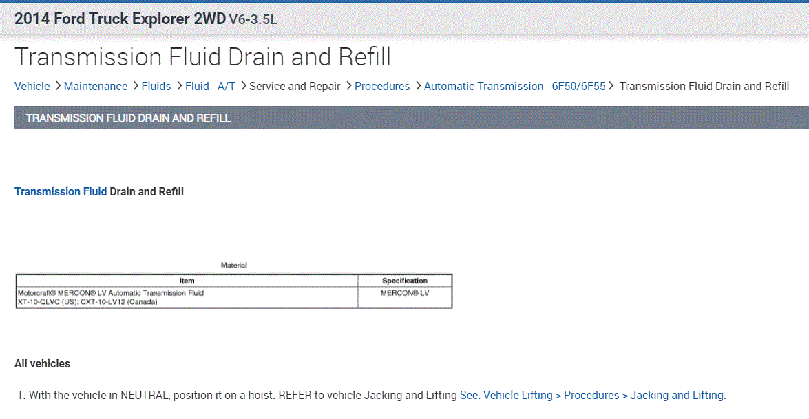

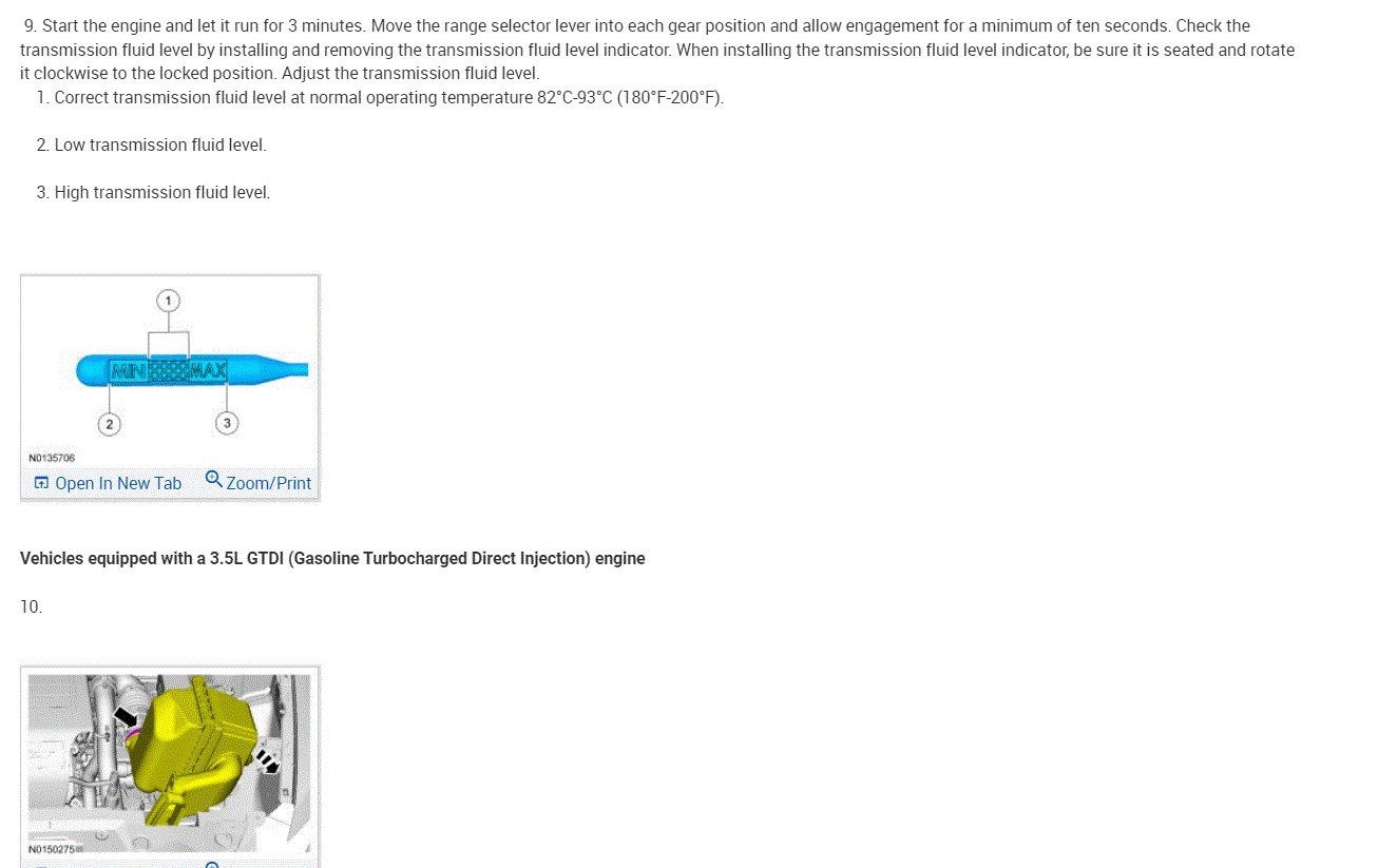

When testing the fluid level, the engine needs to be running at operating temperature, and the transmission in park.

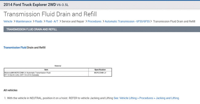

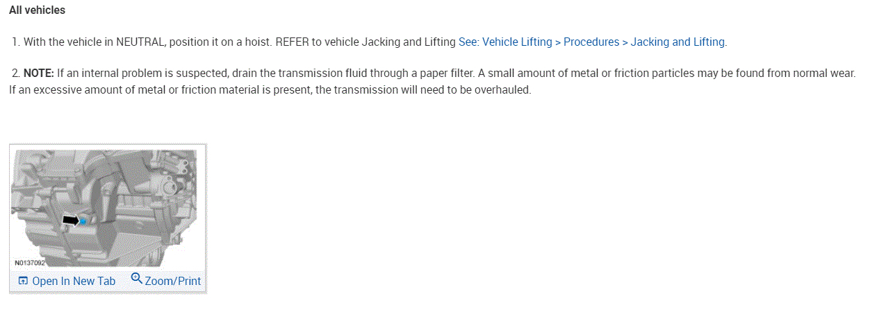

If you look below, I provided the fluid type and the drain and fill procedures, which include how to check the level. (Pic 1)
Here is a link as well that you may find helpful:
https://www.2carpros.com/articles/how-to-check-and-add-transmission-fluid
It should be around four quarts for a drain and fill. Start with three and add as needed.
