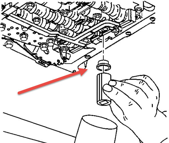

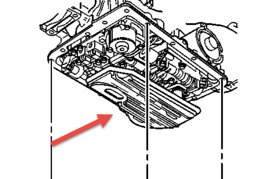

I changed gear oil and filter in my 2004 Envoy and now no fourth gear. First, second and third are okay, just no fourth gear.
Can you guide me please?

recheck your work you may not have put the seal for filter in right or filter and it is sucking air. See pictures.
