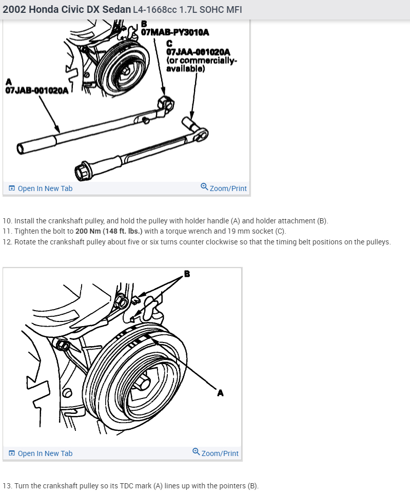

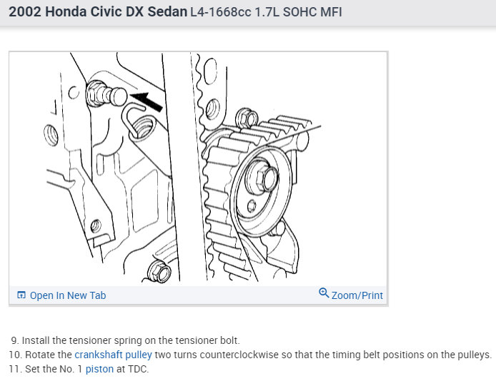

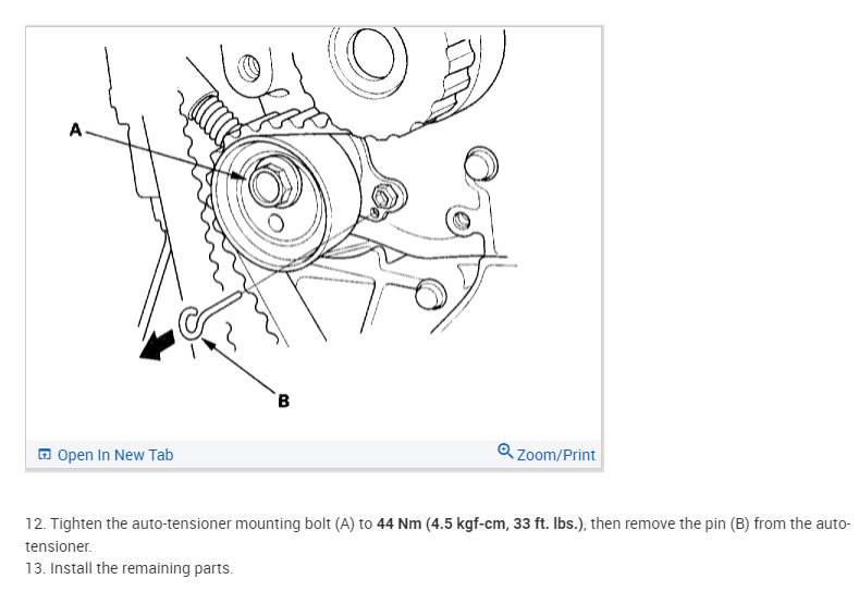

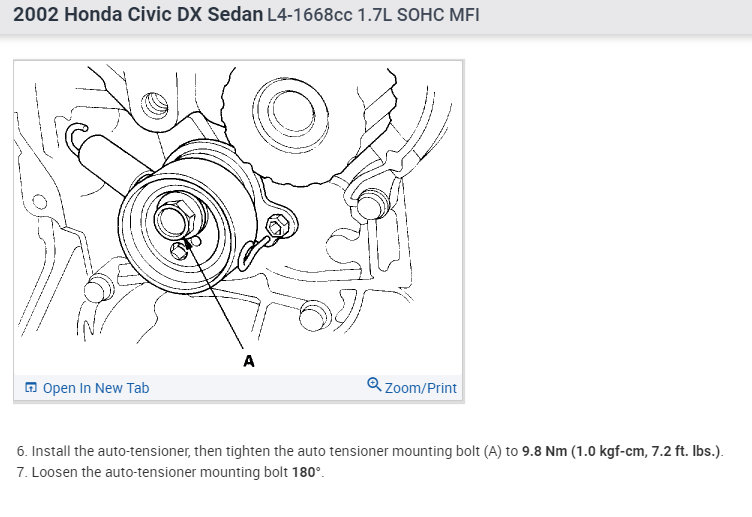

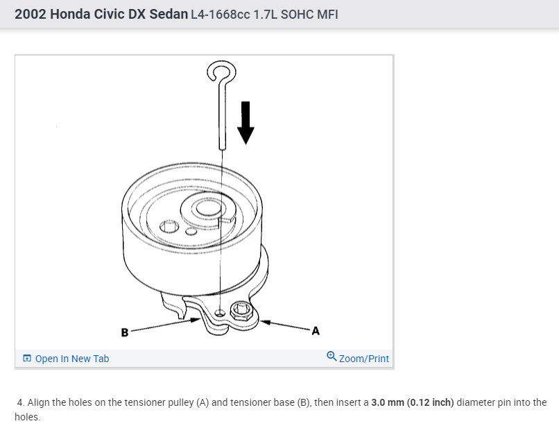

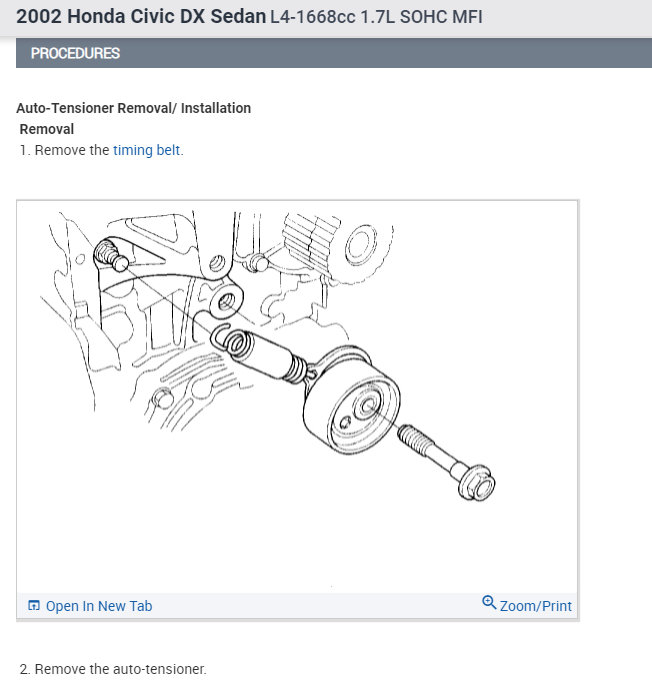

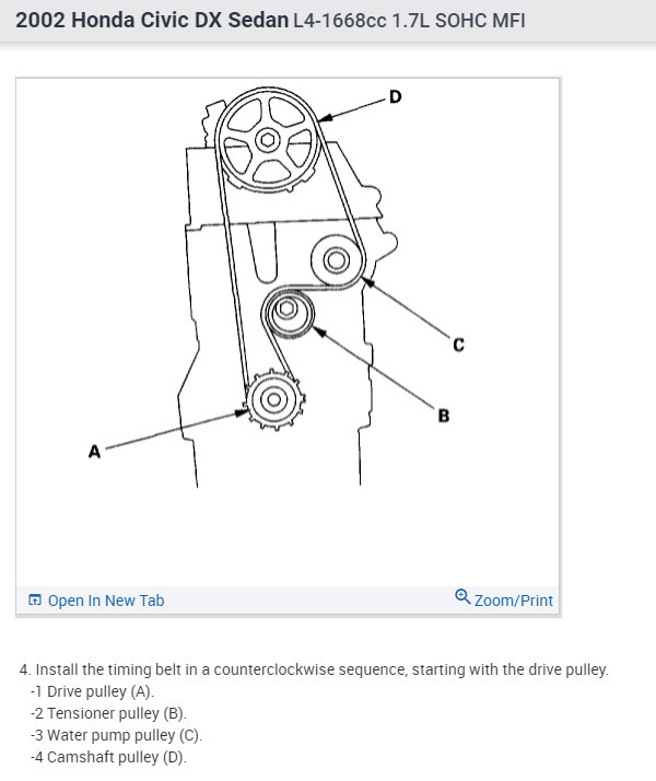

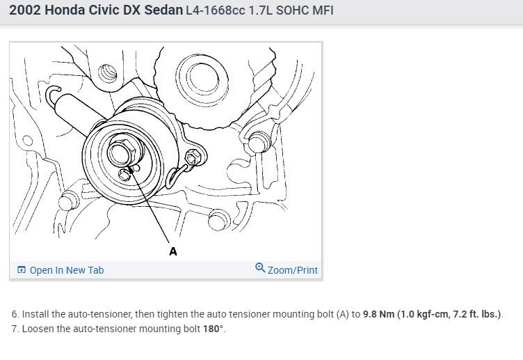

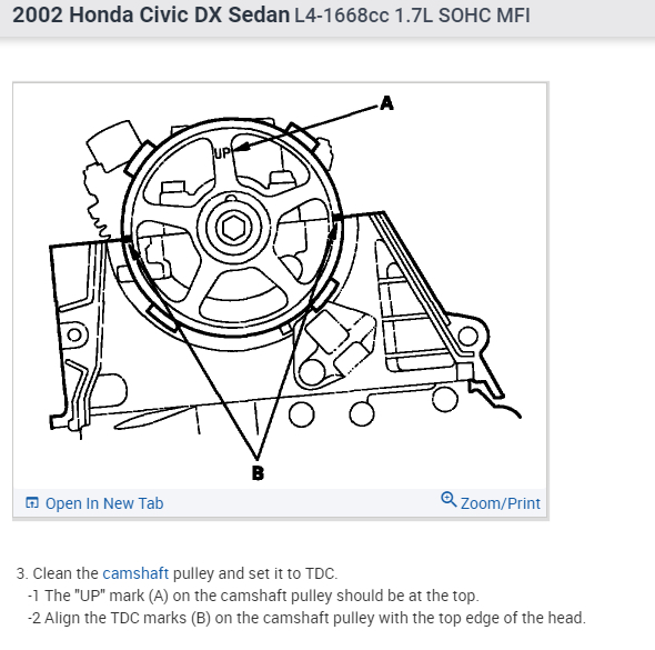

I did a head gasket and timing belt with water pump and tensioner. I started it and ran fine. shut off and started again but belt jumped two teeth on belt. Why did I do something wrong on the tensioner?
