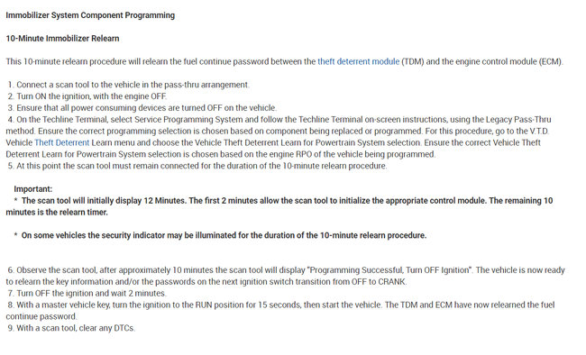

Yep, the black ring is part of the immobilizer so you need that. also if the Chevrolet dealer didn't code the key correctly it will not run. To be sure lets do a CAN scan which is the future of automotive repair. you can get a CAN scanner from Amazon for about $50.00. here is a video to show you how:
https://youtu.be/InIlnsjOVFA

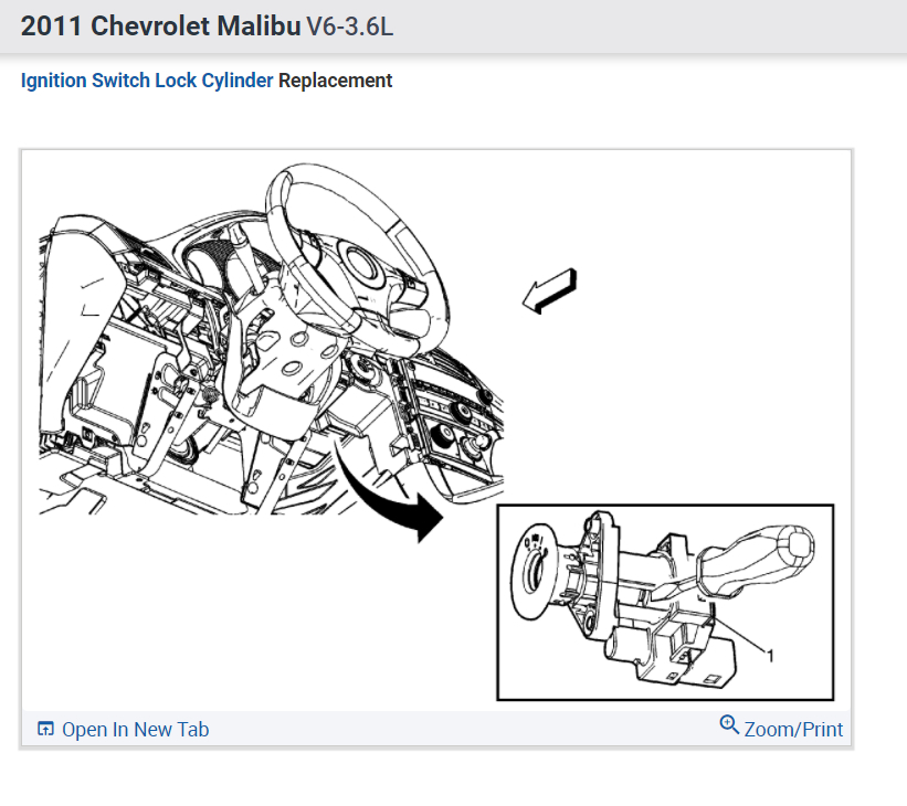

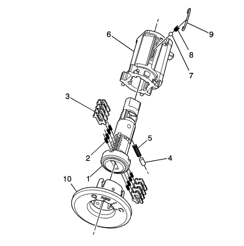

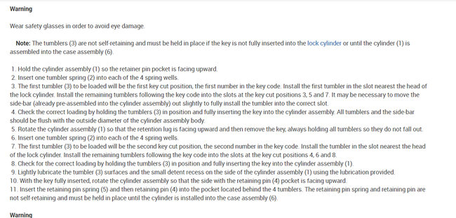

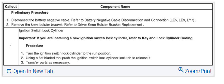

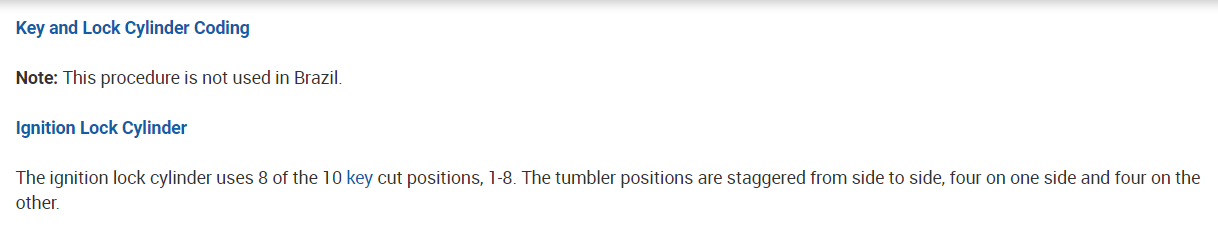

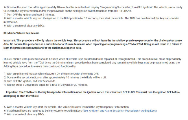

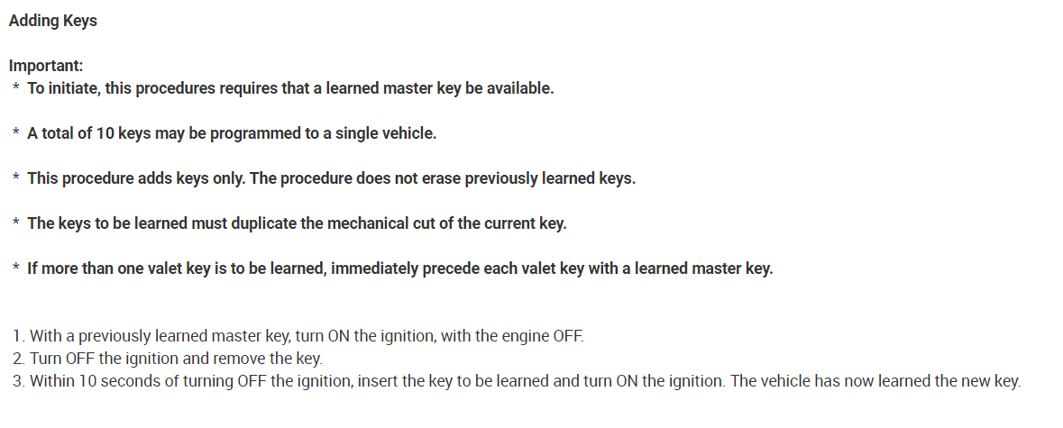

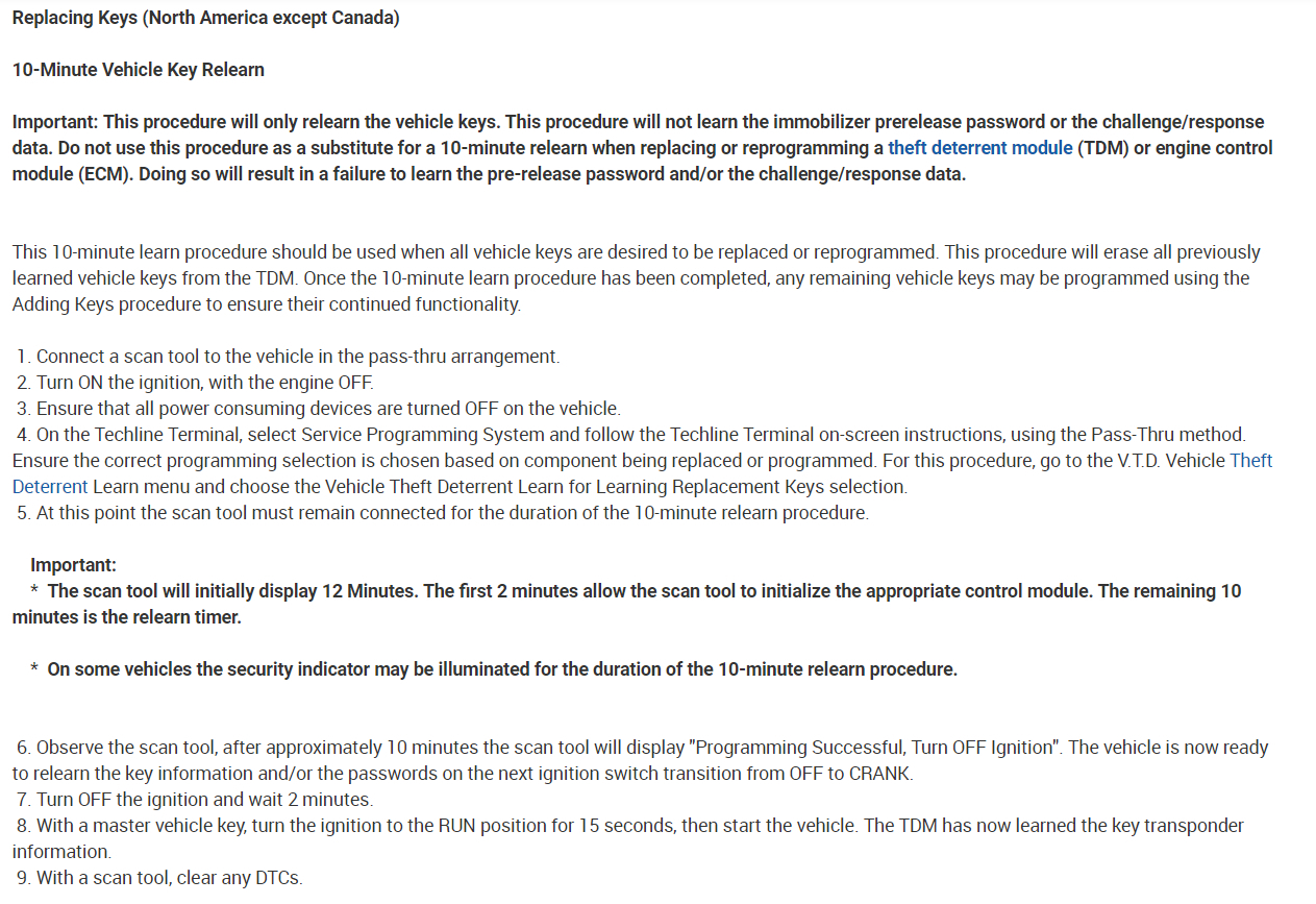

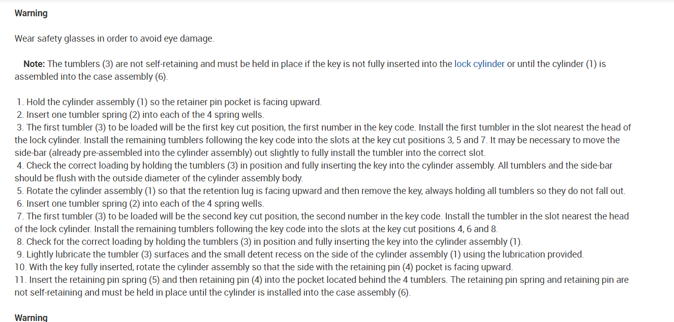

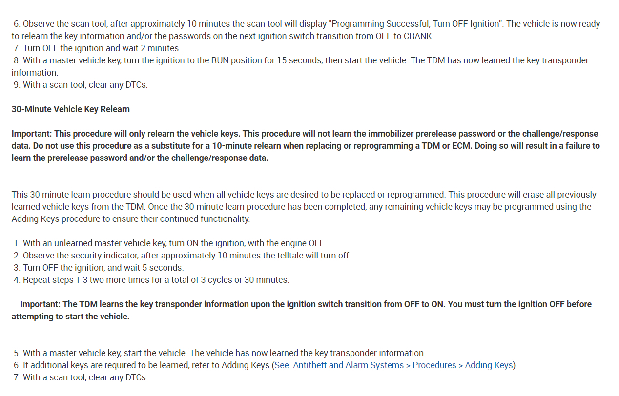

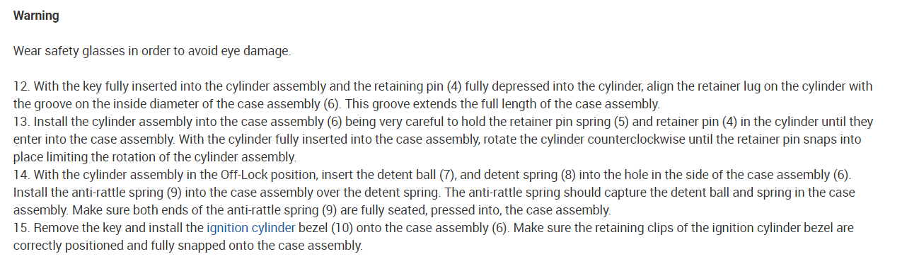

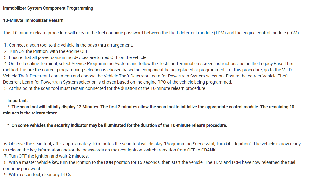

Also here is the instruction for the ignition key and tumbler to make sure they did their job correctly. Check out the diagrams (below). Let us know what happens and please upload pictures or videos of the problem.
