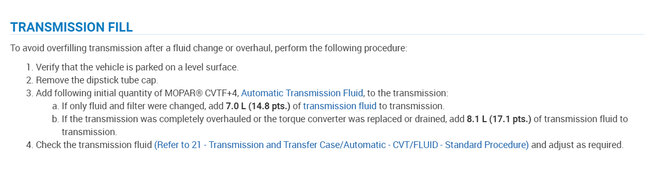

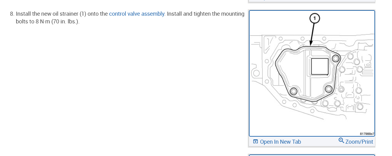

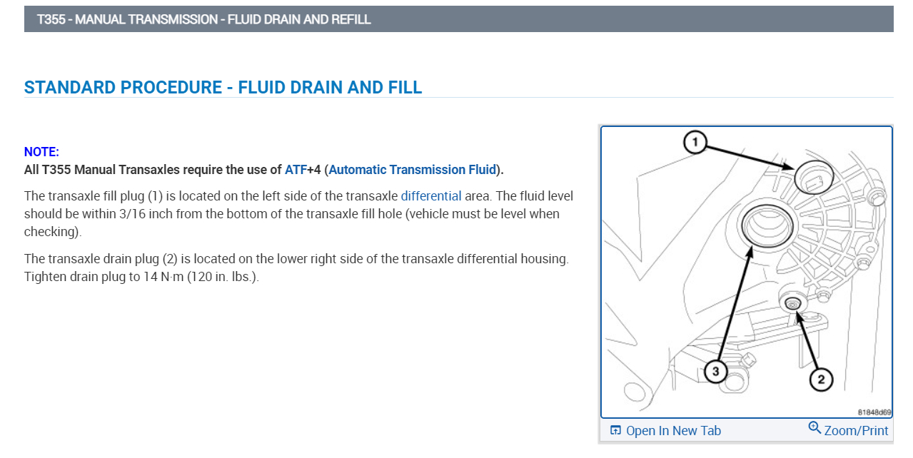

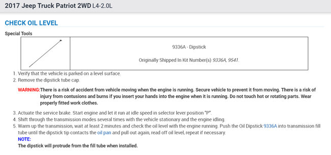

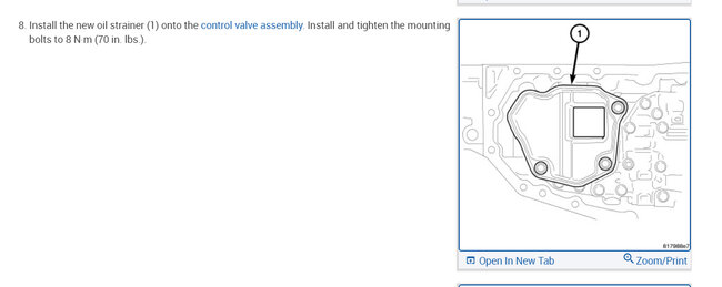

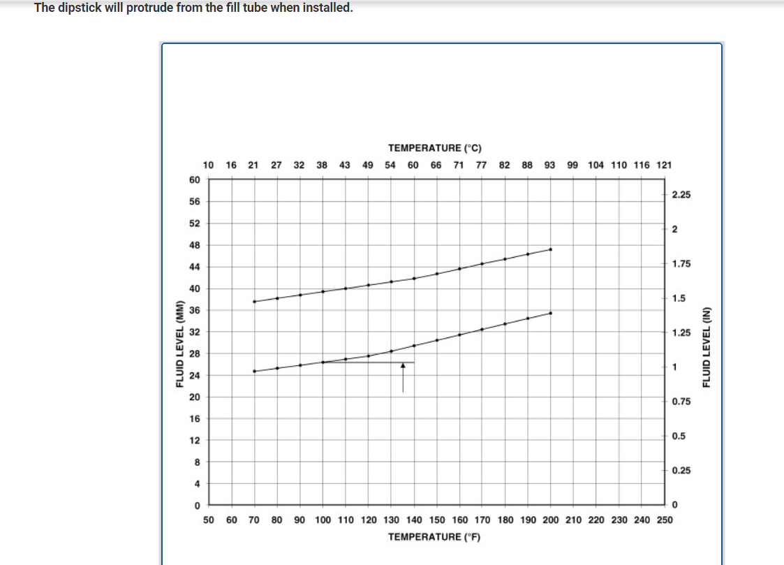

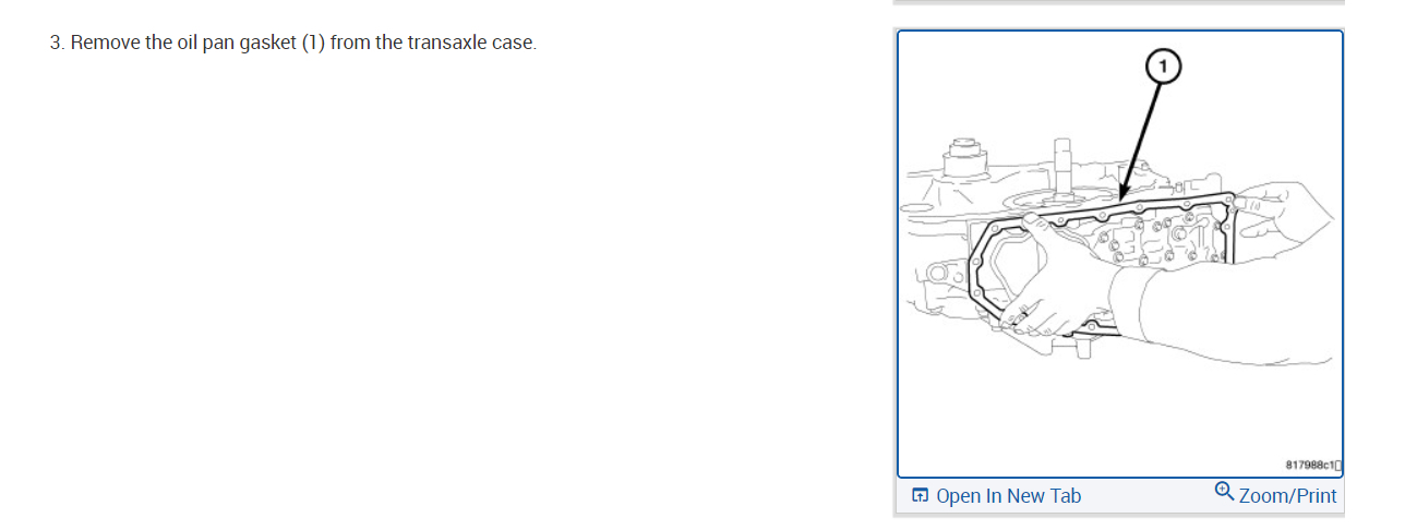

Hi Melissa,

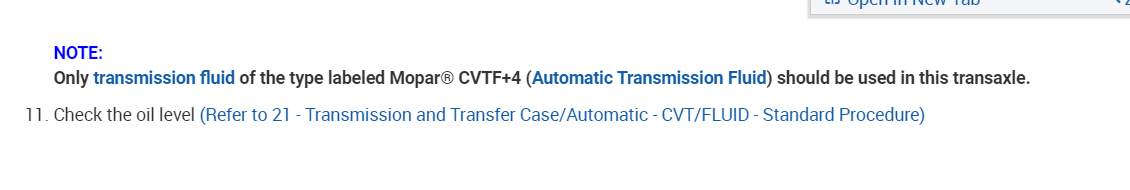

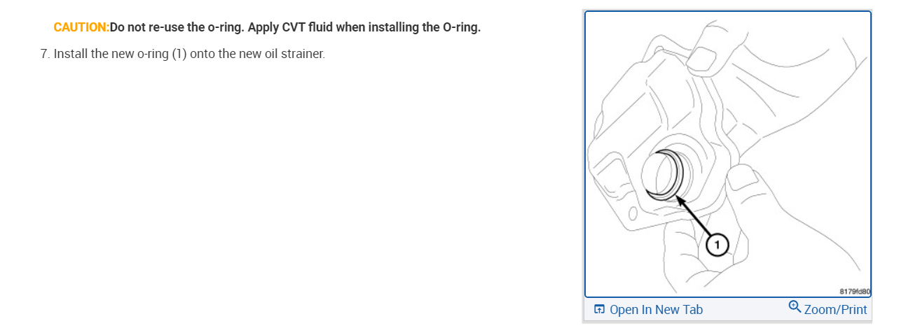

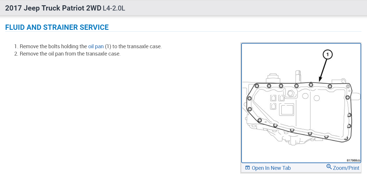

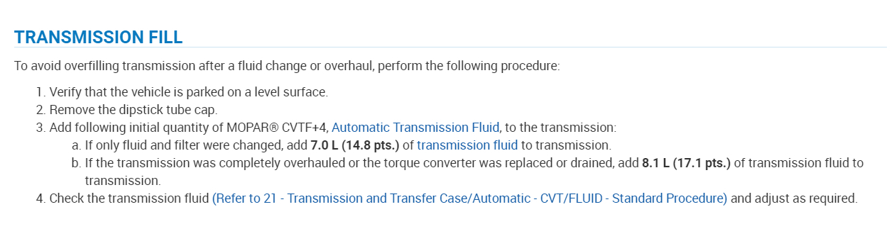

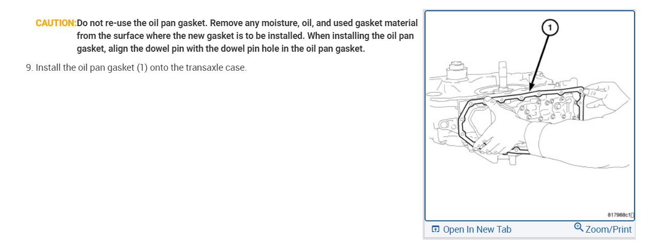

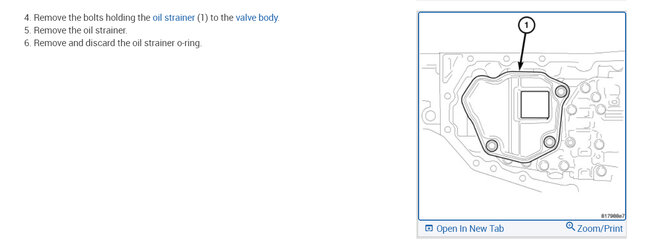

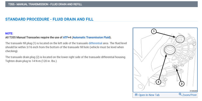

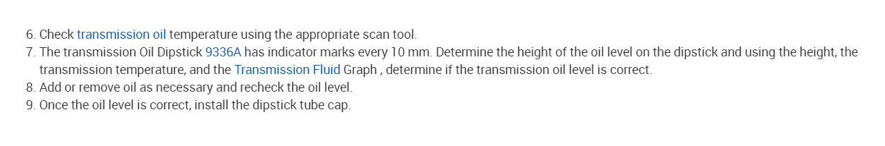

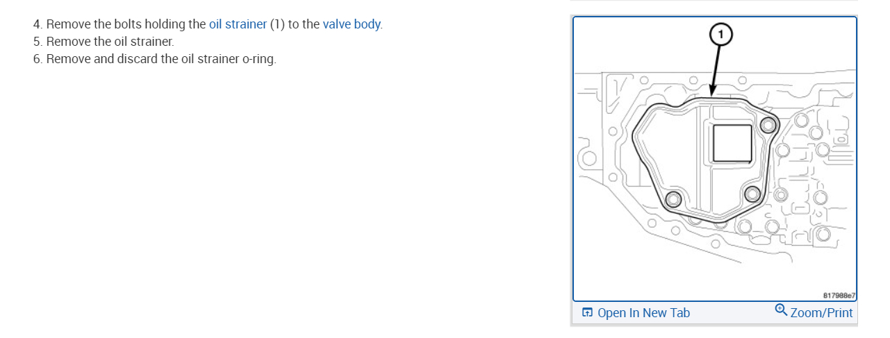

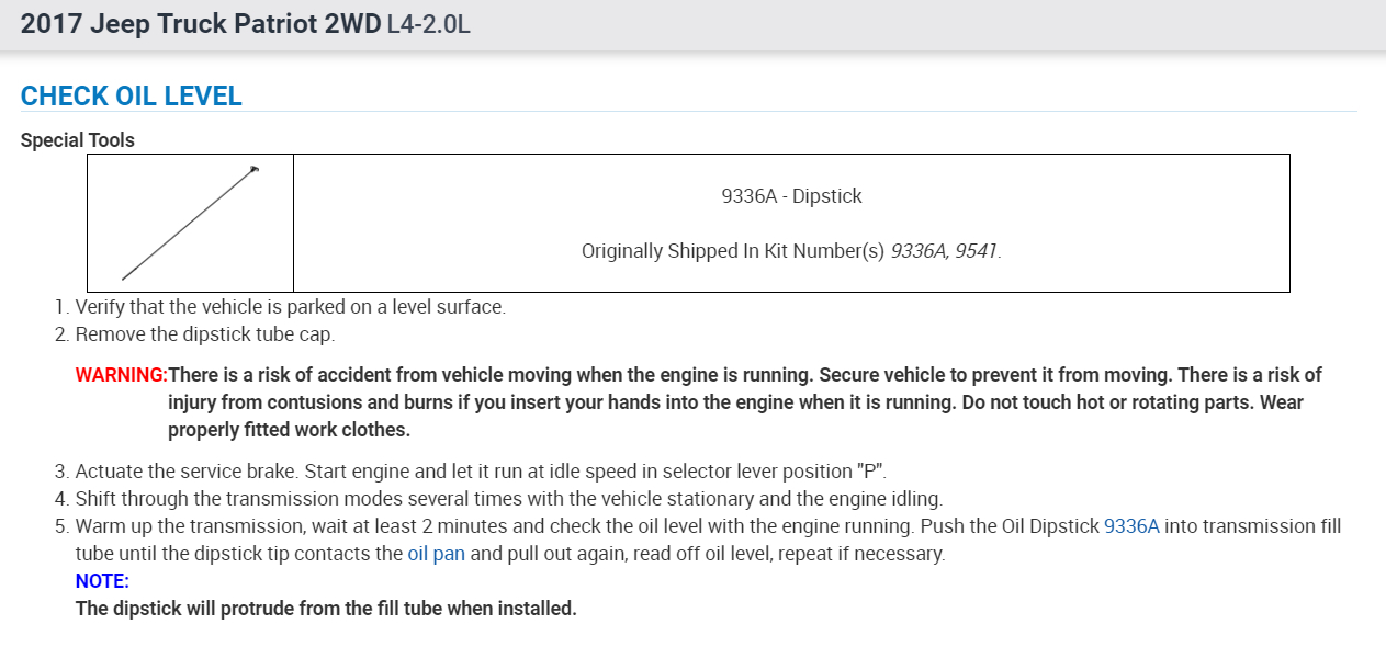

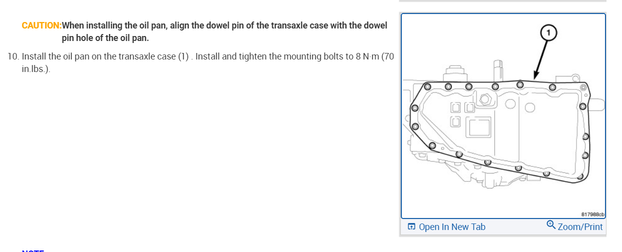

Yep, here are the instructions on how to do the transmission service and what type of fluid is used which is important.
All T355 Manual Transaxles require the use of ATF+4 (Automatic Transmission Fluid).
This guide will help walk you through the process, then check out the drain and fill port and filter change below.
Check out the images (below). Please let us know if you need anything else to get the service completed.
