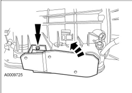

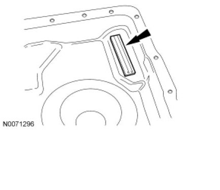

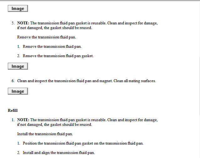

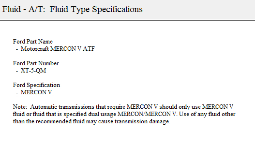

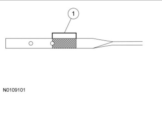

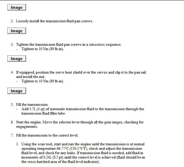

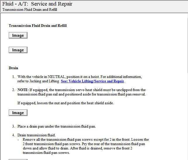

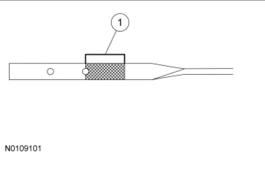

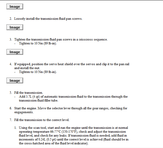

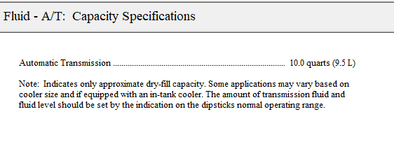

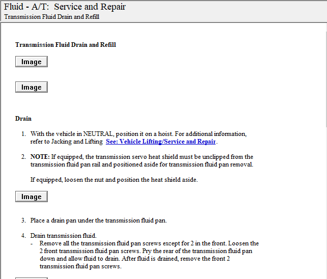

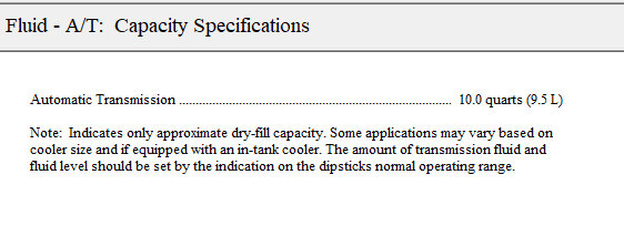

Check fig 1 for type of the fluid, fig 2,3,4. for complete procedure of transmission fluid replacement,fig 5. for fluid capacity,fig 6. heat shield,fig 7. fluid pan,fig 8. magnet inside the pan. fig 9 fluid level indicator.
