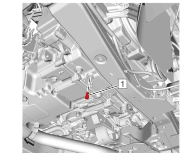

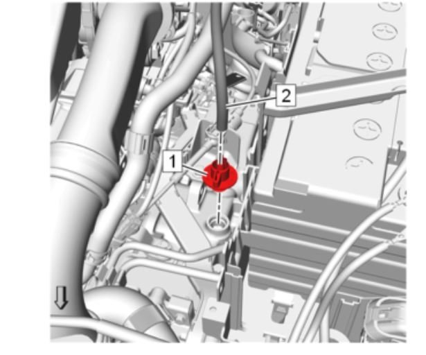

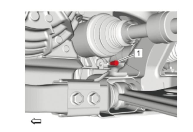

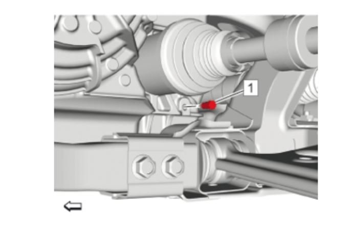

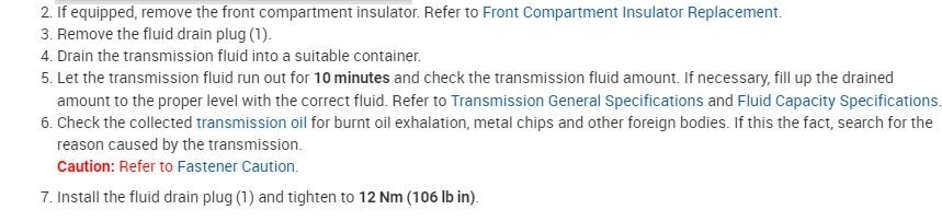

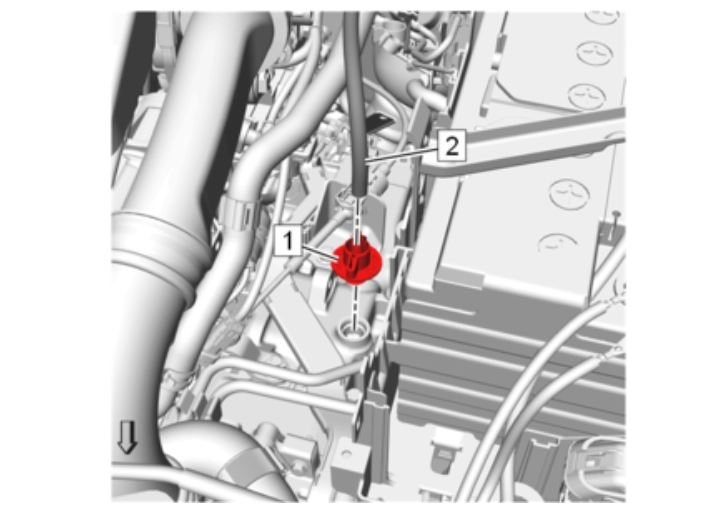

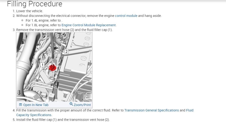

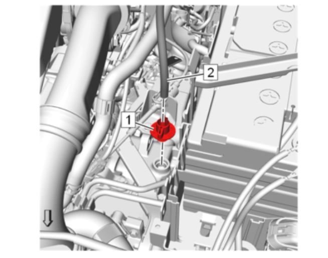

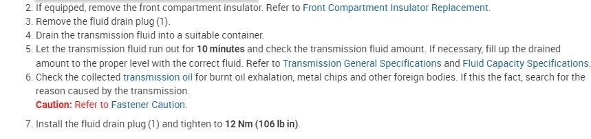

I attached the procedure below for changing the fluid and installing the new fluid.
Let me know if you have any other questions. It is a easy job but make sure you follow the filling instructions for the proper level on the plug at the side of the transmission.
You will need a long funnel with a thin end for filing.
