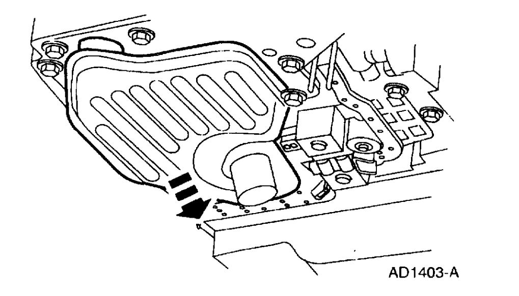

3. Place a drain pan under the transmission fluid pan.
4. Drain transmission fluid.

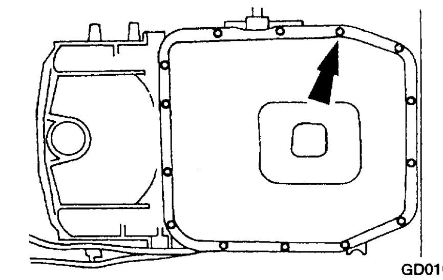

Loosen the transmission fluid pan bolts and allow fluid to drain. After fluid is drained remove the bolts.

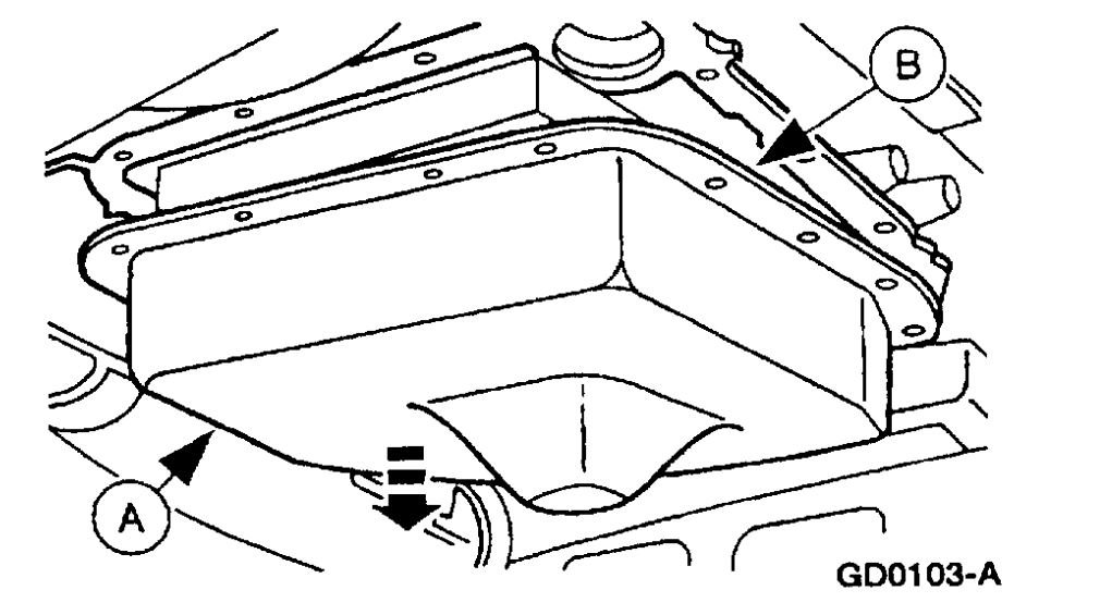

5. Remove the (A) transmission fluid pan and (B) transmission fluid pan gasket.
6. Pull down evenly and remove the transmission fluid filter, seal and filter kit.

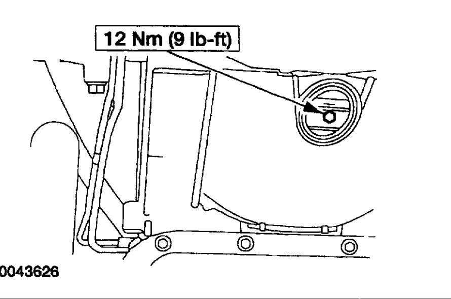

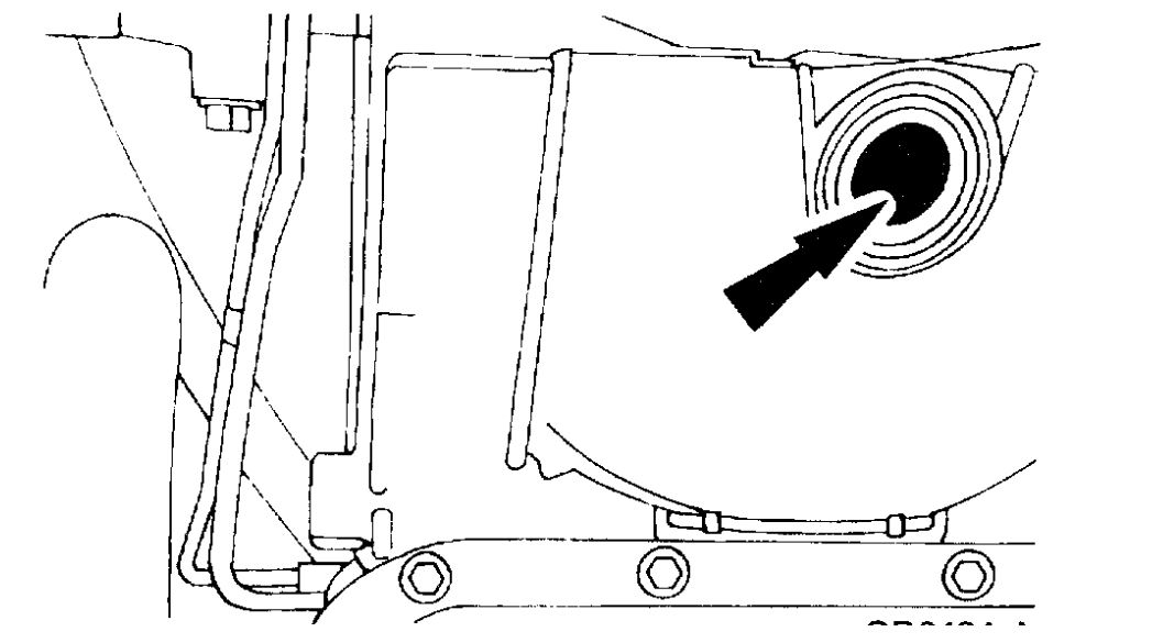

7. Remove torque converter housing plug.
8. Remove the torque converter drain plug and drain the torque converter.
Rotate the crankshaft to access the drain plug.

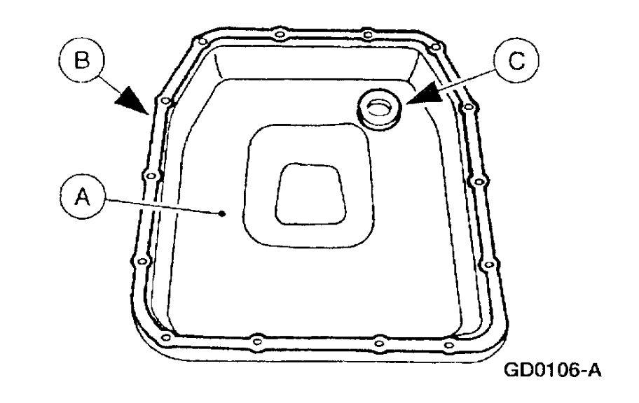

9. Clean and inspect the (A) transmission fluid pan, (B)transmission fluid pan gasket and (C) magnet.
