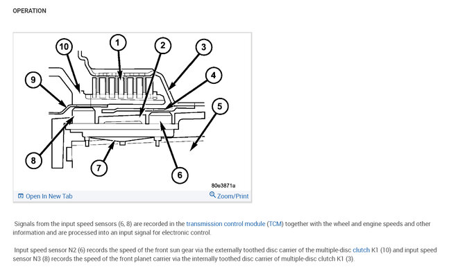

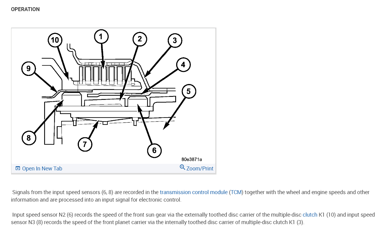

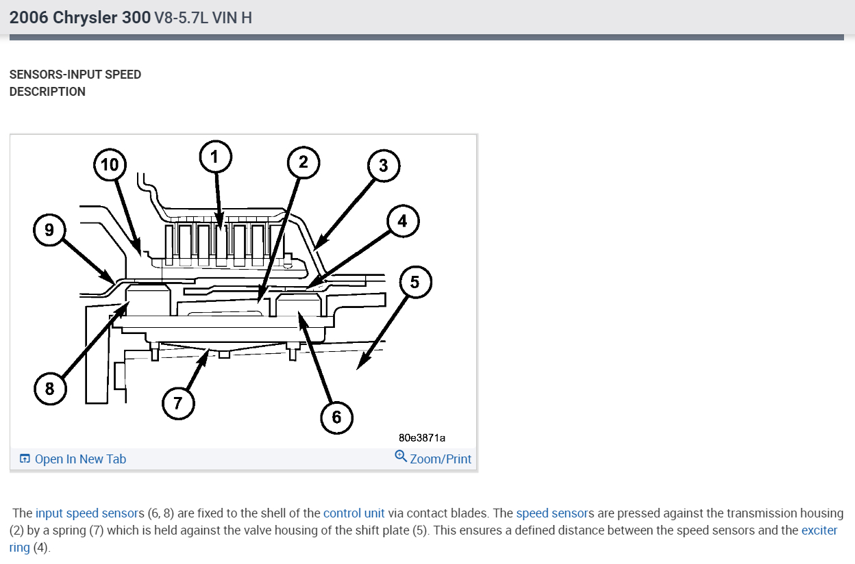

The input speed sensors (6, 8) are fixed to the shell of the control unit via contact blades. The speed sensors are pressed against the transmission housing (2) by a spring (7) which is held against the valve housing of the shift plate (5). This ensures a defined distance between the speed sensors and the exciter ring (4). Check out the images (below). Please let us know if you need anything else to get the problem fixed.
