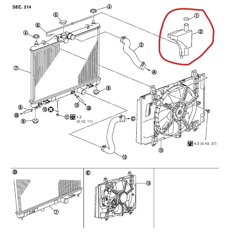

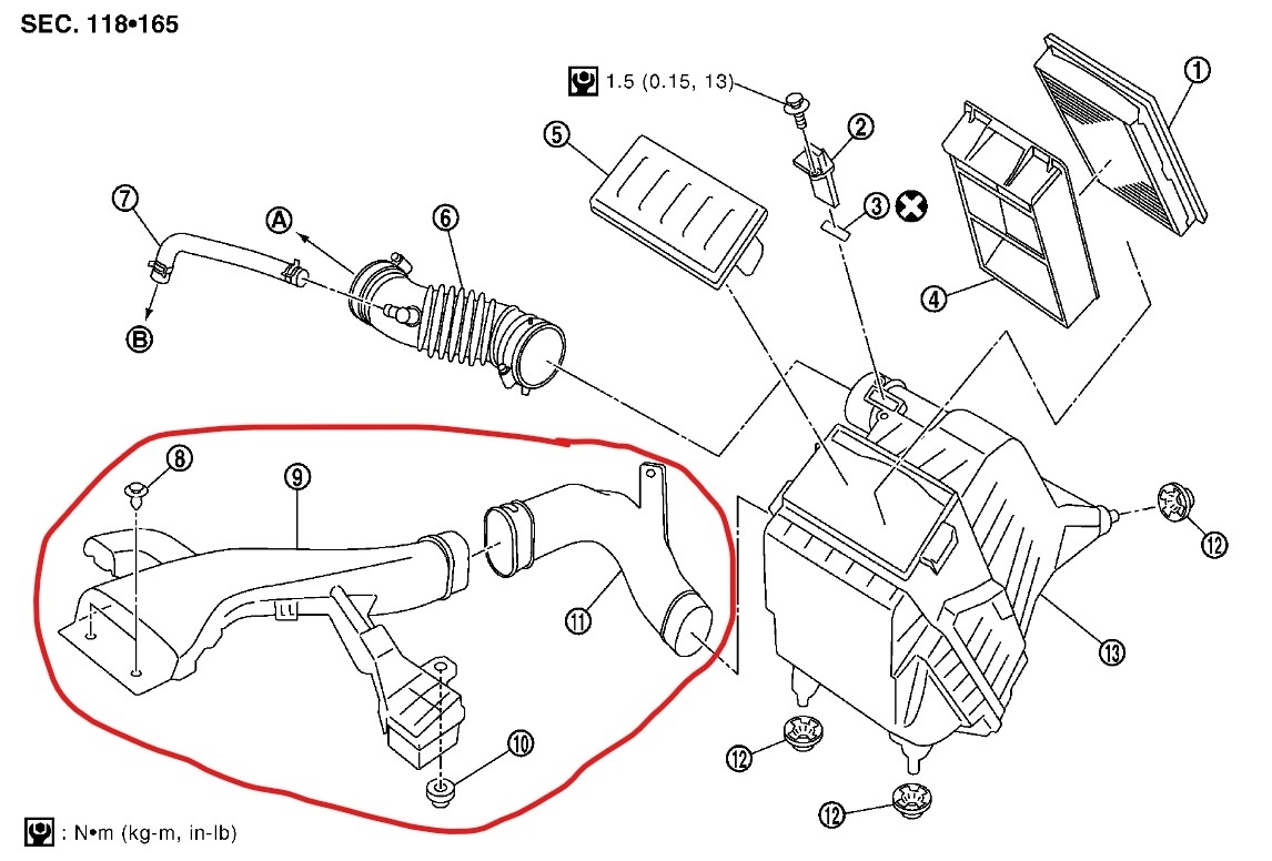

1. Remove the air duct (inlet) and air duct (between air cleaner case and electric throttle control actuator).
(Circled in image 1.)
2. Remove the reservoir tank. (No need to drain coolant or remove coolant lines)
(Circled in image 2)

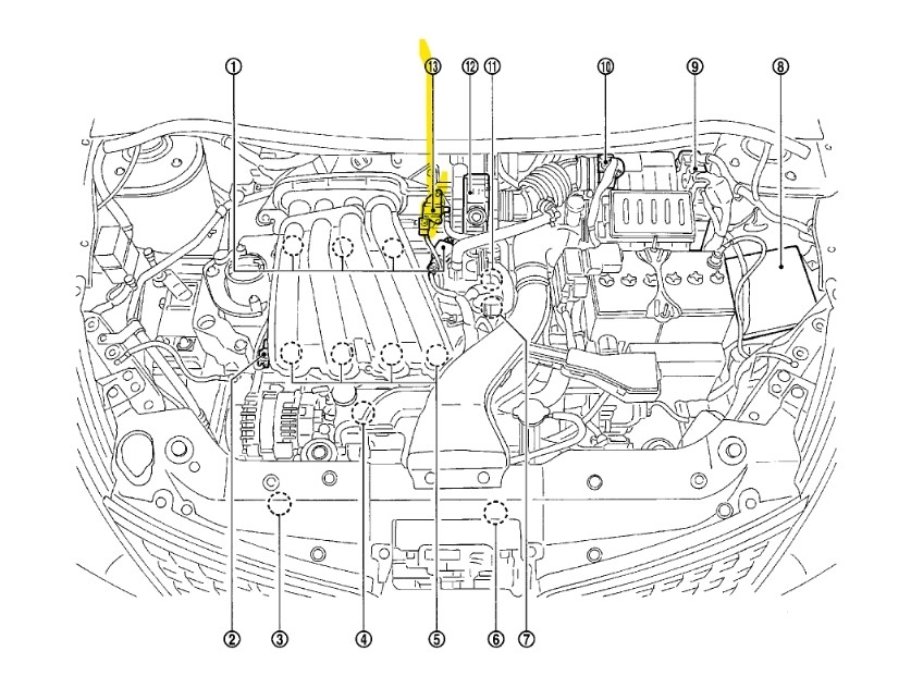

5. Disconnect the harness connector and EVAP hose from the EVAP canister purge volume control solenoid valve.
(Highlighted in image 3)

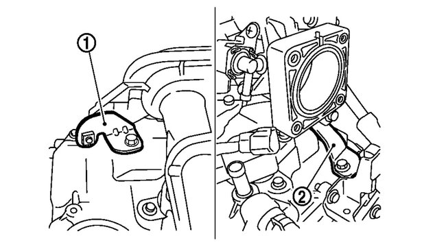

6. Disconnect vacuum hose for brake booster from intake manifold.
7. Remove intake manifold support front (1) and bolt from rear (2).
- Bracket (2) is not removed. Remove bolt from intake manifold.
(See image 4)

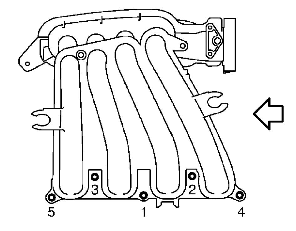

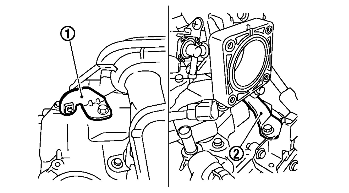

8. Remove intake manifold.
- Loosen bolts in the reverse of the order shown.
(Refer to image 5)

INSTALLATION
Installation is in the reverse order of removal.

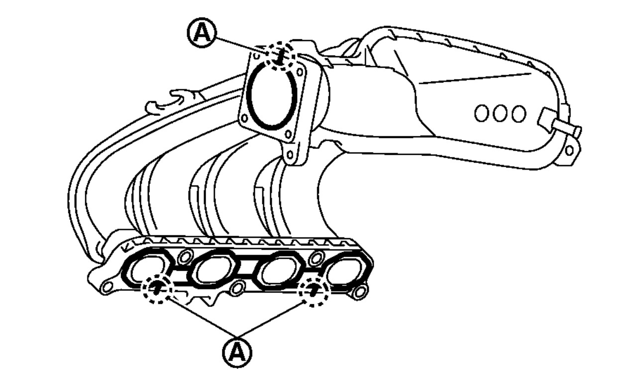

- Pay attention to the condition and orientation of the gasket, demonstrated in image 6. I recommend replacing with a new gasket for peace of mind and for a complete repair.
