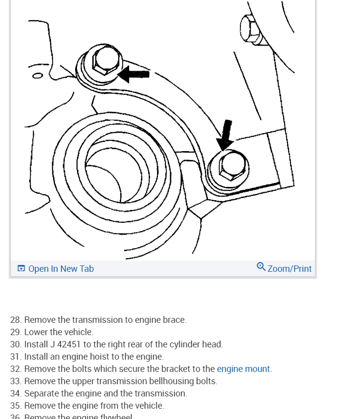

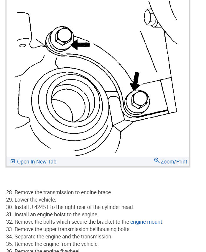

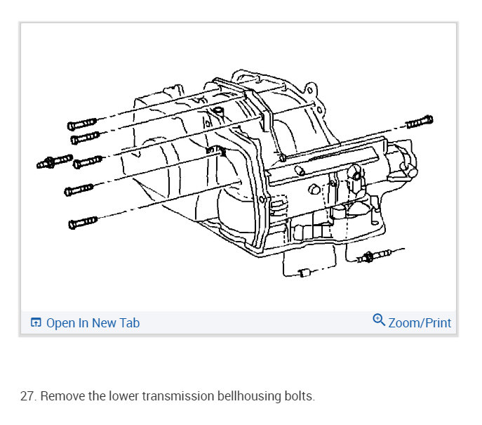

Do i have to remove the axles and where are all the bolts that connect the transmission and the engine. i am not taking transmission out and it is being removed from top.
