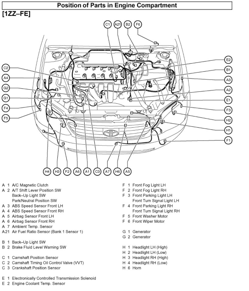

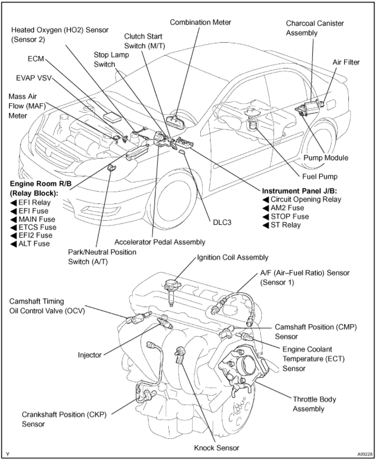

I need to know where is locate this part 90919-05007 Camshaft Position Sensor in my XRS Corolla 2005.
Jul 28, 2017 at 2:06 PM
The sensor is located near the top of the engine by the valve cover here is a guide and some diagrams (Below) that will show you how to get the job done.
