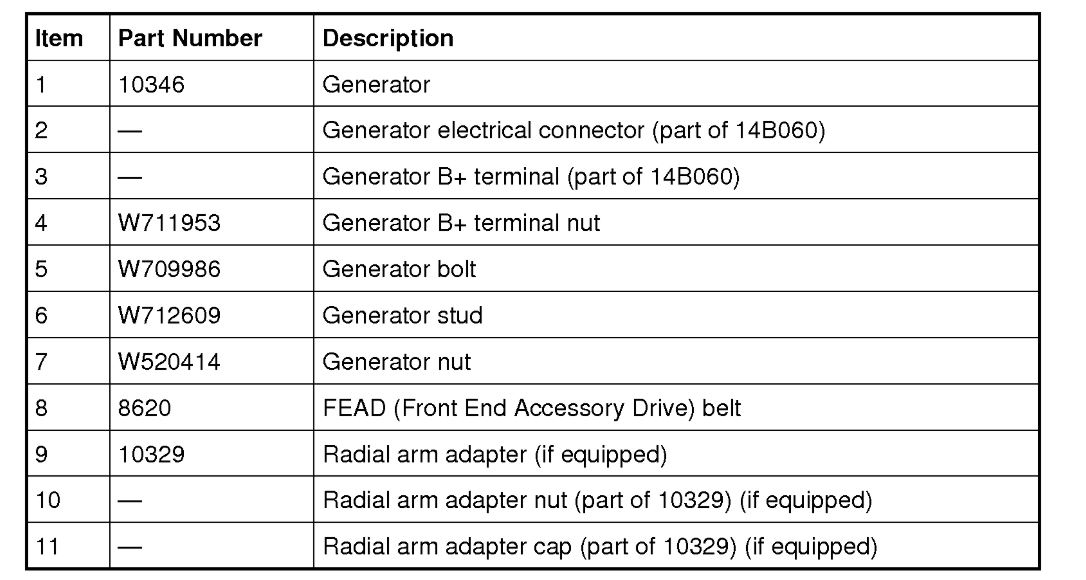

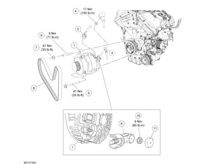

I attached the procedure for you for replacement as well as some pictures.
Removal
WARNING: Before beginning any service procedure, refer to Safety Warnings in General Information. Failure to follow this instruction may result in serious personal injury.
1. NOTE: If equipped, the radial arm adapter is a serviceable item. Do not replace the generator if the radial arm adapter is the only concern.
Disconnect the battery. REFER to Battery, Battery Disconnect .
2. Remove the cooling fan motor and shroud. REFER to Cooling System &/or Engine Block Heater, Cooling Fan Motor and Shroud - 3.5L Ti-VCT, 3.7L Ti-VCT .
3. Rotate the accessory drive belt tensioner clockwise and position the accessory drive belt aside.
4. Position the generator B+ terminal protective cover aside, remove the nut and position the generator B+ terminal aside.
1. To install, tighten to 17 Nm (150 lb-in).
5. Disconnect the generator electrical connector.
6. Remove the RH fender splash shield. REFER to Body and Frame, Fender Splash Shield .
7. Fully loosen the generator bolt.
1. To install, tighten to 47 Nm (35 lb-ft).
8. Remove the generator stud nut.
9. Remove the generator stud and the generator.
1. To install, tighten to 8 Nm (71 lb-in).
Installation
1. To install, reverse the removal procedure.
