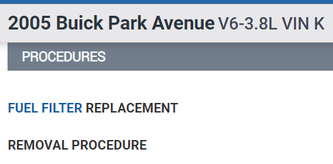

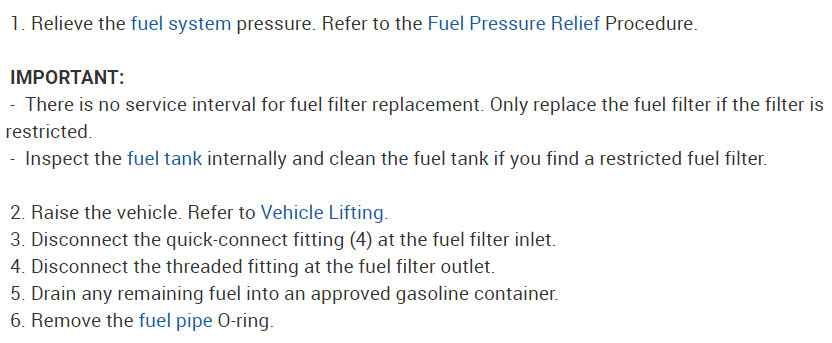

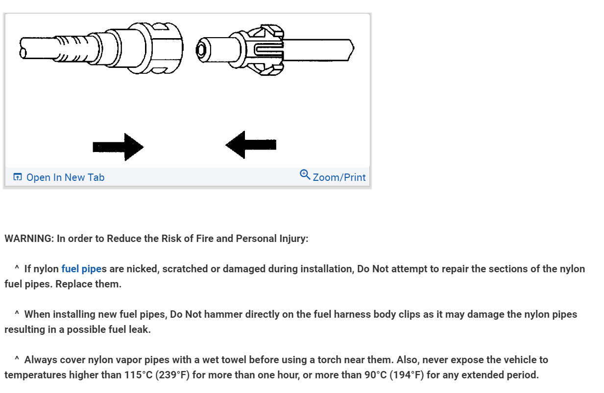

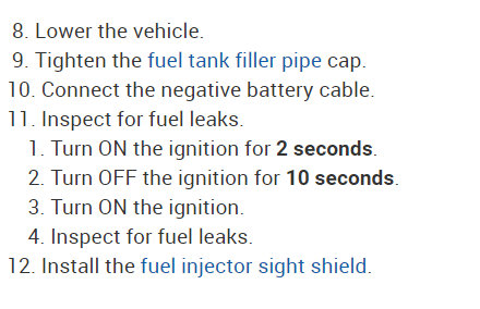

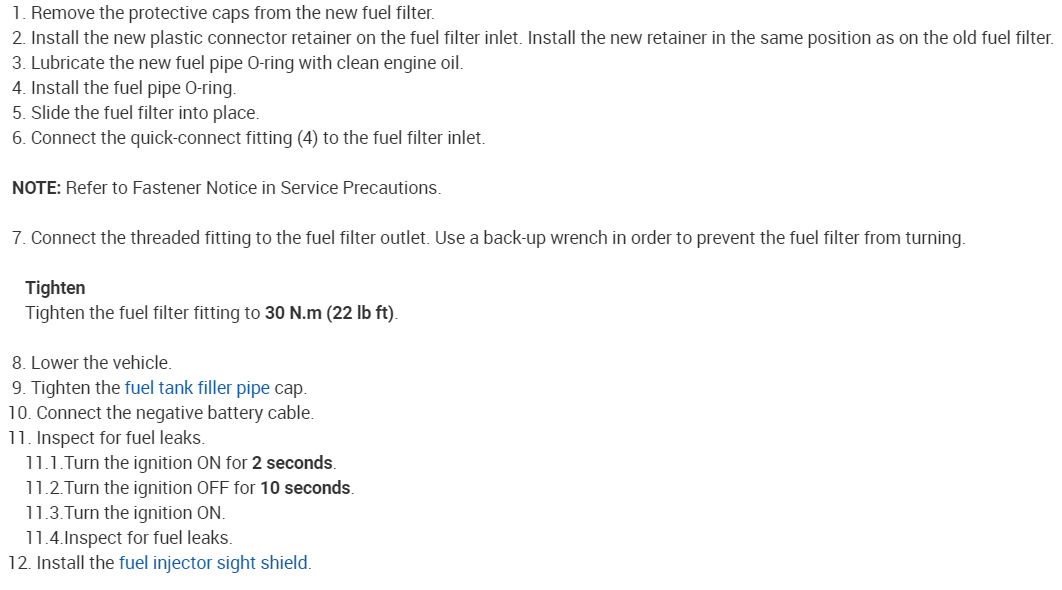

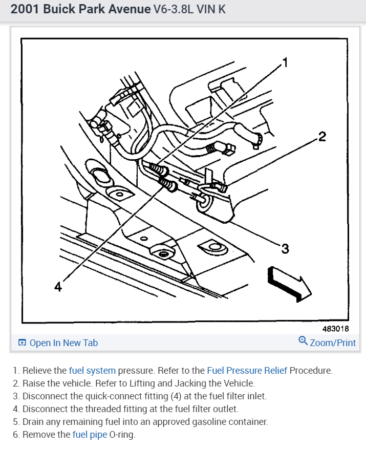

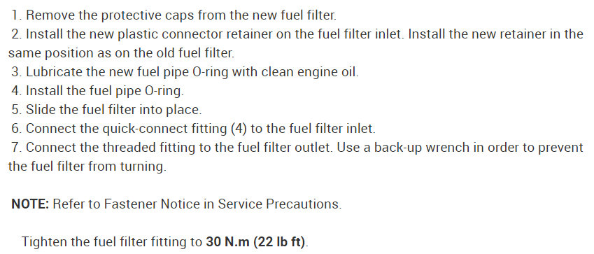

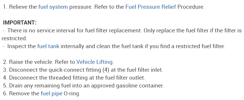

Here is a tutorial for you to view showing how to change a fuel filter:
https://www.2carpros.com/articles/how-to-change-a-fuel-filter
I've attached picture steps below on how to change the fuel filter on your vehicle. Hope this helps and thanks for using 2CarPros.

Here you go! Under the left rear of the vehicle. Here is a guide that can help as well:

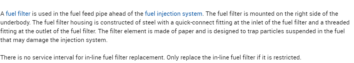

there is no certain specified interval for replacing your vehicle's fuel filter. only if you experience fuel system issues should you replace the fuel filter.

It is under the car near the fuel tank, drivers side here is a guide to help walk you through the service with the location of the fuel filter below.

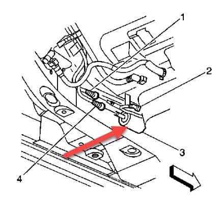

Where is the fuel filter located on a 1999 Buick Park Avenue Ultra? Im trying to find it so I can replace it with a new one
Dec 9, 2020 at 2:15 PM (Merged)
SATURNTECH9
  • 30,869 POSTS
https://www.2carpros.com/forum/automotive_pictures/416332_1999_buick_park_aveune_ultra_fuel_filter_location_1.jpg
The fuel filter is located along the LH frame rail. There you go.

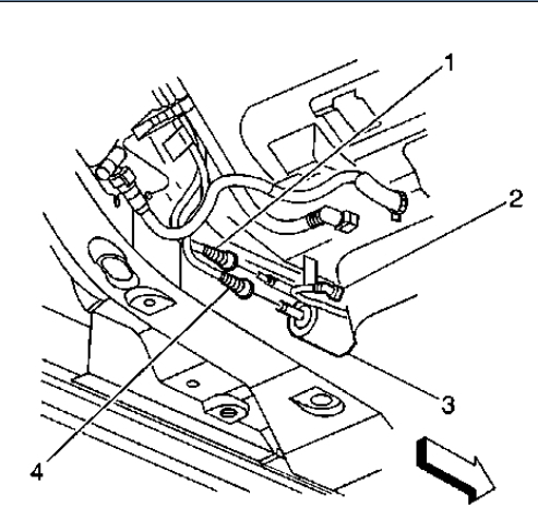

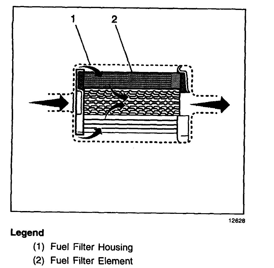

What size is the fitting that goes into the end of a standard (car listed above) fuel filter?
SCGRANTURISMO
  • 4,897 POSTS

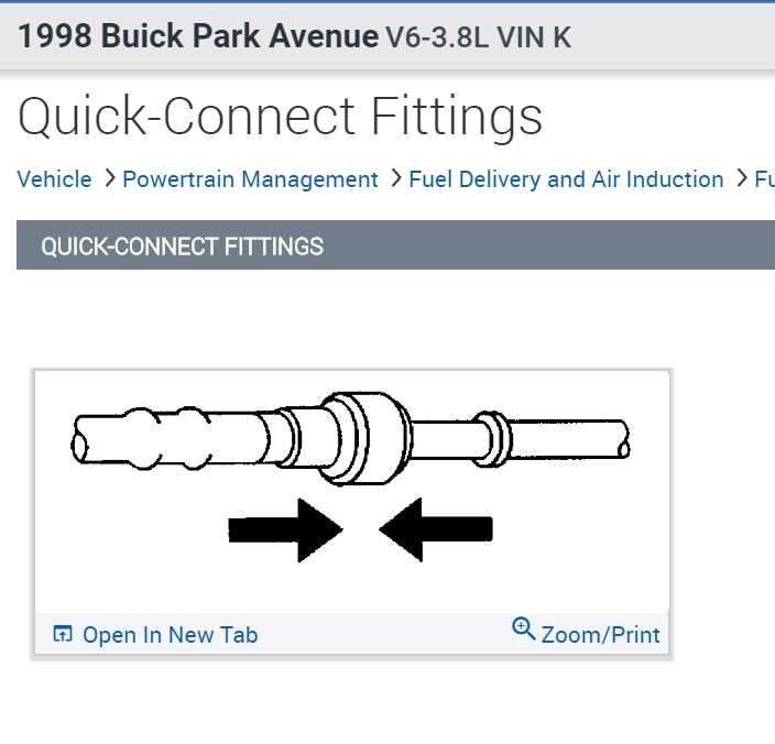

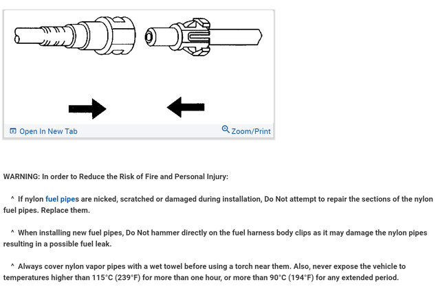

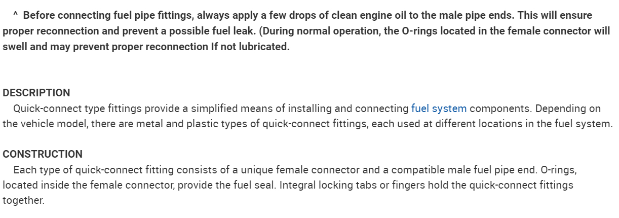

I have included all the information that I have on your vehicles fuel filter and fuel line quick connect couplers in the diagrams below. I hope this helps.
Thanks,
Alex
2CarPros
DCKELLEY
  • 125 POSTS
The other end. Would that take a 16mm fitting?
SCGRANTURISMO
  • 4,897 POSTS
Hello again,
Sorry about that. It is 16mm X 1.5.
Thanks,
Alex
2CarPros

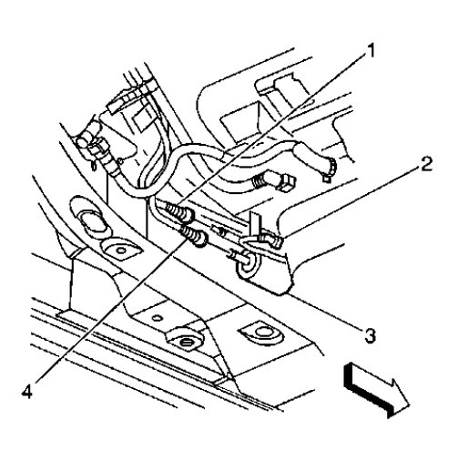

RASMATAZ
  • 75,992 POSTS
The fuel filter is located under the car on the drivers side rear almost under the rear seat here is a guide to help walk you through the steps and a diagrams to show you on your car. https://www.2carpros.com/articles/how-to-change-a-fuel-filter
