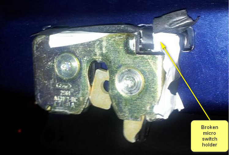

The boot lock mechanism is also prone to fail, see picture below of broken micro switch holder on boot lock.

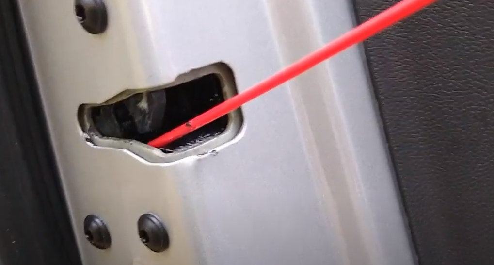

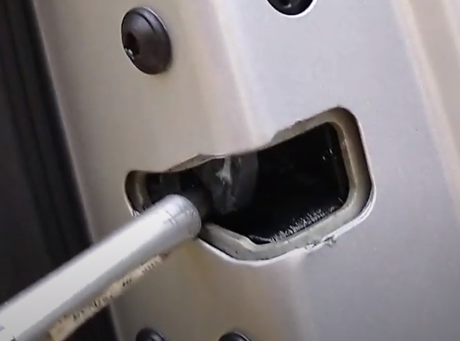

You could first try and lubricate the door locks. Do this by clicking the door locks into closed position, with door open, and then spray some WD40 or similar into the door lock to try and loosen off a sticky micro switch. See pictures below.
