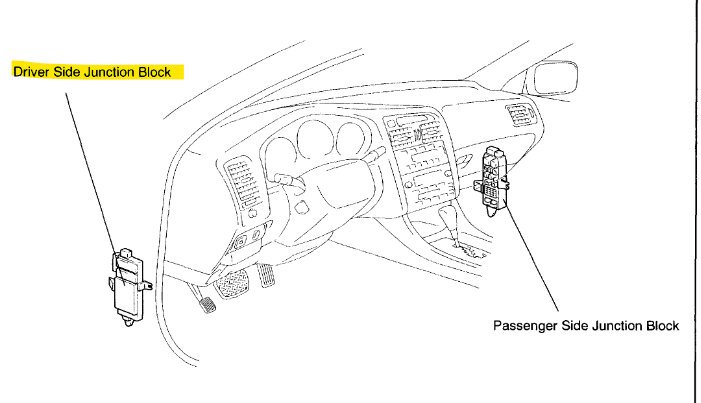

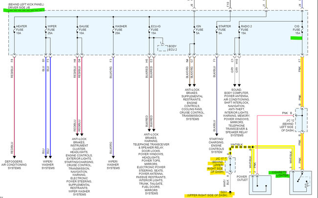

Hello, the fuse panel is located on the driver side down by where your left foot would be, it's behind the kick panel.
