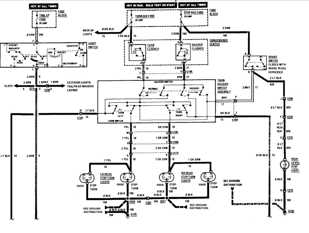

My center brake light does not work. There is power when the brake is pressed. I checked the socket offline and the bulb lights when power is applied. When I install a bulb into the socket the voltage goes to zero. The lower break lights work as they should.
