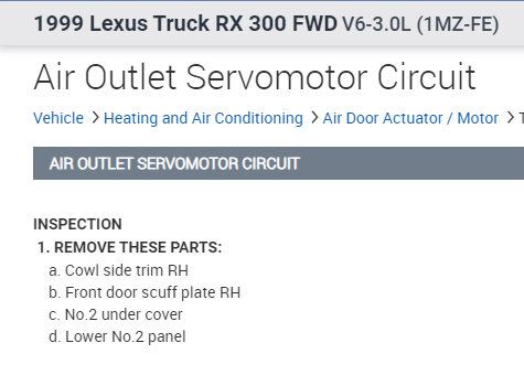

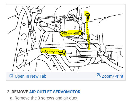

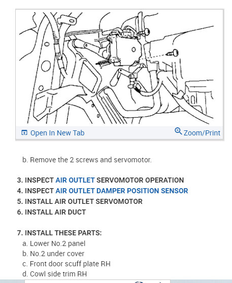

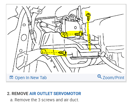

I don't believe not having the cabin air filter would cause this and no to the resister. The blower motor resistor is responsible for fan speed and not direction.
The item that is responsible for the airflow direction is called an air outlet servomotor. It is better known as a mode door actuator.
I attached directions below explaining how to test it and the circuit. Take a look through them and let me know if you are comfortable performing the tests. Also, when you have the servomotor removed, inspect the ductwork77
to make sure nothing is disconnected or damaged.
See pics below.
